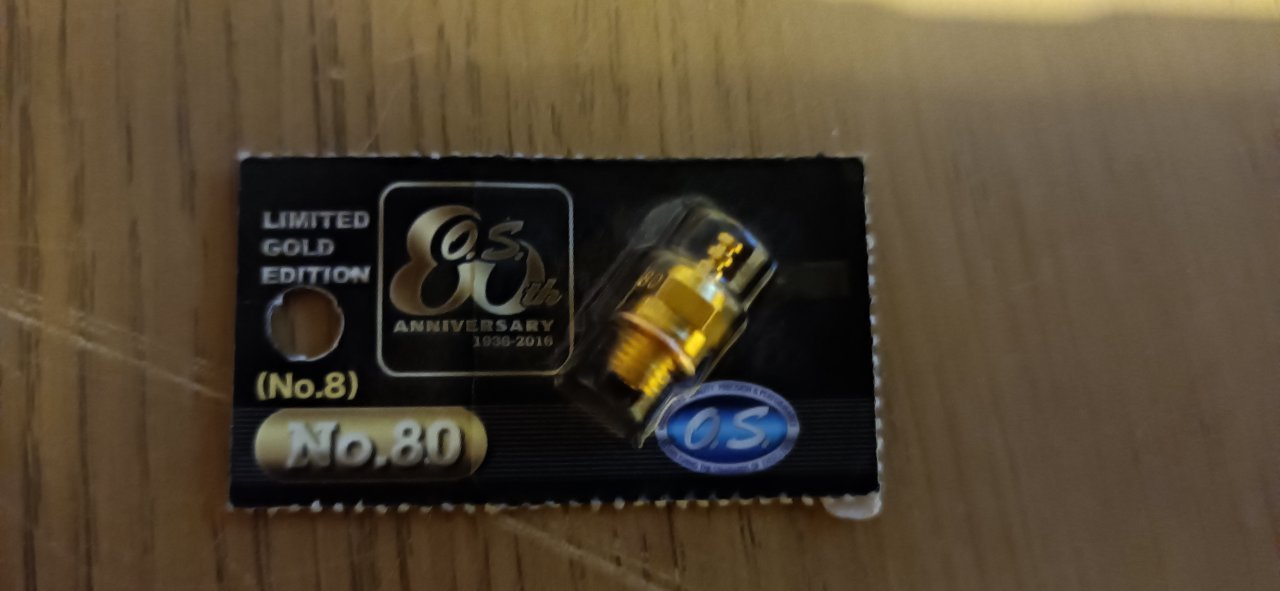

Was given a limited gold edition os no8 glow plug earlier and a fastrax rebuildable fuel filter which looks and fits much better than the cheap eBay one 🤠
Also gave both trucks a bit of a shower as both were boggin 🤦 gona let them dry out naturally as won't be usin either again till Wednesday if the weather's nice 🙂 anyway pic of the new fuel filter, and plug lol

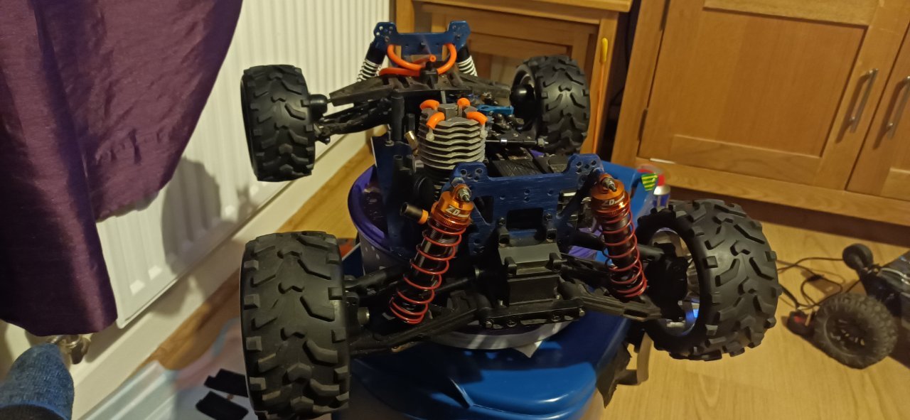

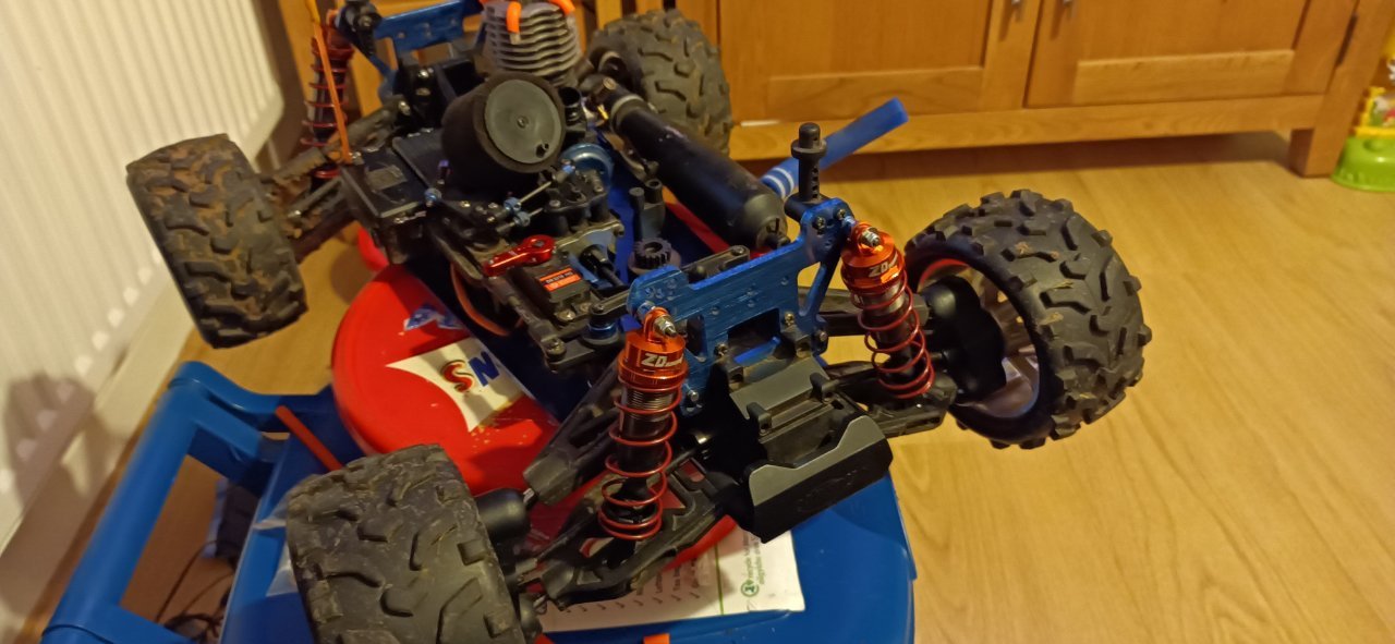

7k diff oil and the front ZD racing shocks arrived today 🙂 fitted the shocks so now it's all matching and took the ear plugs out the center diff, cleaned it up and put the 7k oil in 🤠 jus need to replace the fly wheel as that's what's causing the excessive wear on the shoes lol only time will tell if the center diff actually sends power to the rear wheels... If not I'm gona shoe glue it and lock it properly lol or order a new diff an see if that helps it. If all that fails then it's gona be an expensive shelf queen and never used again lol
Also the shocks are a few mm longer than the old ones and alot stiffer so hopefully no more bottoming out when I'm racing around the park lol
New fly wheel kit and fly wheel puller turned up today 🤠 jus waitin on the piston locker now so I can fit it all without damaging anything else lol front shocks look really good on it and now I can do the Kevin Talbot drop test an not bottom out lol not sure whether to fiber glass the shell or the shoe glue an dry wall tape

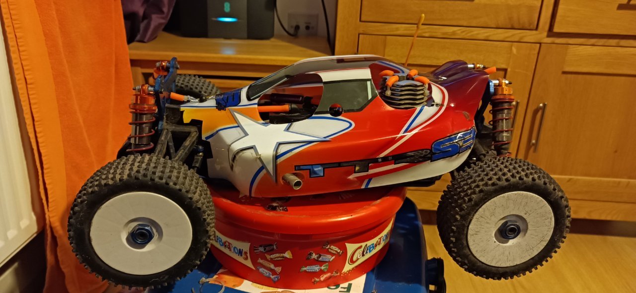

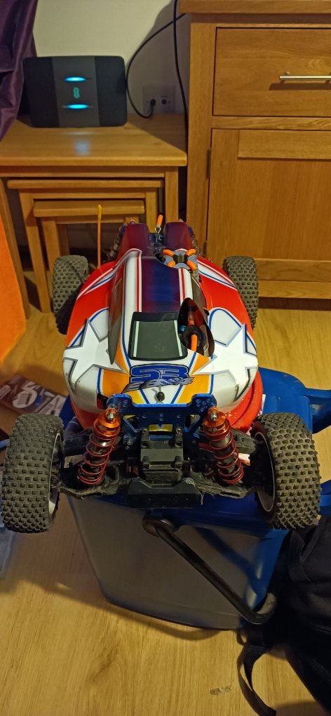

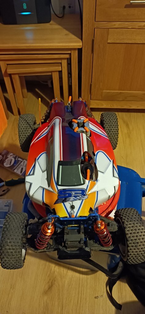

Got given a ttr eb4 S3 body earlier, needs a bit of trimmin but will fit an look amazing, was also given a eb4 exhaust and air filter and Jesus its transformed the thing, was gona gear it down but don't need to now with the new bits 🙂 goes much quicker than a savage X with a big red lol will post pics later once IV fitted the new shell

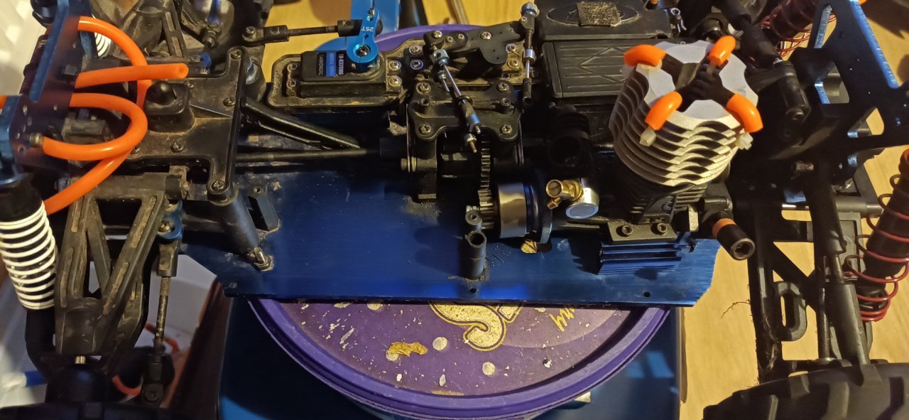

Well really happy with how the Carson is looking 🙂 jus need the wing mount now an it will be a specter/ eb4/ losi 8ight 2.0-4.0 Frankenstein lol
It's got losi air filter and pipe.
Eb4 exhaust and shell and soon to be wing.
Kyosho wheels and proline street fighter tires.
120mm ZD racing front shocks.
140mm ZD racing rear shocks.
RW racing 17t clutch bell meant for a hpi savage with aluminium clutch shoes.
7k center diff oil.
Standard oil in front and 3k in rear.
Fastrax roto start.
eBay specials 20kg steering servo.
Running ftx carnage receiver and transmitter.

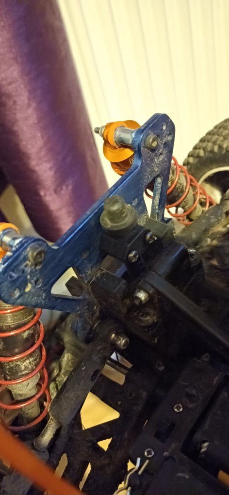

 Next on the list is specter wing mount, carbon hd brake pads, lower toothed center diff spur gear (brother in law's got a 42t I got my eye on lol) 5.9 force engine, proline trenchers to fit my standard Mt wheels and another set of suspension mounts as these ain't gona last long as IV already rolled it today lol but for now it's lookin epic
