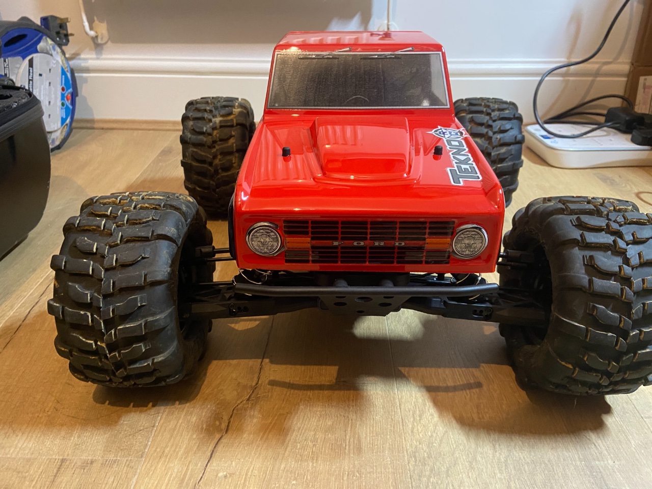

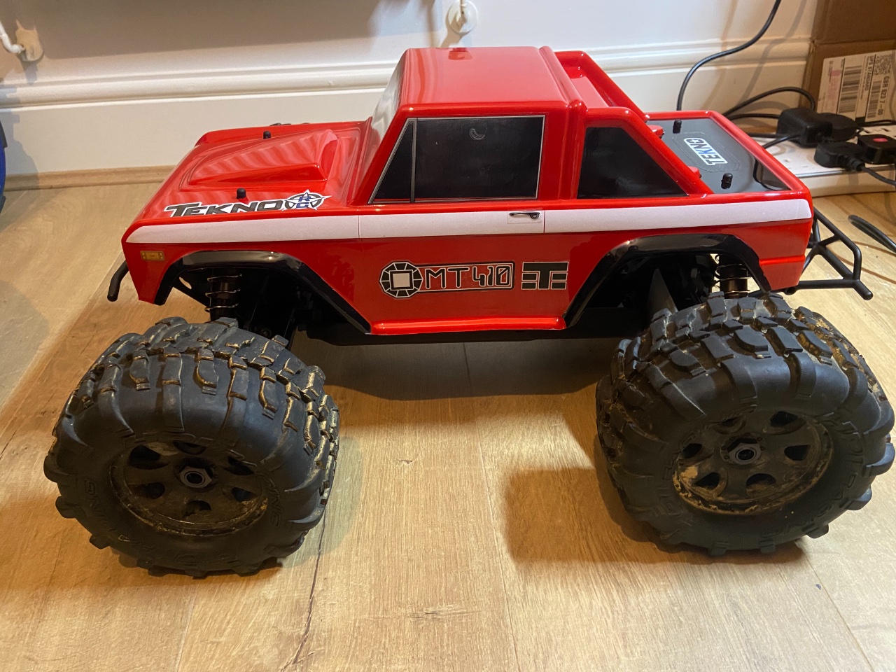

Popular Post collective itch Posted January 30, 2021 Popular Post Share Posted January 30, 2021 Just finished up my tekno. Little nod to the savage. 9 Quote Link to comment Share on other sites More sharing options...
Bajadre Posted January 30, 2021 Share Posted January 30, 2021 looking great dude digging that shell looks awesome !! 👍 1 Quote Link to comment Share on other sites More sharing options...

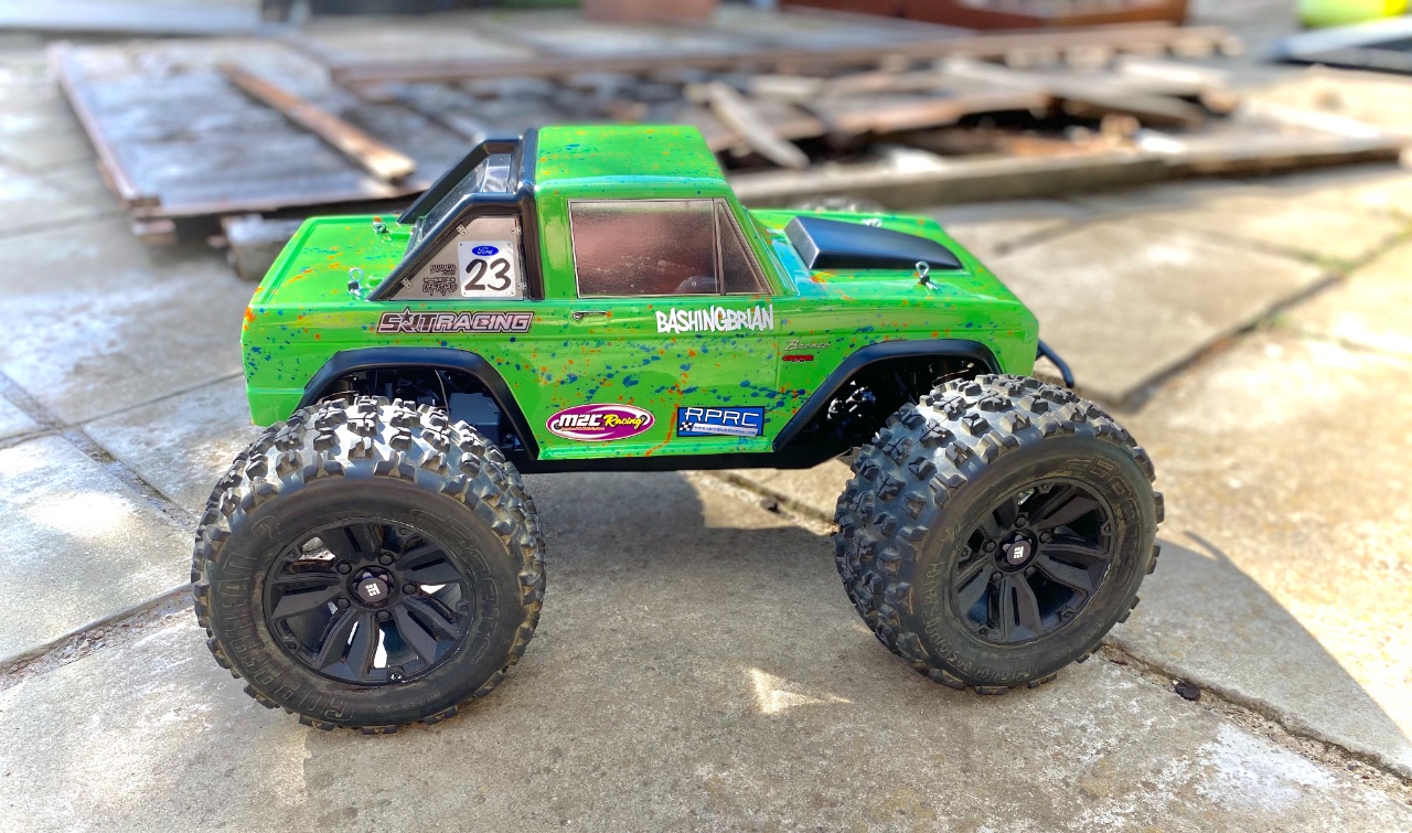

BashingBrian Posted January 30, 2021 Share Posted January 30, 2021 Nice body... Looks familiar 🤔😉 1 Quote Link to comment Share on other sites More sharing options...
collective itch Posted January 30, 2021 Author Share Posted January 30, 2021 43 minutes ago, BashingBrian said: Nice body... Looks familiar 🤔😉 Pretty sure I went with it as I saw yours!! 1 Quote Link to comment Share on other sites More sharing options...
BashingBrian Posted January 30, 2021 Share Posted January 30, 2021 The body really suits the MT410, I just wish it was a bit stronger.. I may buy another one and shoe goo / drywall tape it..!! 🤔 Quote Link to comment Share on other sites More sharing options...
stimpy Posted February 23, 2021 Share Posted February 23, 2021 Looking good that! I do love an MT410. Went through a few bodies on mine and now run the nuclear waste Russian options when bashing and an old C10 body when on the shelf 👍 1 Quote Link to comment Share on other sites More sharing options...
