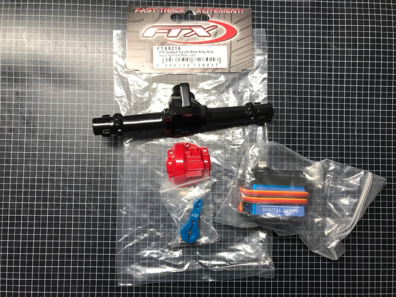

Bought another alloy axle for the Texan
I didn’t realise when I fitted the rear that the diff ring gear sits to the left whereas the stock plastic axle has it on the right.
Soooo the front the front and rear wheels are spinning in opposite directions 🤣
These axles don’t work with the Texan or at least  they won’t if you want to fit a pair .

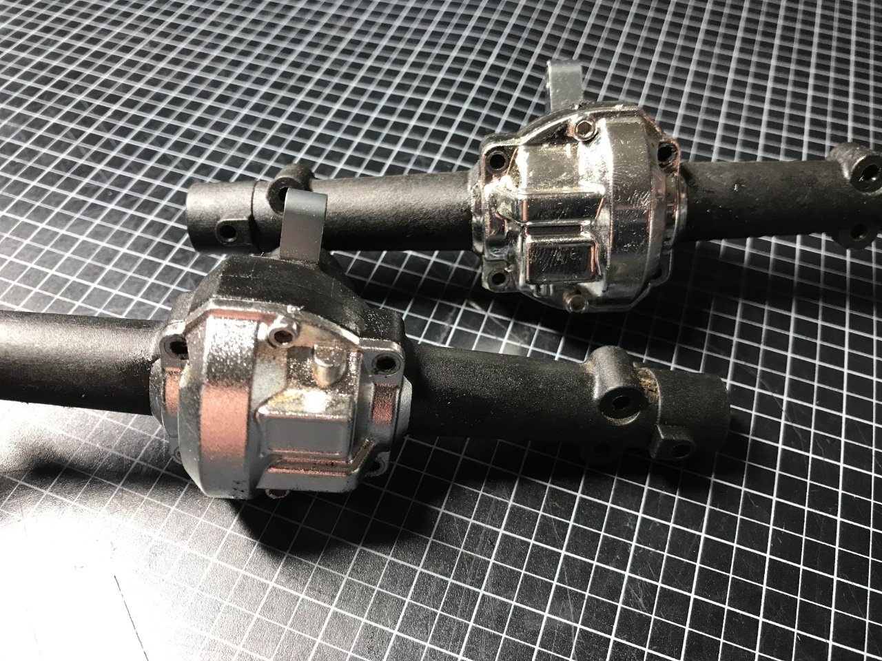

Here’s the stock plastic axles I’ve took off , the alloy piece that the upper links mount too can be fitted to the other side of the axle .

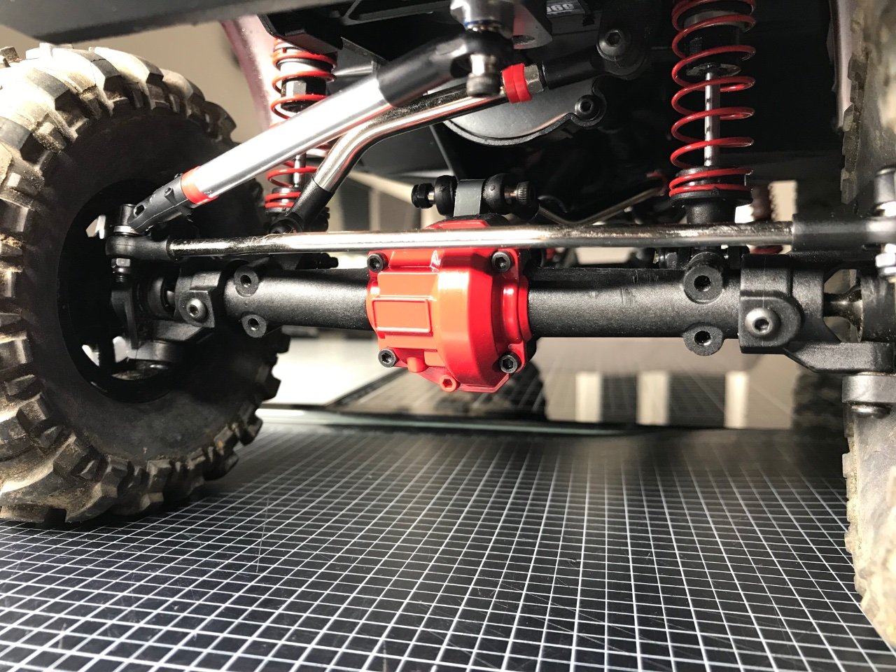

Ill switch the alloy bit around on the stock front axle, re-fit it with  the red alloy diff cover and it’ll be almost as good  😁

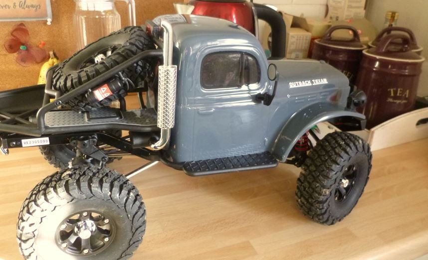

21 minutes ago, Jack Reacher said:
Main "Jurassic park" stickers removed, i think it looks better just for doing this but still want to give it some Patina treatment
Yeah that’s better mate 👍🏻
Take that chassis sticker off as well
