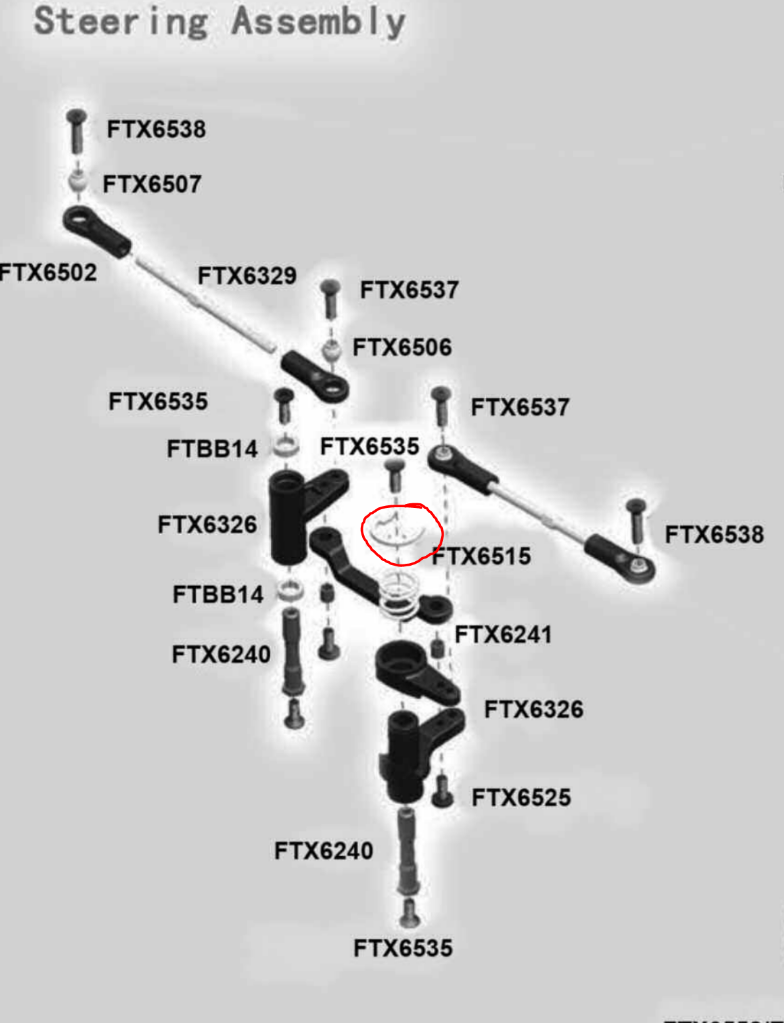

So there's a couple of things to try and tackle. The most annoying is the wheel nuts coming undone and falling off. I've not superglued all the hexes and pins so I'm not losing those, but wheels falling off every 5 minutes is infuriating. There just isn't enough thread to get a standard M4 nyloc nut on with a washer behind it. Any recommendations?
Second problem is the rear CVs. I presume a Kanyon shaft will fit this. Is there an upgraded unit at all? I don't like how easy that one snapped as I wasn't even giving it any stick really.
I also need to do something with the front servo. It works where it is, but the front steering has already been pretty rubbish. I'm not sure if that's how much slack there is in the 'servo saver' thing? Are these normally tight? Is it really required?

I bought the car second hand so I think I'm on a different Tx. It's still only 2 channel though. Since I bought the car the front steering has been pants, even with the servo in the correct position. I've just been looking at a new servo saver and I think the top might of snapped off of mine - there's no C-clip to hold the spring on mine, it is just kept on by the top chassis plate. I think this won't be helping.
So for slack steering the E clips always pop off the rubbish servo saver making it really weak, i glued my servo saver after giving up on loosing eclips and havent had a servo fail.
This is the eclip im on about and it looks to be missing here. You can also try a servo saver arm but i found this was also to weak to move my large tires.
