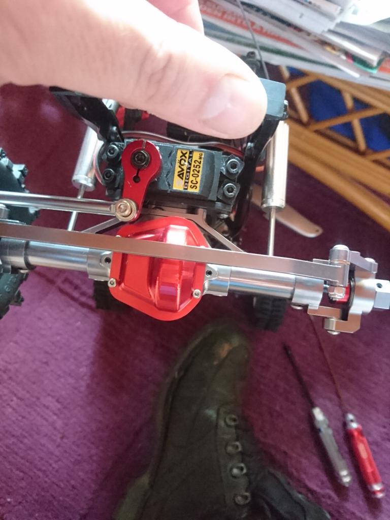

I was trying to caliberate my esc on my crawler and it went bezerk,  it drove the qheels and they caught in my jeans and with the shear torque it snapped thw inner drive shaft on the front.
They are the Chinese axlea off fleebay and i can't find spares. Are these a copy if any others? These are brand new axles so i need a spare inner.

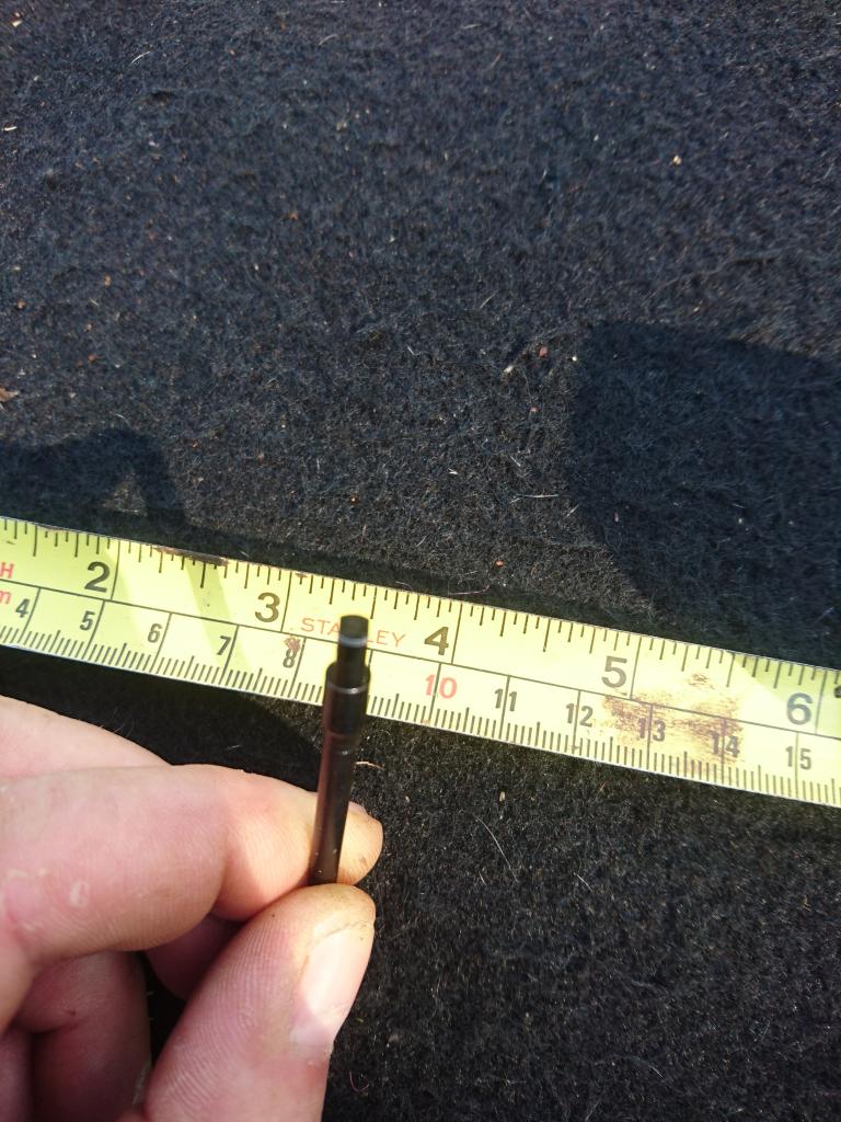

The best thing to do would be to remove the shaft and measure it. Easy to remove the shaft once you have the wheel off.
More than likely you'll find a same size shaft, (might want something with a brand name) and then check your slipper clutch as you'd really want that slipping before you break a drive shaft!

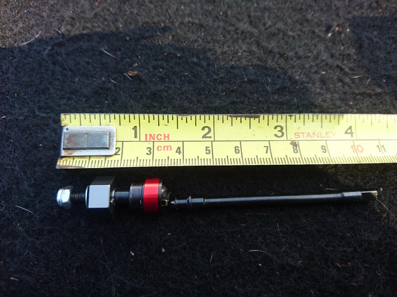

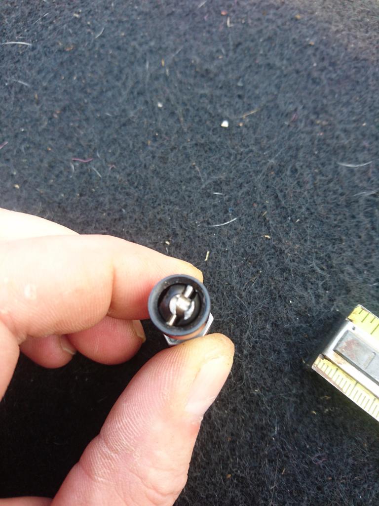

Looks like 110mm. There is also a pin to release the cvd but how the hell do you get the red ring (oo-err) off?
For being a crawler and taking some abuse the drive shaft is pi$$ poor in the way of strength. This bust on my trousers assaid I previous post.

Just found it. Its an Axial SCX10 inner axle.
