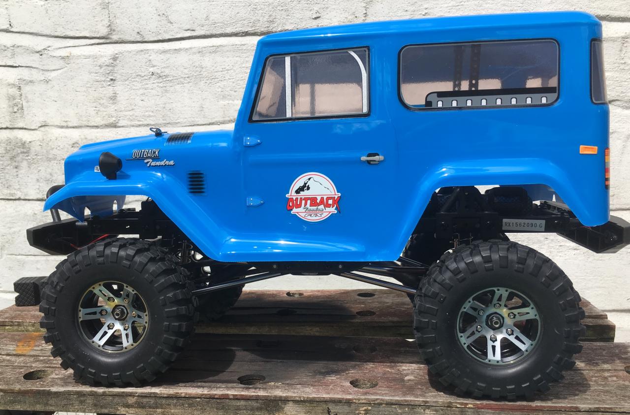

Anyhow, despite all that it's turns out that the wheels I've fitted have a wider offset than the stock rims. 6mm according to my calipers. So it's gained a 12mm track now and no need for the wider extension pieces!
For the wider pieces to be fitted I'll have to have a good hunt for the tap n die set, will extend the thread further down the stub axle.

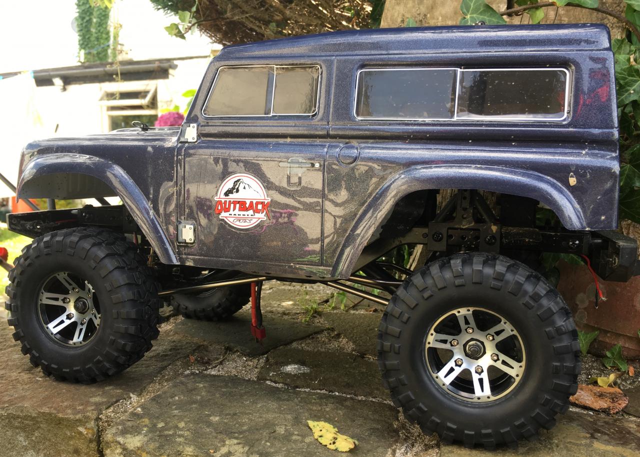

I've done the usual free mods, same as what I did to my Ranger when I bought that. Body posts raised by two holes, bumpers moved further out by one hole, and 3mm cut off each shock tube to help it give better articulation.

As for the wheels I've fitted the stock FTX tyres to both Tundra and my Ranger, simply removed the foam inserts. Look better going over obstacles now and seems to give better grip.

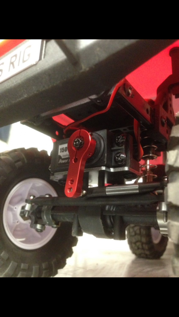

Hello guys, I had a similar problem with my steering to the extent it would be locked on full left (or right, can't remember now) until driven forward slightly, which was quite annoying, solved mine with an aluminium servo horn (plastic horn had huge amount of flex) and high tensile bolts on the steering linkage. Although I am running the powe HD 1501mg servo. IMG_6044.thumb.PNG.40aca34931508b9a9859e863235406ca.PNG
Since this picture I have moved the steering connection to the higher hole on the servo horn.

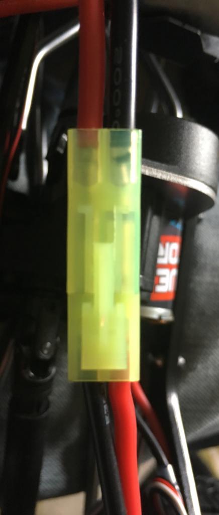

Had my sons Tundra out on the carpet this morning to see if anythihg can be done with the slow servo... so I ordered a short lead with a Deans male connection for the lipo and the small tamiya style female plug on the other. Upon plugging it in the wire in the small Tamiya on the esc plug went poof  :ack:   So feeling a bit peeved off thinking the esc might've gone as well it turns out that the lead I've bought is wired the wrong way (cue angry expletives!! And an email to the electrical seller)
just wired things in manually and thankfully the esc is not blown. Phew! I've rang Wheelspin and they've asked for the car to be sent back to solve the servo issue. Tempted to ring em again and say not to worry (extra hassle and sons birthday is imminent) and fit a waterproof servo I have here..

Whoa! That was lucky it didn't do any serious damage!! Especially using a lipo!
Tell me about it...! I didn't even notice the wire colouration until after I'd plugged it in. How often do we check the colours of wires when connecting the battery to an esc in their one-way plugs?! I know I'll be doing that from now on :rolleyes:  Just glad the esc combo still works, the positive wire in the esc plug took the brunt of it. Sorted that out earlier.
I've sent a message to the seller explaining things, he's no doubt got a whole stock full of them. And doesn't realise they're useless..
I wonder if the seller will actually warn buyers, we get so used to relying on the one way plug, I hope he does :unsure:

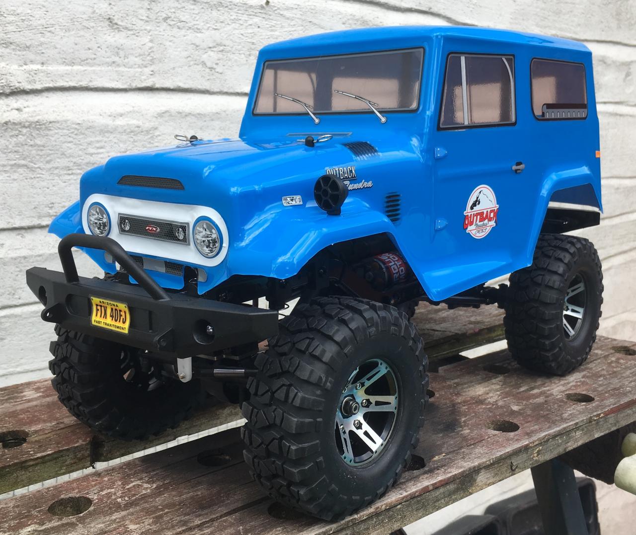

Just tried to drop a Trekka body onto my trucks - Ranger and Tundra, I thought all the chassises are the same, so all the bodies will fit straight on ! what an idiot :rain: even hacking the Trekka body - it will not work, back wheels catch, lighting wires would rub, short off making it into a type of monster truck it's a no no, I even bought white wheels :crying: so until I can work out a work round I have a bit cut up Trekka body. It seems you just can't take anything for granted, - just like your connectors, O well I pass this on in case anyone else falls into the same trap
:wheelchair:
No, it is the bottom edge of the bodies that need cutting so they don't catch but with the Trekka body it can't be done - it fits the body posts, but if you cut front and back to miss the bumper stalks, the corners catch, I'm going to try moving the bumpers 1 more hole forward, but it looks as though the body will rub on the lights wires
Fred
I've cut 1/2 inch off rear of back wheel arch of Trekka body and about the same front and rear of body straight across -
it looks Okay but will try it out tonight if rain goes off and see how it works and let you know

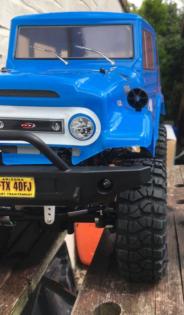

Im surprised there's so much difference, who'd have thought eh! I haven't tried offering my sons Tundra up to my Ranger yet, I'm interested to see the difference though. I did notice that the body posts on the Tundra were set in exactly the same holes as my Ranger was. But after I'd snipped the shock tubing last year when I bought it the tyres would then catch the arches of the body. So up went the body by two holes and out went the bumpers by one hole each.
Spot on now!
