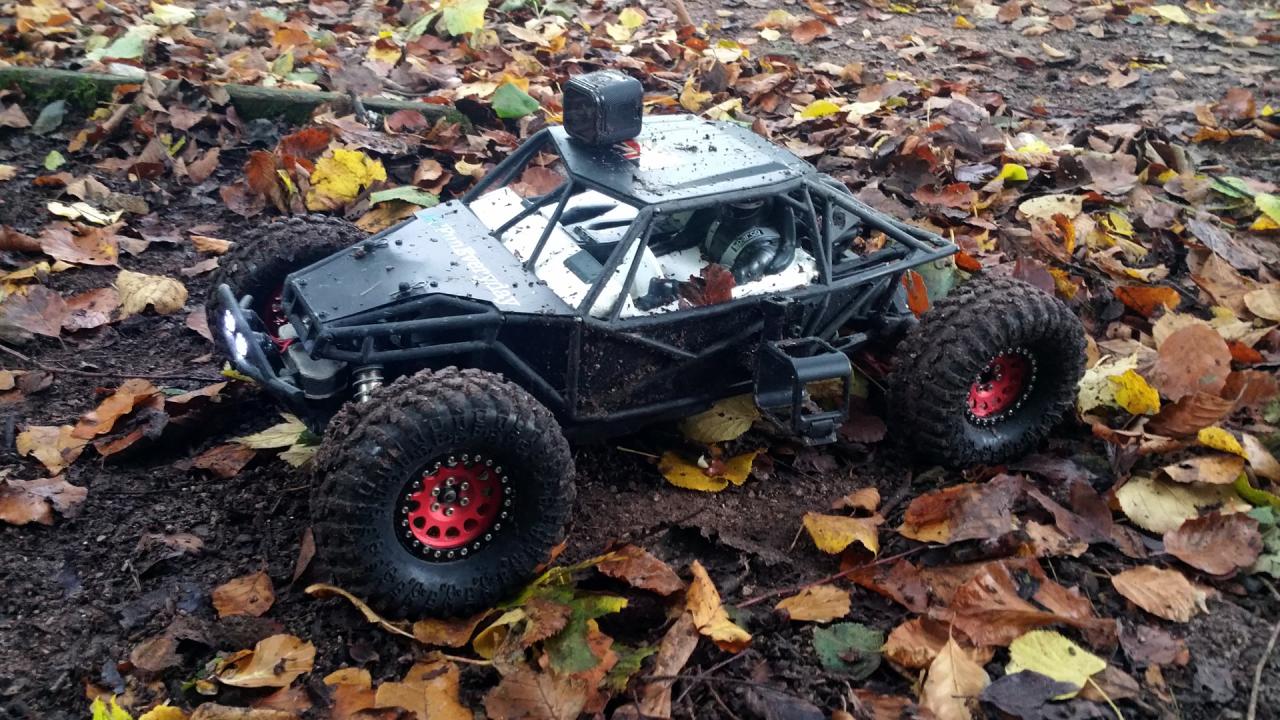

Took it out today... I broke another titanium link, starting to think they're monkey metal really :lol: and the rear driveshaft.
Put the Hero Session to another dirt, mud and water test mounting to the cage too, it survived, the truck did take some very hard hit though, including a flat out run into a wall, mid-flight and yes it is on film lol, video still to come... :D
