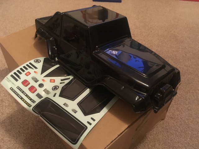

New shell just arrived:

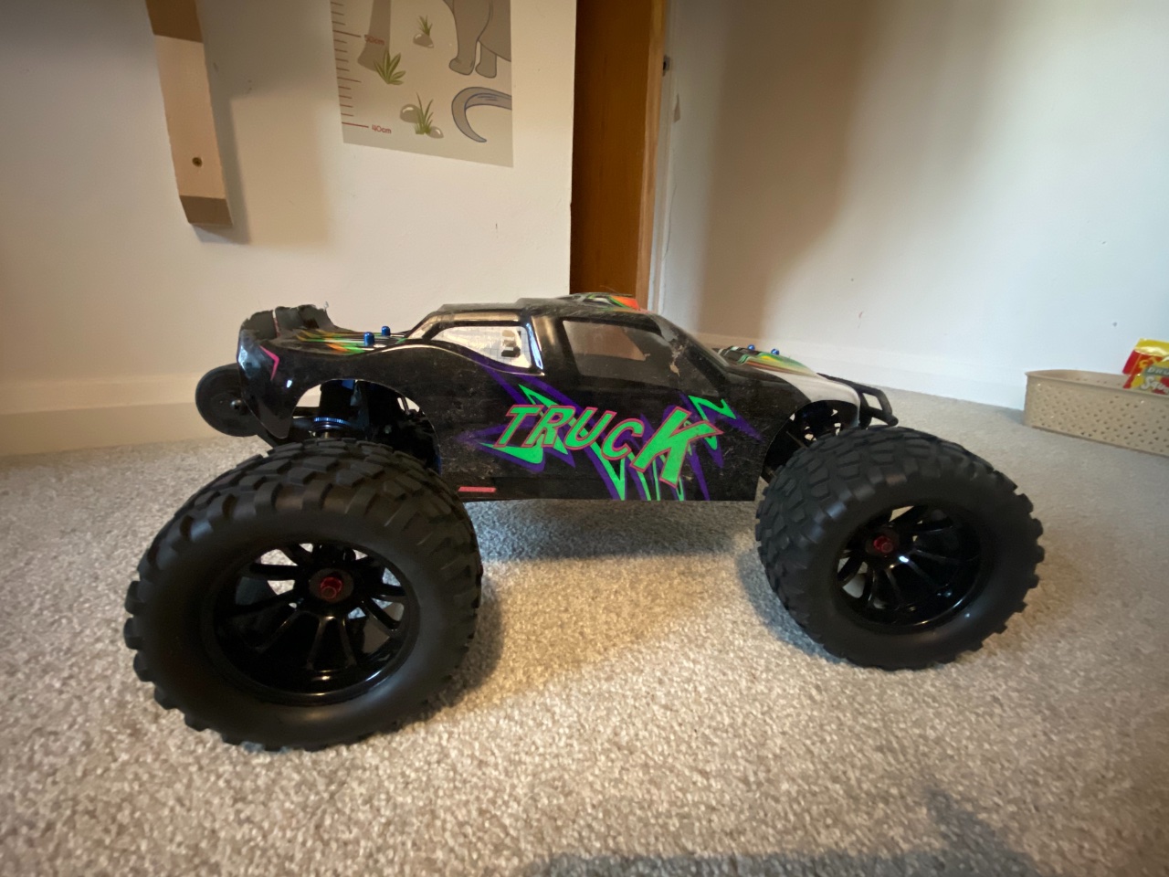

Boom! Thanks for the advice re the wheels, @Jens. They’re superb. I was impatient and ordered the 76 x 25 insulation (without measuring before they were delivered) and it fitted a treat. My son is a bit jealous, but wanted to order just one set initially to make sure they work okay.
did you upgrade the steering servo after upping the wheel size? The 3kg standard one isn’t great, and I’m thinking the added resistance on the ground and weight will only make things worse. Will test it out tomorrow and see.

@Ant.pStock servos to weak even for the stock wheels, upgrade is a must. Can get a decen 18kg + for less than 20£
