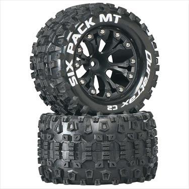

Hi all, just bought a used E-Firestorm with a Castle brushless system. It will need a new body and wheels. I was looking at the Duratrax Sixpack or Picket MT 2.8 Truck 2WD Mounted 1/2 Offset C2 Black. I think these fit ok? And I want to do a nice paint job so I need a clear body that will fit, not the original, it's too expensive, I believe the FTX Bugsta body fits, but what else? Apart from that, what are the best parts to upgrade with, the white HPI parts or RPM?

2.8 wheels will be heavy so people have had breakages due to extra weight/wear. Only upgrade you need is tbone bumpers and possibly ese ends as some people had problems with sotck ones popping off.
those picket st wheels and tyres look awesome. i'd go with them on the firestorm. as long as they're 12mm hex theyre grand.
