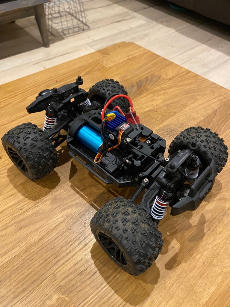

anyway now I’ve run out of things to do the Atom I thought I’d show you all. Only hop ups available from Maverick are the oil filled shocks, steel drive cups, driveshafts and wheel axles. I’ve bought a Surpass hobby 30A esc/receiver, 2445 3000Kv motor, Etronix ET2008 mg 2.5kg digital servo and 1300mah 25c 2s battery.
I also swapped out the bearings and bushes for rubber seal bearings and shimmed the play out of the diffs.

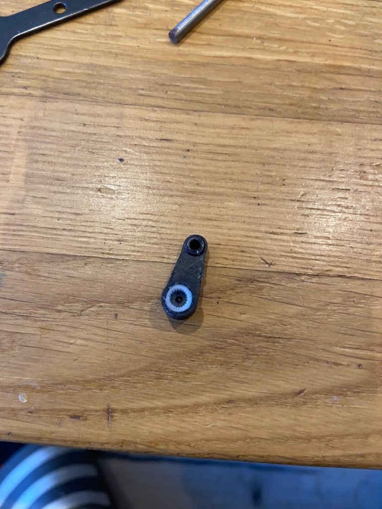

 I really struggled finding a 20t horn for the servo so had to properly modify the existing one.

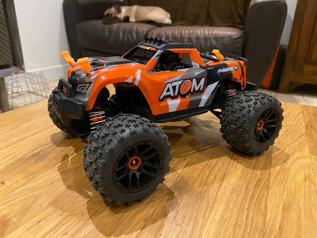

the esc is exactly the same size as the original only a little taller because of the heat sink and the motor wires stick out more. I can just about get the shell back on but the heat sink is touching so I may have to take the little people out. Shame as I wanted it to look stock and if the button on the esc was taller it would line up with the hole too!

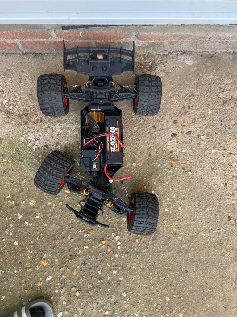

So far on the quantum I’ve replaced 2 shock shafts, front diff housing, front skid plate, servo saver arm and today I’ve broken my second chassis, both at the front where it meets the diff housing.
Think I’ll stay away from the skate park in future!
