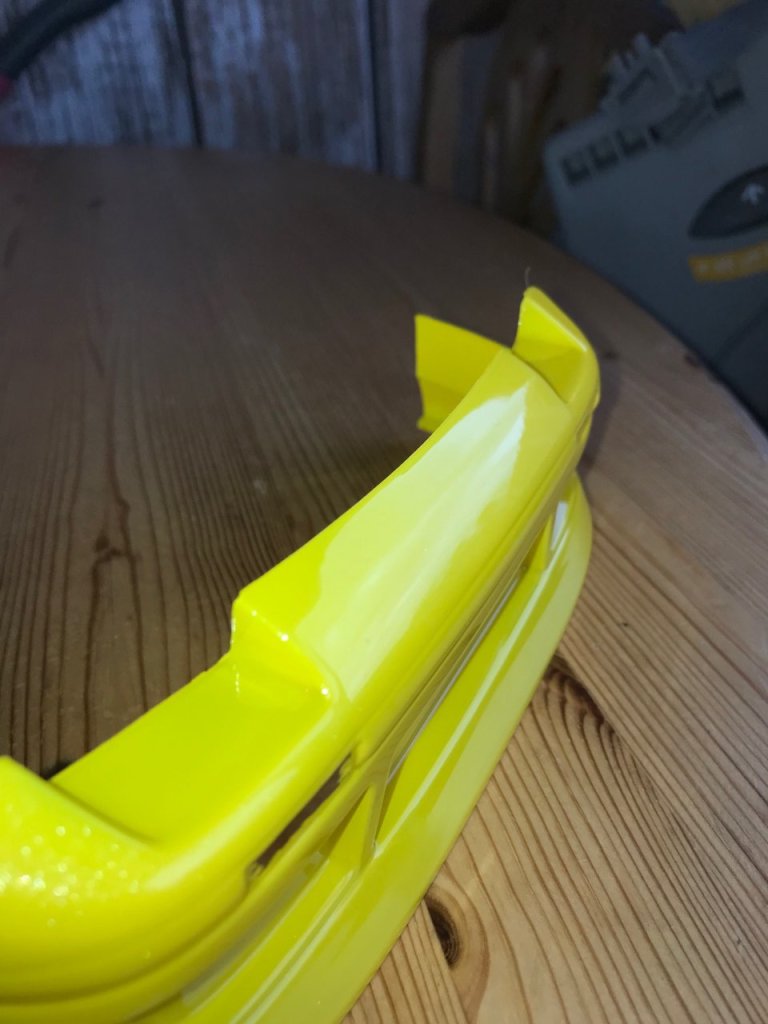

This is a bad pic but shows the metalflake effect. This was PS-58 backed with normal PS-6 yellow. I only use Tamiya paint, I think it's the best but it's just my opinion really.
This was two light coats of PS-58, I think a couple more would be better. One can would do a 1/10th shell easy.
