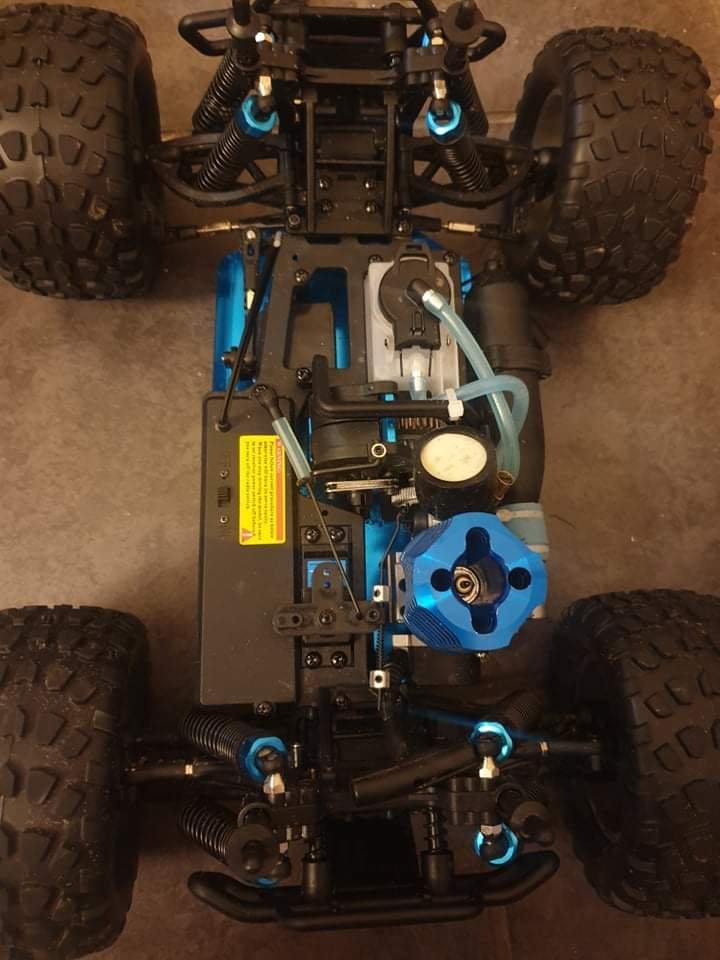

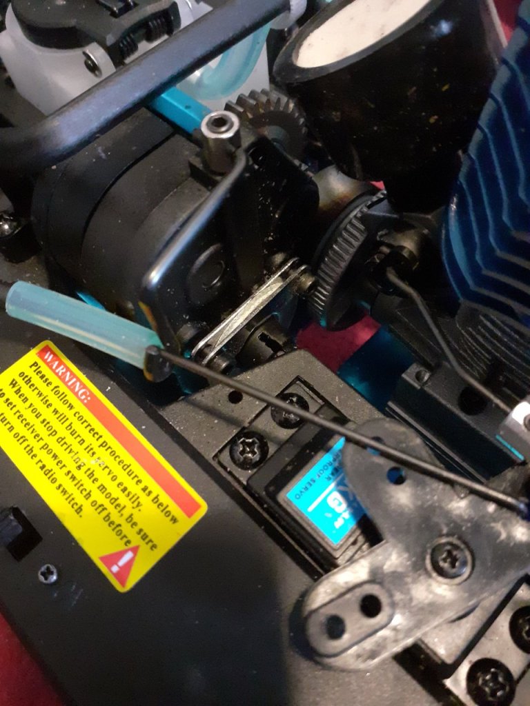

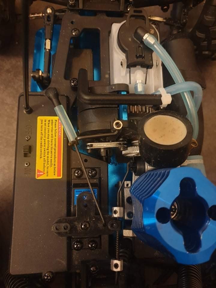

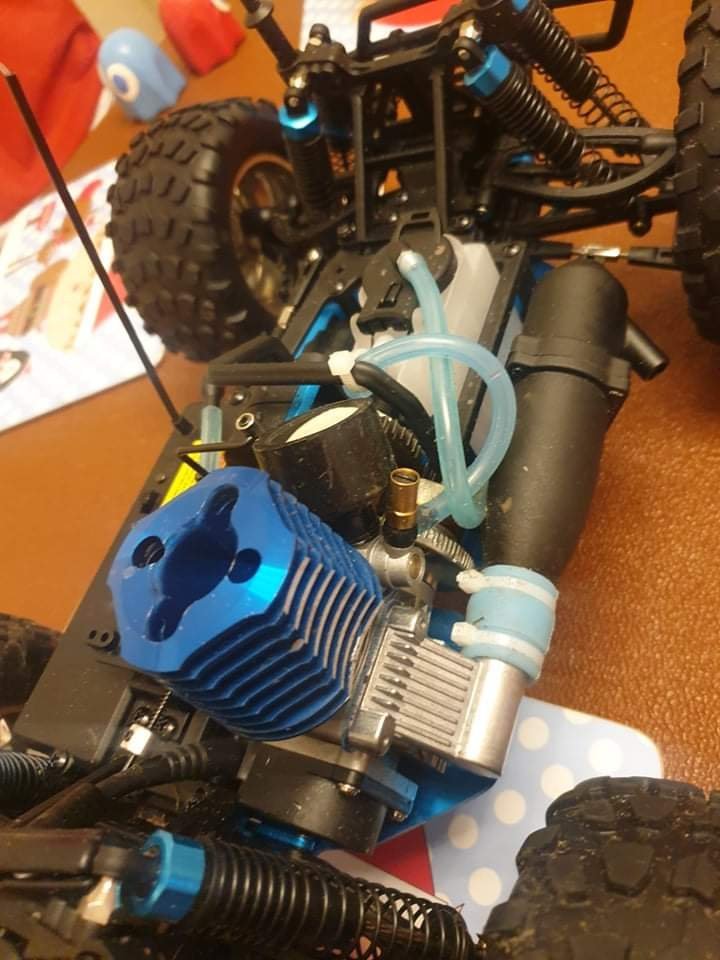

froggy8 Posted January 18, 2022 Share Posted January 18, 2022 can you take a picture of your brake set up please? Quote Link to comment Share on other sites More sharing options...
froggy8 Posted January 18, 2022 Share Posted January 18, 2022 there should be a circular thing with a grub screw inside it at teh end of the fuel tube. Quote Link to comment Share on other sites More sharing options...
Tonybt Posted January 19, 2022 Author Share Posted January 19, 2022 Sorry I took long getting back..are any of these photographs help Quote Link to comment Share on other sites More sharing options...
froggy8 Posted January 19, 2022 Share Posted January 19, 2022 have you tried tightening the screw at the end of the fuel tube? Quote Link to comment Share on other sites More sharing options...

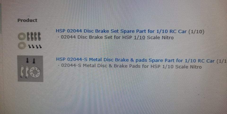

Tonybt Posted January 20, 2022 Author Share Posted January 20, 2022 Yeah thanks..also noticed that the brakes were starting to wear in the middle too so I've orded new ones in the picture the top brakes are like mine but I've orded both the numbers are the same in the future can I use the metal one the second set...thanks so much for you help Quote Link to comment Share on other sites More sharing options...
froggy8 Posted January 25, 2022 Share Posted January 25, 2022 On 20/01/2022 at 14:24, Tonybt said: Yeah thanks..also noticed that the brakes were starting to wear in the middle too so I've orded new ones in the picture the top brakes are like mine but I've orded both the numbers are the same in the future can I use the metal one the second set...thanks so much for you help the top link gave me better results. Quote Link to comment Share on other sites More sharing options...
