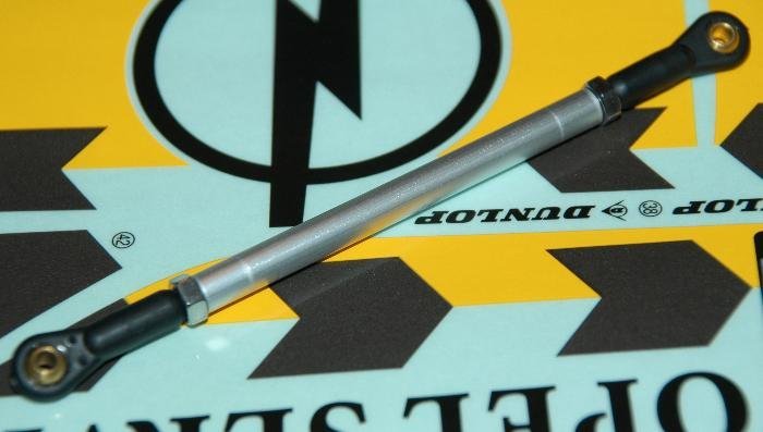

Ross9999992 Posted November 5, 2021 Share Posted November 5, 2021 (edited) Hey guys. I know there’s at least a couple of modders on here…so…whatcha using to make your own links? Looking to make some custom links for the recently acquired ravine. I have a bunch of m4 rod ends coming but struggling to decide on rod material. Easiest to get options I can seem to find are B&Q m4 threaded rod and their 6mm aluminium tube as a sleeve or potentially some 6mm delrin/acetal rod which I’d drill the ends of and shove some of that same threaded rod in? Sound about right? Any better suggestions? Cheers 👍🏻👍🏻 Edited November 5, 2021 by Ross9999992 Quote Link to comment Share on other sites More sharing options...

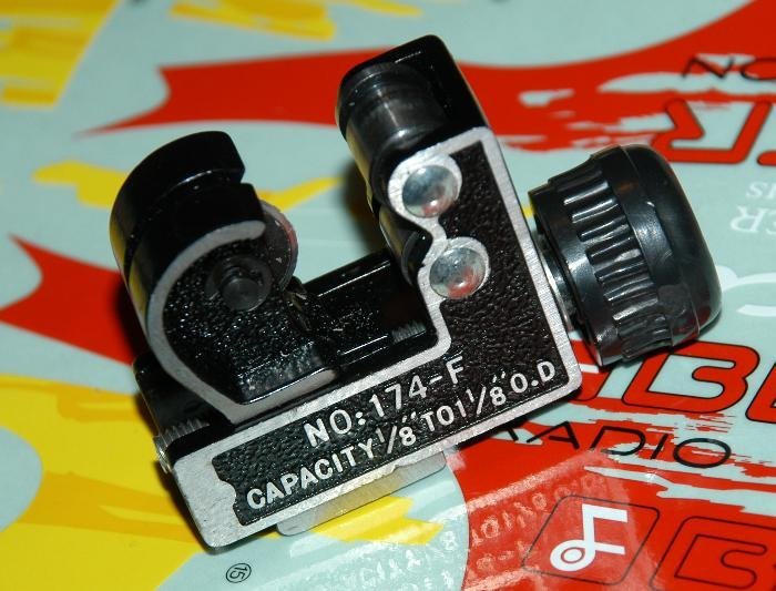

Popular Post TWINSET Posted November 5, 2021 Popular Post Share Posted November 5, 2021 (edited) Yup, 6mm tube with 4mm studding is a lot easier than trying to centre-drill delrin Get yourself one of these to cut tubing accurately Shouldn't cost more than a tenner at Amazon, or Screwfix do 'em cheap Edited November 5, 2021 by TWINSET 3 1 Quote Link to comment Share on other sites More sharing options...

Gaz! Posted November 5, 2021 Share Posted November 5, 2021 1 hour ago, TWINSET said: Yup, 6mm tube with 4mm studding is a lot easier than trying to centre-drill delrin Get yourself one of these to cut tubing accurately Shouldn't cost more than a tenner at Amazon, or Screwfix do 'em cheap This exactly mate, @TWINSET is bang on the money, use the exact same stuff from B&Q (when they have stock) for the last ten or so years and always worked well in every application. if you want to do a bend, either do it with the rod in if not use some sand to fill up the tube before bending, stops it collapsing on itself. go for it mate Quote Link to comment Share on other sites More sharing options...
Ross9999992 Posted November 5, 2021 Author Share Posted November 5, 2021 Excellent, cheers. That’s exactly what I wanted to hear. Also cheers for the links @TWINSET I was planning on just going hacksaw but for £3 I’ll just grab one of those screwfix cutters 👍🏻 2 hours ago, stimpy said: If you want to bend them, if you want them light, if you can cut threads... Yes I do (high clearance lowers and steering links), not particularly (could use some extra weight from what I can tell) and no…hadn’t needed a tap and die ever before so don’t own one yet. So yeah just looking to do some bent lowers for now mostly - why are straight links even a thing, specially on a moa? It has the y link thing for the uppers so unsure if I can just swap that out for dual links or if that would just make things all wobbly? Will also replace the front/rear steering/drag links because yeah why not 😁 1 hour ago, Gaz! said: if you want to do a bend, either do it with the rod in Yeah not looking forward to the bending but I was thinking I’d shove the (slightly over length) rod through and then do it…some sort of 3 pin bodge job in one of these little vices I have I reckon 👍🏻 Quote Link to comment Share on other sites More sharing options...
