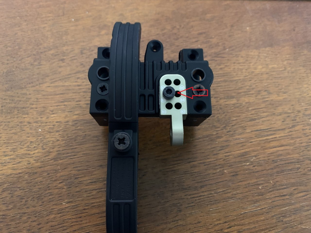

Now on to the car...I didnt have time to tinker with it at all,just took a quick look around...I spotted a stupid assembly mistake on the front shocks(second photo)...I hope the rest of the car is ok,fingers crossed

here you go, pull out the left screw, loosen the one on the right, loosen all 3 metal plates holding the motor mount in place (red arrows, one in the back) and also pull out the screw on the holder between center diff mount top plate and motor mount (second picture) to be able to adjust the mesh
Just to be more precise, loosen just the top metal washer (those 3 holding the bottom motor mount plate) not the metal plates/washers bolted to the chassis, you are basically adjusting (moving) entire motor mount assembly, hope it’s clear otherwise I would film it for ya
