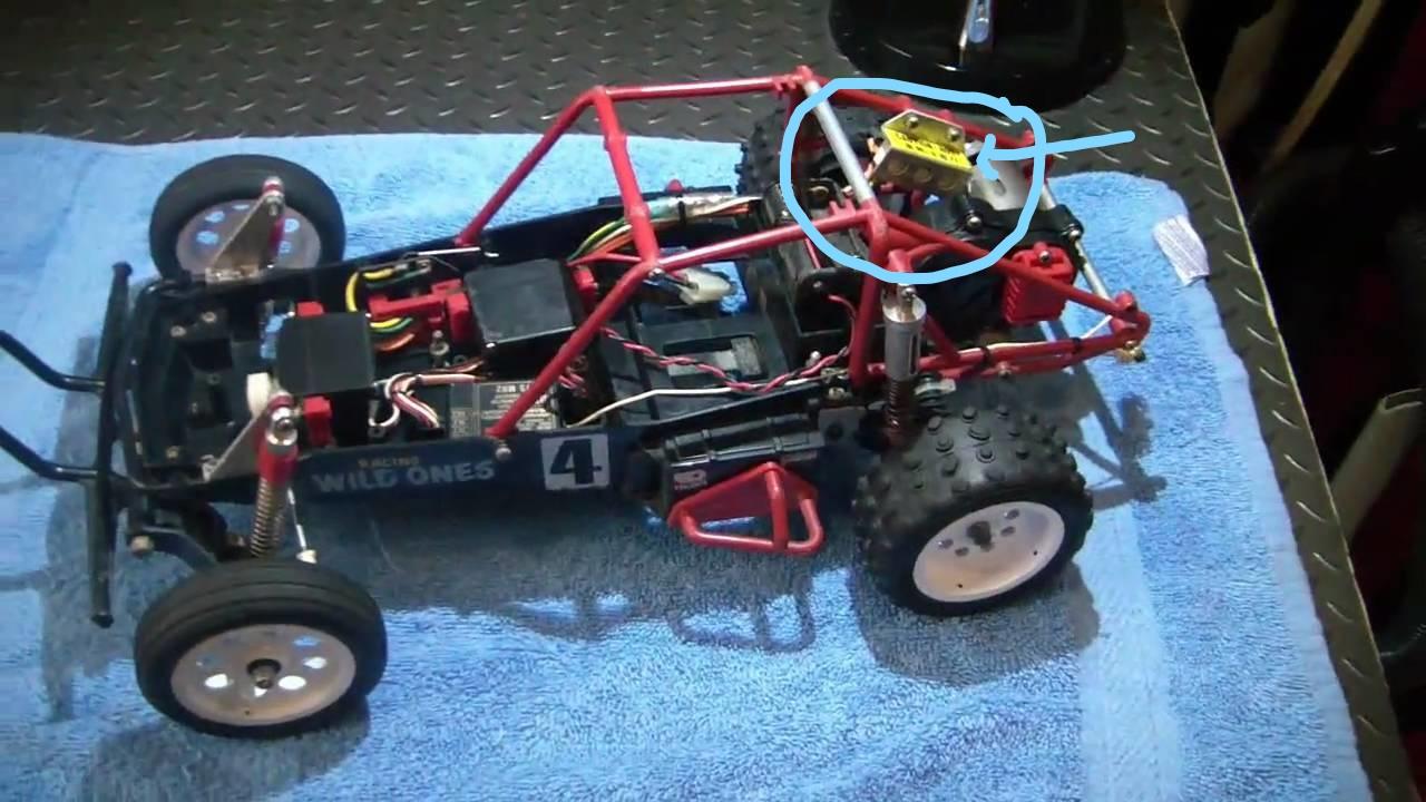

Just got a Tamiya wild one and looking to restore and update it but what and where can I find this part the fuse thingy that sits just above the motor towards the main chassis would have a pic but Can't post any

is this the part ?  if yes there are some 2nd hand ones on ebay  or new from the usa . or go for a esc .. https://www.modelsport.co.uk/hobbywing-quicrun-1060-brushed-waterproof-esc-sbec/rc-car-products/404964 . think this is the go to one , but there are lots to chose from ...

That type of mechanical speed controller only has 3 positions full/half/low speed (that's what the resistor is for). Unless you're trying to do a full restoration, swapping the mechanical speed controller out for a modern ESC will put you leaps and bounds ahead in terms of controllability and efficiency

Yes it is. Something around the 17.5t level would suit it well, faster than stock, but not too fast for the chassis to handle.
In terms of gear, I'd recommend the Tamiya TBLE-02 ESC due to its affordable price and gentle gearbox-friendly throttle profile, along with a Turnigy Trackstar sensored brushless motor due to its affordability, easily accessible connectors and red anodising which looks great with the Wild One rollcage.
