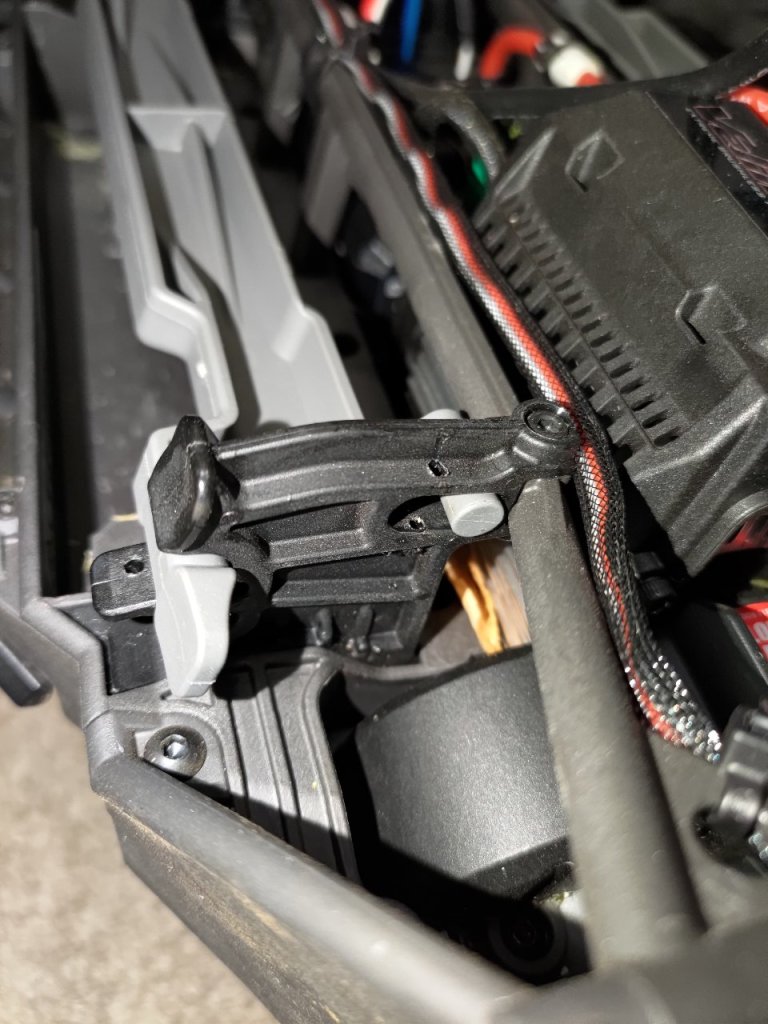

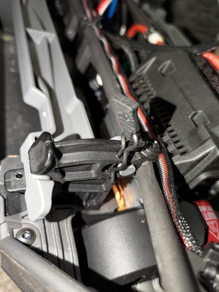

I finally made it so my batteries wouldn't fly out after a hard hit. Drilled a hole through one side of the black battery clip and put a body clip through. Batteries don't come out anymore.

 Brilliant Idea. This is how the Sledge is

Holly hell - do you run it in to the brick wall? 😄 i have newer managed to loose my lipos 😄

I lost one when I landed a jump wrong and the truck cartwheeled almost 100ft...into a small tree.😔

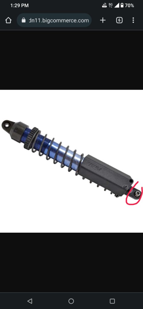

Is it pretty common to break the shock shaft rod end that connects to the lower a arm? I have the RPM shock guards installed and not sure if they contributed to the rod end breaking.

I used to break them on my 6S X Maxx. I switched to D Hawk shock shafts after that
The shaft itself is fine. The part that holds the pivot ball broke.

Iv bent some shock  shafts but never broke lower arm connection.... such a weird spot to brake... Are you running stock shock oil/springs? if so i would guess that you bottom out shocks on high jumps? Since i run my truck on a BMX track - lots of jumps - i replaced stock oil with XTR 950cst and harder springs in the back - also i tighten them to the max when i go for jumps.
