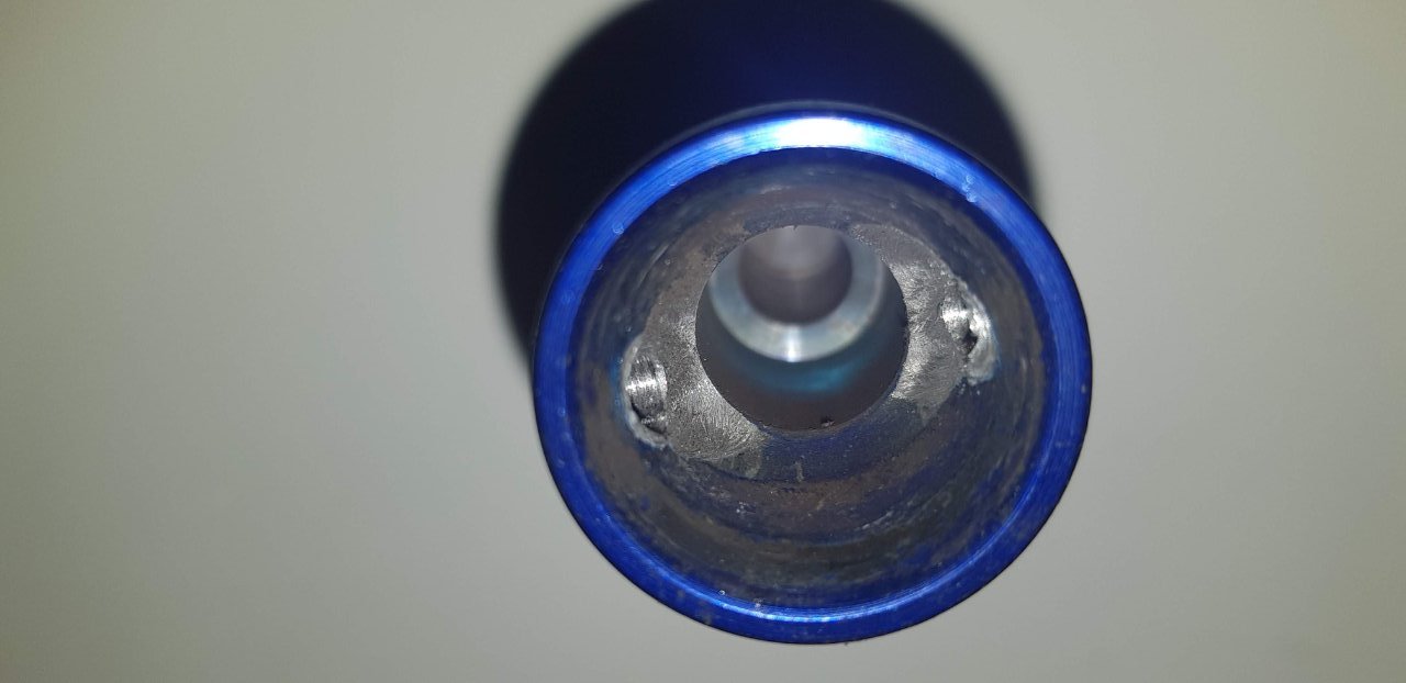

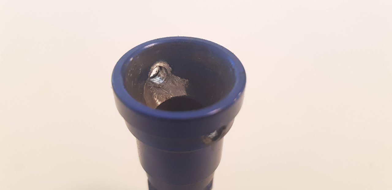

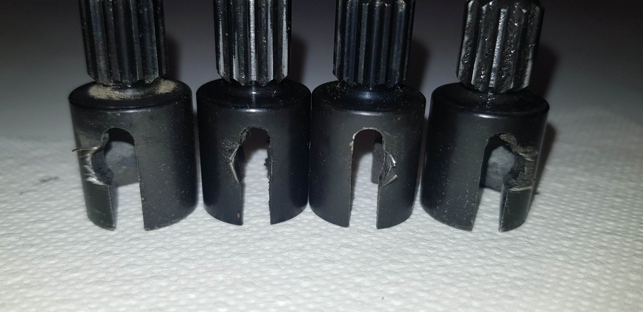

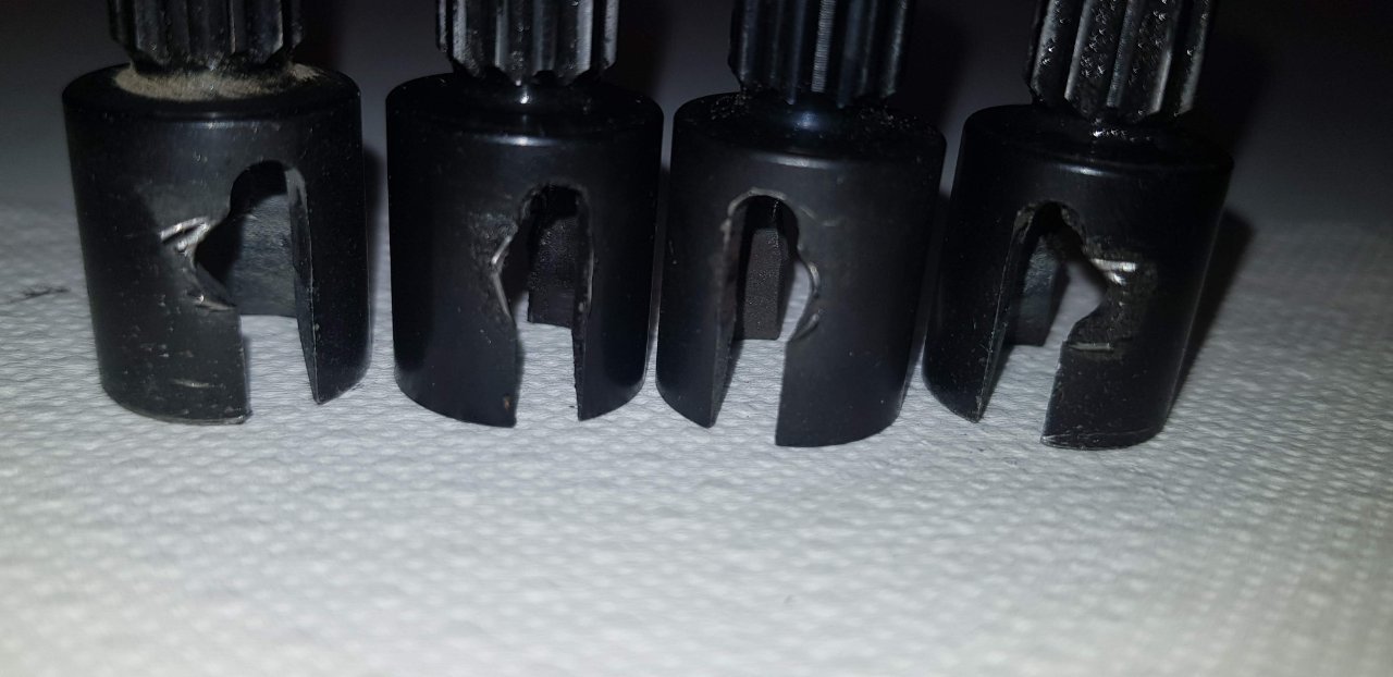

My truck started to make clicking sounds while driving slow. Upon inspection i have found some damage in the stub axels (will try to attach a picture). Had to use hammer to be able to remove inner bearings... Why is this happening? Are wheels too heavy (Badlands)? Must i change the way i drive - no sudden stops or full throttle from the spot? Maybe i can change these settings via Traxxas Link?
I see you are running Louise X-UPHILL - how long have you had them? I was so disappointed with stock wheels (foam evaporated and rubber tore in like 4-5 runs) that i had to find some wheels that would not balloon and i dont have to glue them every run.... so i bought Badlands... But with recent observed damage, im starting to think that i must go for some lighter wheels...
20 hours ago, Tadas said:
But as i see X Uphills weigh almost the same as badlands - difference is ~ 30g per wheel? Is that a big difference?
If Im honest, I thought there was a bigger weight difference.
I like the Uphills, other than the tyre writing..... They cost half the price of Badlands too.
