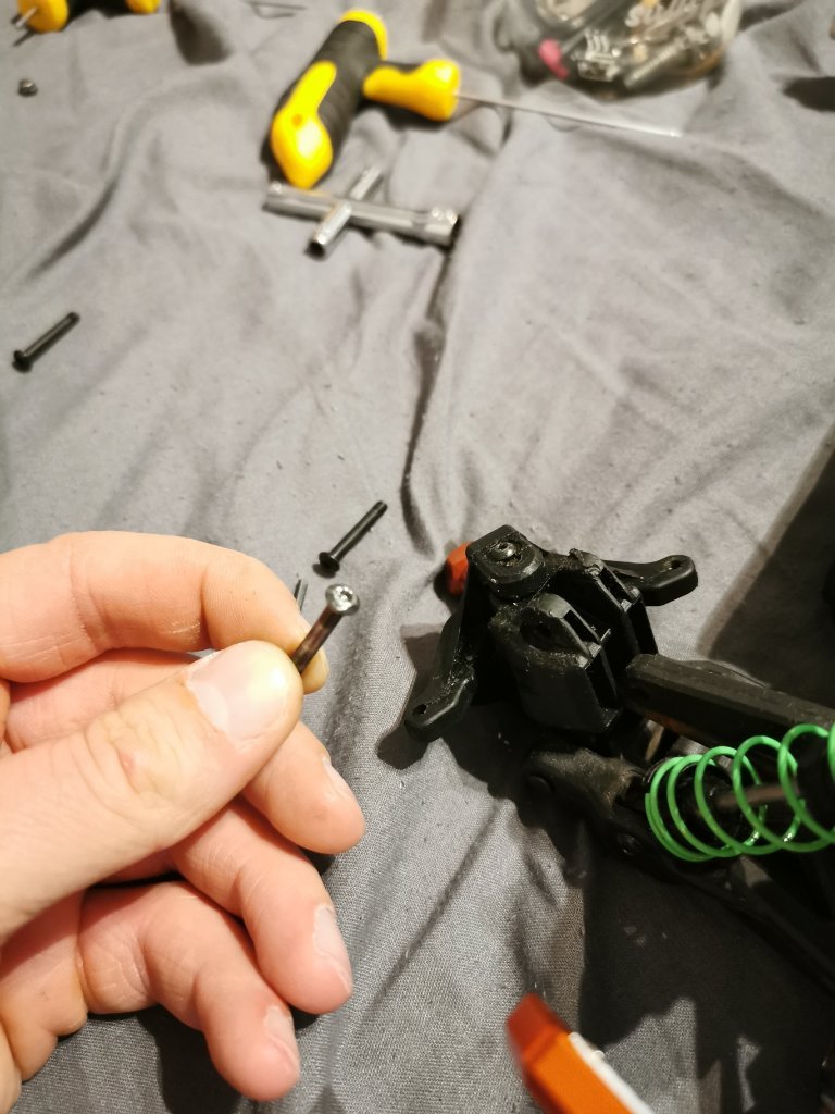

leongordon234 Posted December 14, 2021 Share Posted December 14, 2021 So my axle extenders came in the post but the pins are slightly thicker so will need to drill out the axles Anybody else done this? or did you use the original pins which are quite thin really Quote Link to comment Share on other sites More sharing options...

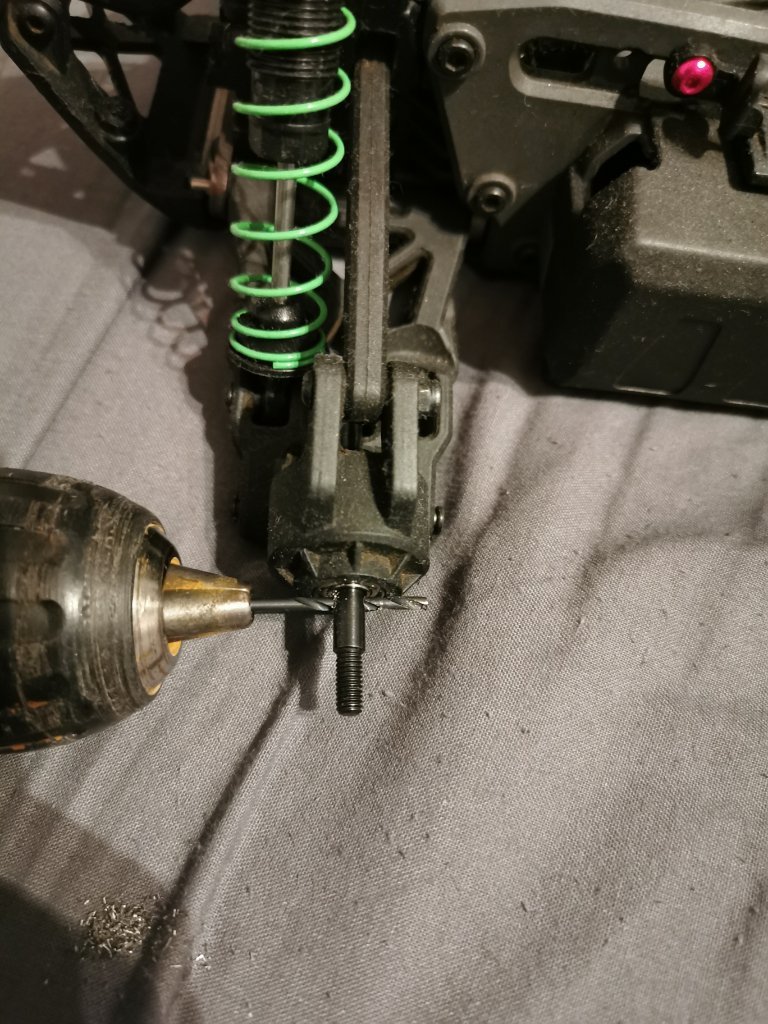

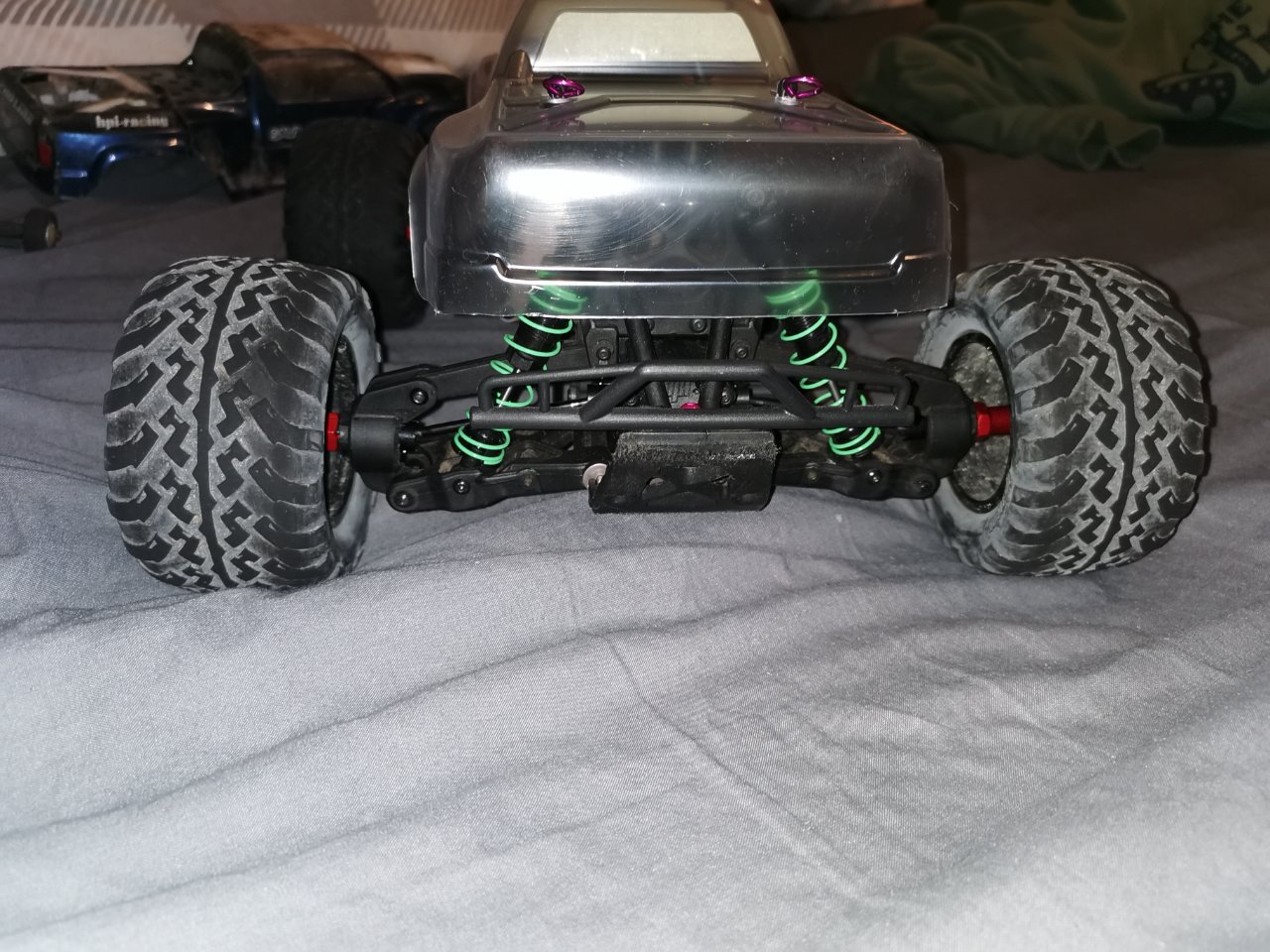

leongordon234 Posted February 7, 2022 Share Posted February 7, 2022 Fitted the axle extenders to my shelf queen Had to drill the axle out to fit the thicker pins, went through 3 drill bits as they must be hardened axles There is alot side to side play so need to shim them out abit What size shims did other people use who have these extenders? Quote Link to comment Share on other sites More sharing options...

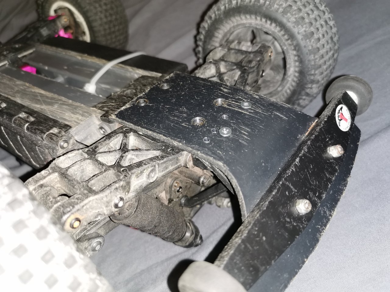

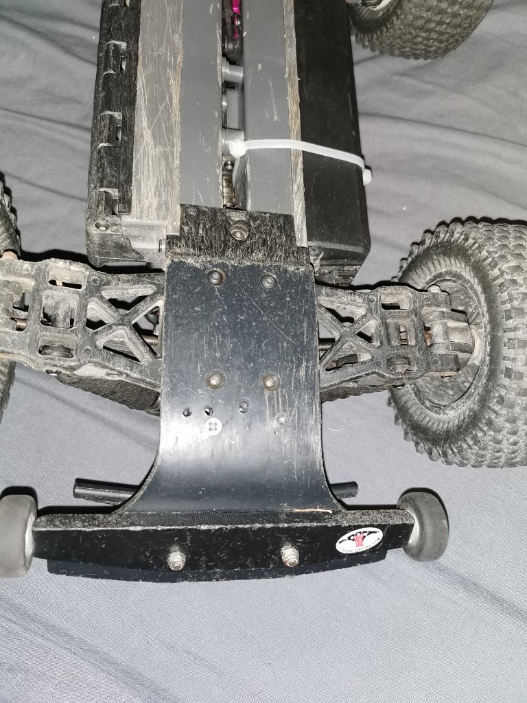

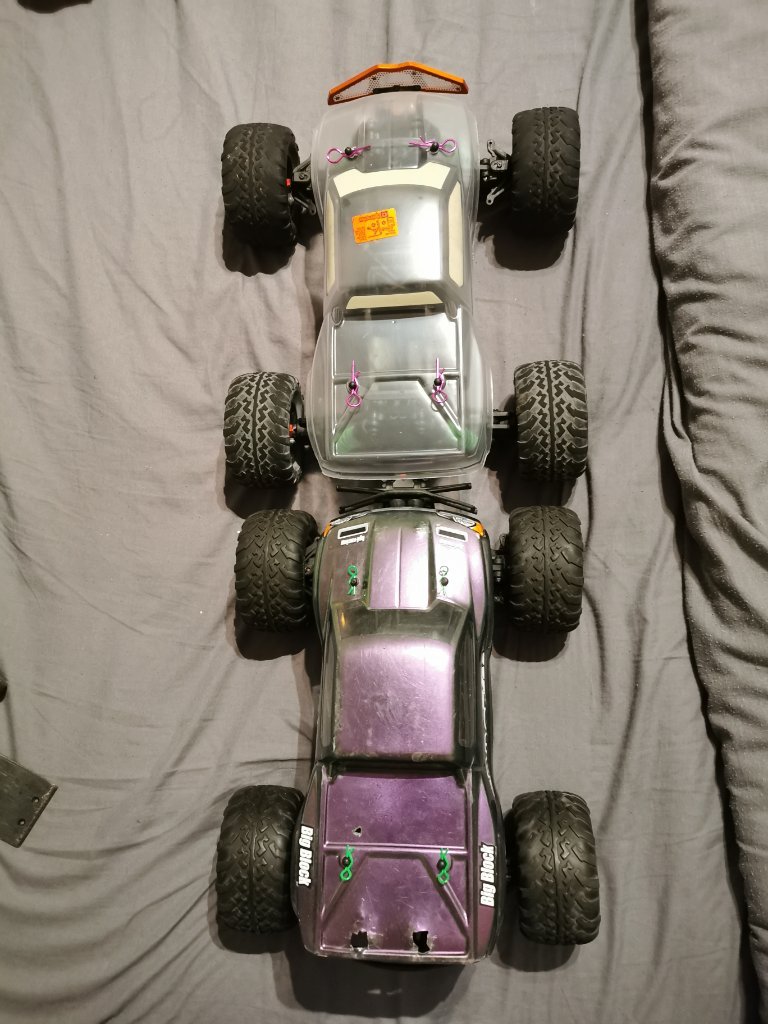

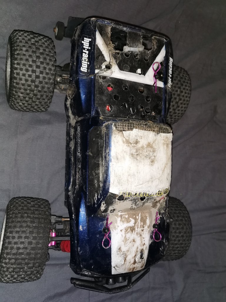

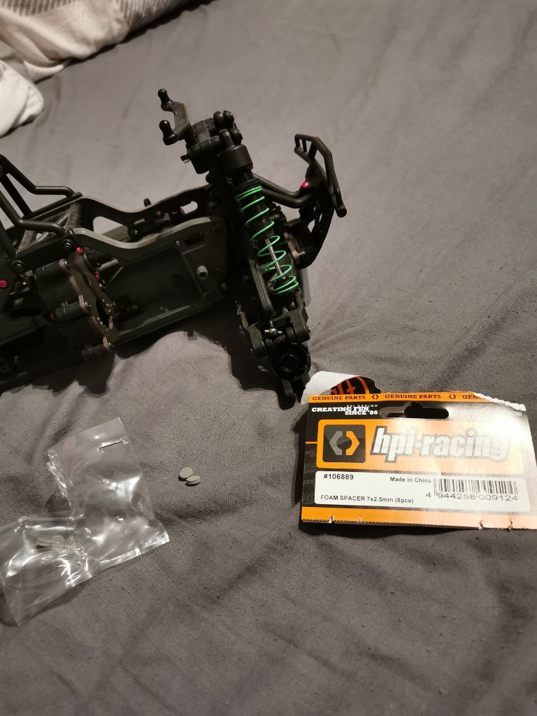

leongordon234 Posted February 8, 2022 Share Posted February 8, 2022 After abit of fettling I used the hpi foam spacers pack that I had in the spares box and managed to get rid of most of the slop They don't tend to last forever as they deteriorate over time and squish but should be alright for the time being as its only on the shelf queen I dug out some old tyres just to see the width difference and it is quite noticable, will be Interesting to see the handling. Will be getting some nice wheels and tyres at some point to make it look more normal rather than semi slicks 😂 On my main basher xs I installed a t bone racing wheelie bar Its mounted ontop of the original skid plate using the original screws. How ever I found the longer screws didn't quite catch so I put them in as normal underneath and then drilled 2 holes to put some self tappers in whilst using the other 2 shorter original mounting screws too Doesn't look the prettiest but Its a basher and if it works then hey ho 👍 Mounted the shell on the shelf queen as well ready for paint Need to fit the traxxas turn buckles to give the shelf queen some steering Got the rod and ends just need time to modify them. I think my basher shell has seen better days after many attempts at fixing it 😂😂 My xs fleet is all rolling now 😁😁 1 Quote Link to comment Share on other sites More sharing options...

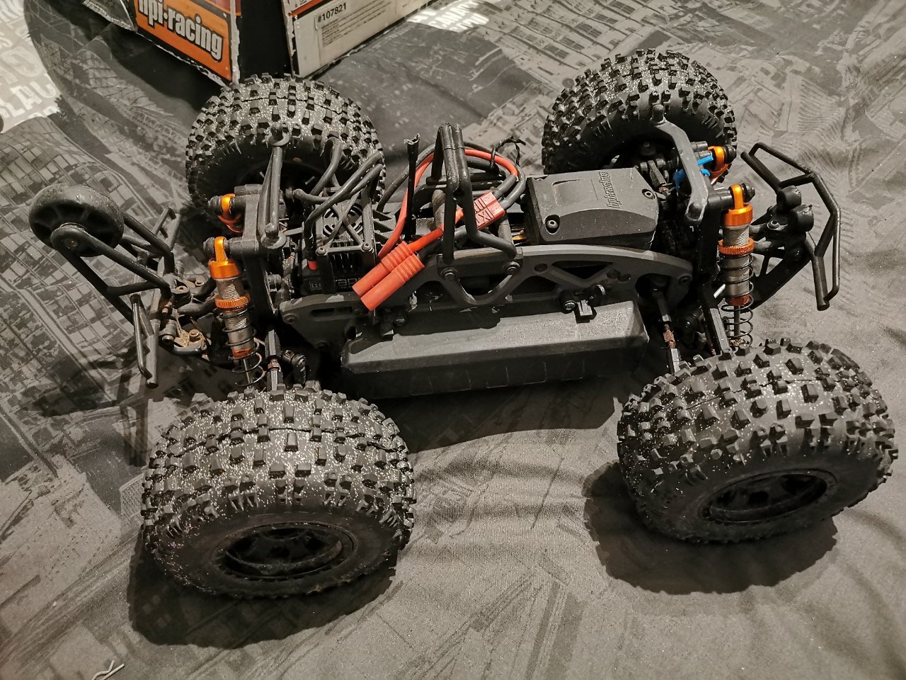

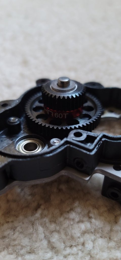

testrak Posted February 23, 2022 Share Posted February 23, 2022 (edited) Picked up a Flux XS. Disassembled the tranny to replace the stock idler gear with a 60T. Added a m5 washer to prevent the gear from sliding on the shaft. Also cleaned the gearbox of excess grease to prevent it from getting onto the slipper pad. The truck was assembled pretty well with red loctite on wheel hex pins and pins on the tranny outdrive cups, blue loctite on motor and motor pinion. However, HPI short changed this unit by omitting a bearing on the idler gear (the bearing on the 32 t side) and a m3 washer that goes on the screw that mounts the motor. Edited February 23, 2022 by testrak Added details on build Quote Link to comment Share on other sites More sharing options...

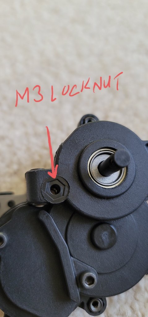

testrak Posted February 23, 2022 Share Posted February 23, 2022 (edited) Apparently the gearbox seemed to be designed to accept a m3 locknut with m3x32 mm cap head screw. However HPI decided to use shorter screw without a locknut to hold this area together. I think this would be a good mod since the locknut can keep the screw from potentionally backing out and would strengthen the clamping force in that area since there is only 1 locknut on the motor side of the gearbox. Edited February 23, 2022 by testrak Added detail. Quote Link to comment Share on other sites More sharing options...

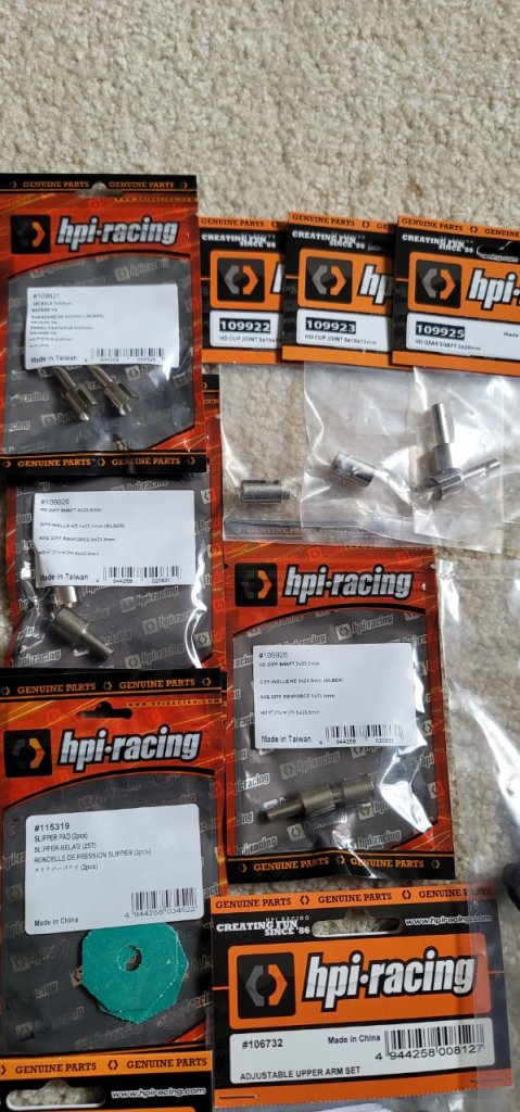

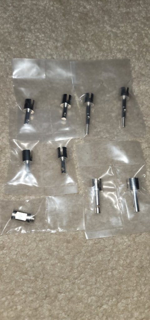

testrak Posted February 26, 2022 Share Posted February 26, 2022 (edited) Ordered some HD parts from rc4me.us and this is what arrived in non HPI bags. These are knockoffs as the tranny outdrive (lower left unit) is slotted in the middle compared to the pic that was posted by leongordon234 on page 96. I also noticed the slots are not completely straight compared to the stock unit. The site uses HPI HD part numbers and is misrepresenting the product being sold. Please avoid buying from them. Edited February 26, 2022 by testrak Added detail 1 Quote Link to comment Share on other sites More sharing options...
testrak Posted March 19, 2022 Share Posted March 19, 2022 (edited) HPI OEM parts arrived. Diff parts are higher quality as they are made in Taiwan. I noticed #115319 slipper pad can substituted for the Flux XS. It will need to be trimmed down in size and shape to fit. Edited March 19, 2022 by testrak Added info. Quote Link to comment Share on other sites More sharing options...
Redback Posted June 25, 2022 Share Posted June 25, 2022 Those cups look nice, ive noticed the center ones need replacing every few runs it seems. I also found we have twisted some drive shafts 25% atleast are there stronger ones? The stock diffs are super strong, just did 70mph with the savage at a recent speed run event on stock motor too. Seems the power is to much for the drive cups out the transmission as they are eaten, along with 6 shattered grub screws, shearing the pin on it seems common. Quote Link to comment Share on other sites More sharing options...
