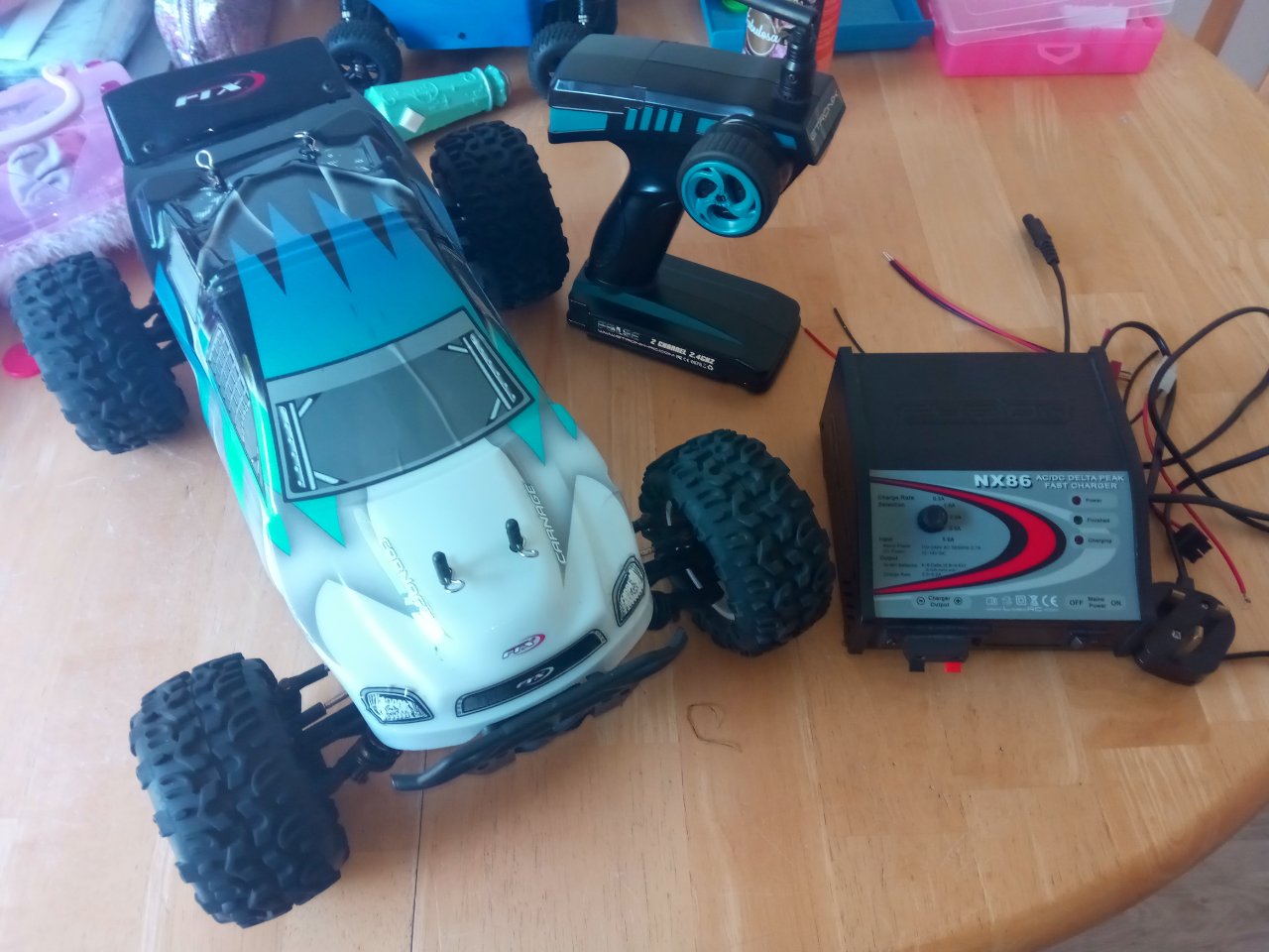

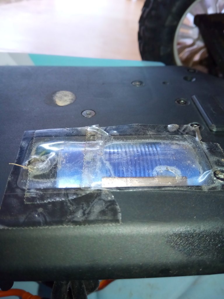

The £40 carnage arrived and looks like it's not had a hard life at all! Literally no scratches on the underneath, the seller said it had a blown motor but after taking off the gear cover yep you guessed correctly.... Stones were caught up in the spur gear!!! I had a pinion, greased the rear diff with some bike grease,put some tape on the gaps in the motor mount, put a 2950kv photon 2.1 system in and a 9kg servo in and happy days!!! Cheap RC car
WIN! 👍
Did they not check   OMG     but a what a winner

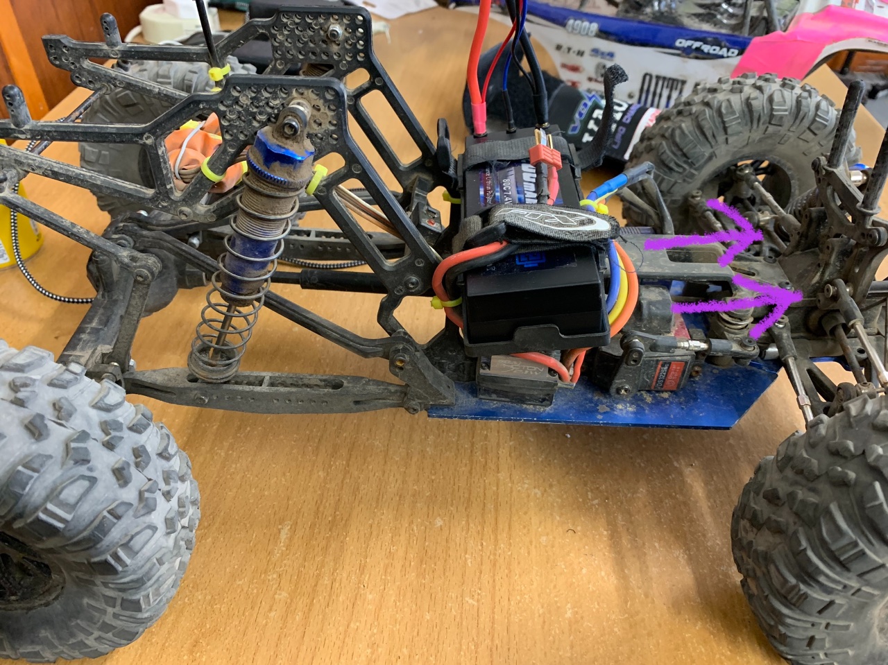

Despite my efforts with blue threadlock the centre drive shaft grub screw has come loose again...Time to bring out the red! Tbh it was after many runs at full throttle and then using the brakes to power slide the car back round so guessing I might be pushing it a bit too hard...That or I didn't lock it well in the first place.
Has anyone else had this issue? Mine is the brush less model.
