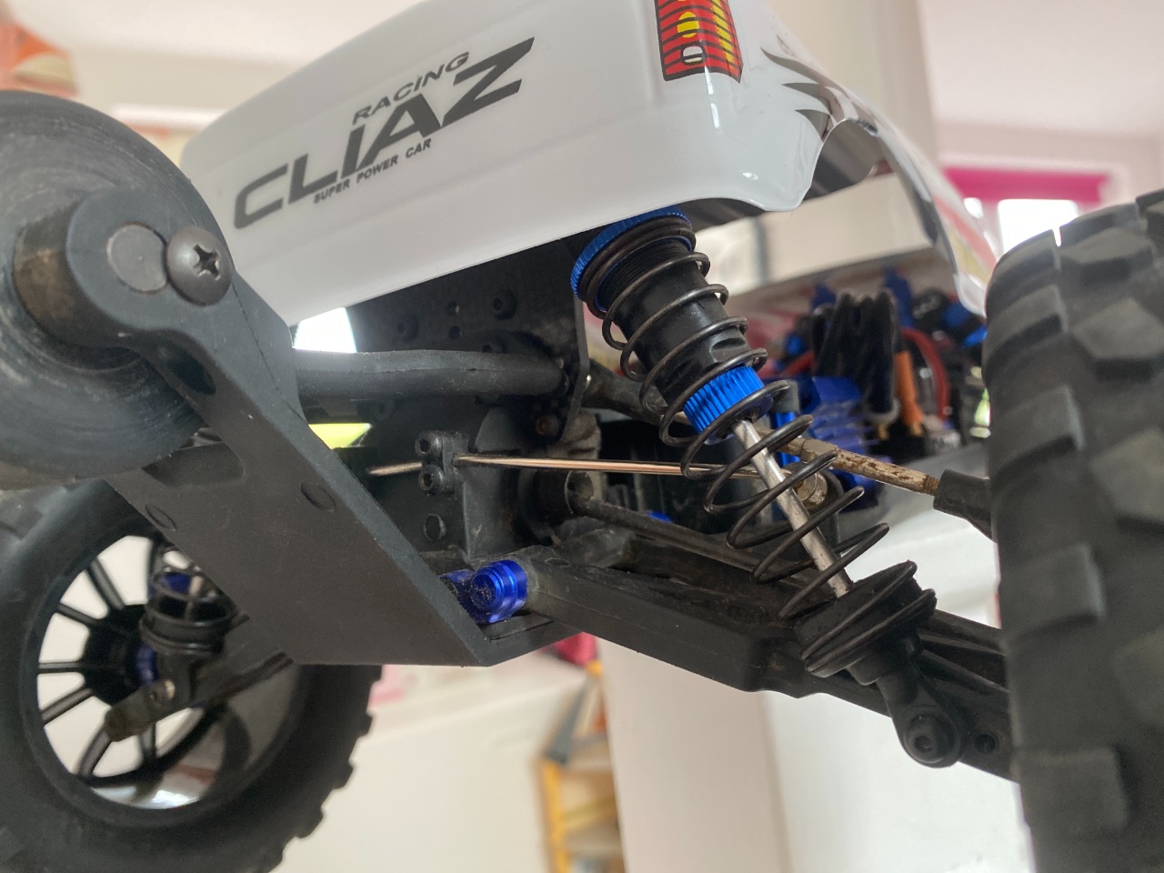

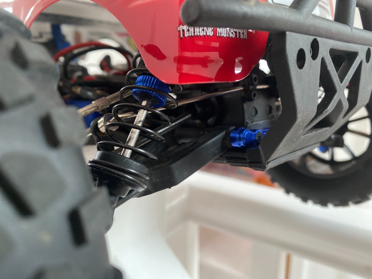

So I've just received my sway bars for my vantage, but only realise now they don't come with everything I need to attach, need sway bar clips by the looks of it and I'm not sure what else, can someone point me in the direction of which screws I would need to attach them please? Can't see any threads as such for where there supposed to go?
Edit: ignore, don't worry it comes with everything in the bag. Was just acting blind
