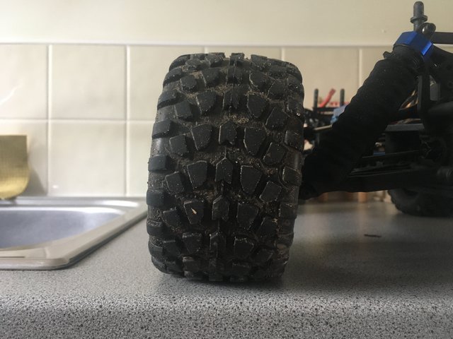

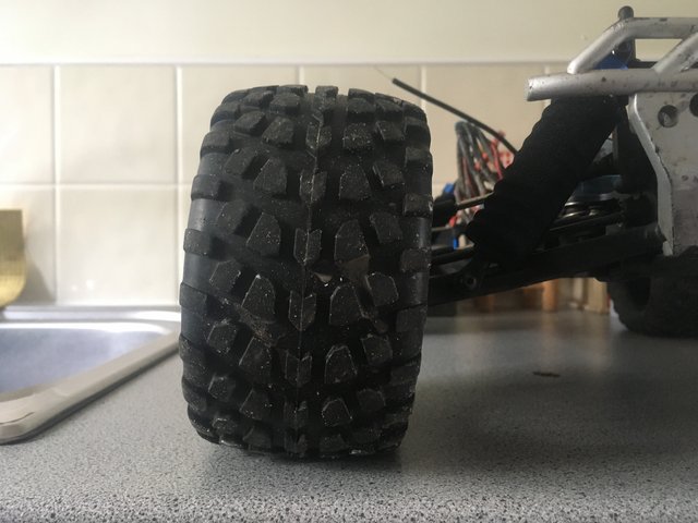

Which wheels did you choose? I’ve been looking at that as the next upgrade, as the original inserts on ours have completely perished now leaving what feels like flat tyres and the rubber is super soft - I think they are my main issue with lack of control at high speeds. Or could just be that I’m not a good driver 🤔
I trained my son almost every weekend the last 6 months, starting slow with the FTX Mauler, going to FTX Bugsta Brushless, letting him try my Rustler with 2S Lipos, then with 3S and ending up at the current setup.
Thinking (as being German) that in Germany he would not even be permitted to drive any of those cars.
That said, I think there is no such thing as a bad driver. Just not enough experience.
How long do you have your Carnage?
These are the wheels: https://www.ebay.co.uk/itm/4PCS-Wheels-Tires-Set-1-10-Rc-Monster-Truck-For-Losi-Tenacity-Mt-12mm-Hex/154220196248?ssPageName=STRK%3AMEBIDX%3AIT&_trksid=p2057872.m2749.l2649
And I cut inserts from these: https://www.ebay.co.uk/itm/Armaflex-Pipe-Insulation-Lagging-Black-Nitrile-Foam-Class-O-2m/273509911546?epid=22030367669&hash=item3fae760bfa:g:Z-MAAOSwLXNbxLm5
The Armaflex pipe lagging has a major advantage. It's made of closed cell foam and therefore will never be soaked with water. And they are a bit harder than regular inserts.
( Looks like I am repeatedly posting that information :rofl: )
For me, it's the ultimate wheels setup for bashing, jumping and speed runs.

@Jens what size lagging? Two drop down options on the link you sent. Please can you let me know which ‘pipe size’ and ‘thickness’ you would recommend? Thanks
You catch me on that.
I don't remember.
I think it is 76mm, 19mm.
But don't nail me on that.
If you got time, order the wheels first and then measure.
Important is that outer diameter - (2 x thickness) matches precisely to your rims diameter.
In addition, I closed the water hole in the rims, preventing any water from coming in.

- Wheels with 5" outer diameter and 70mm width
The new wider wheels effectively prevent flips, though not completely.
