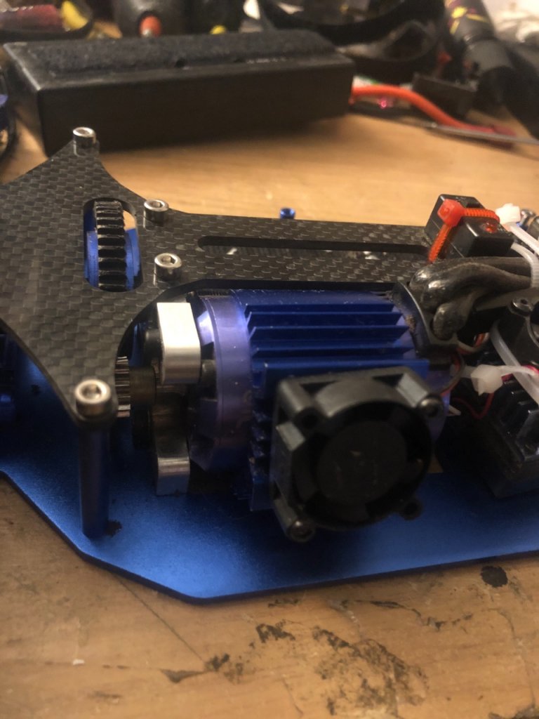

Hobbywing users if you run it flat out again and again does it cut out and take a few minutes to cool down. Thought at first it was just out of battery but didn't seem to be. I also have a fan on top of the motor and it feels cool. Also do have the thermal wire connected hence I wonder if it's cutting the motor.
My son went yesterday and today 4 hrs each nonstop bashing.
Lot's of speeding included as well.
Not a single case of overheating.
You and I have the same setup except that I don't use a motor fan. And I use a 10T pinion.
I have the feeling that the motor fan doesn't really help much since the Hobbywing motor doesn't have a flat surface.
Maybe not enough heat is transferred to the heat sink but instead trapped now between.
A heat sink would work well on a FTX factory brushless (Etronix Photon) or my Rustlers Velineon, since their motor surface is smooth.
Thermal wire is connected.
ESC is set to cut off at default 105°C.
It could also be that your battery has a higher C rating than mine and therefore pumps more Amps into the motor.
Edited by Jens
Ive never had a hobbywing setup cutout due to thermal overload of the esc or motor, i also didnt have the fan running on the esc and it was cooking... I think the shutoff would be the stalling cutoff or your punch is set higher than the batteries can discharge.
Cheers redback think we have the same set up as well hobbywing max10 and bashing 5500 50c battery. I had both fans on ESC and motor running. I originally thought the battery had run flat but walked a few minutes then tried it again and it ran for another good 5-10 min before stopping again.
Not changed anything just installed and ran with it, do have a programmer so could cut some power maybe but more fun trying to get used to the power and have to say touching the motor it felt pretty cool. Will see if it happens again next time out
Yes probably i have a few max systems, are you using  max 10 or max 10 stc? That a 3s battery yeah? You on a 4000kv motor or lowerkv?
maybe you are hitting the thermals then, is it geared pretty high, or maybe the gear mesh it too tight, the only time i have ever had hobbywing shut off is stalling it 3 times on hills. Maybe get some footage if it keeps happening?
Next time it cut out look at the leds, whats flashing?
Edited by Redback
Just the max 10. It really goes like the clappers and we were running it on a local closed golf club so were running it pretty much first out over and over again. It was still wheeling every now and then at full power. I have a video on my phone but been trying to compress and put it in here. Will look at doing that tomorrow maybe
Max 10 but what KV motor? This is what matters more.
My lads truck thats much bigger than a carnage has a diffrent hobbywing motor 3656 4200kv but uses the max10 on 2s lipos and we drive for hours and hours non stop even last summer when it was like 38c its never cutoff due to thermals, however this motor does not have a themal sensor cable. The way he pelts his truck about you would think the esc would cut out, the fan wasnt even connected once as i forgot to reconnect it after programming, thought id cooked it was stinking hot but it still keeps going.
Might be motor thermal cutout and if so, gear down or having a good motor combo wont be worth it if your having to cut runs short due to it protecting itself.
Have you spoken to hobbywing about it, something must be off, this shouldnt happen imo.
Edited by Redback
22 hours ago, DavidBH said:
I hope it's not another motor or ESC issue, will see next weekend when we get out again.
Consider removing the motor fan and heat sink.
I did that today on my extra Carnage with the cheap ESC/motor (orange GoolRC?) and I have no more problems of shutdown because of heat.
( Did about 2 hour race across the sports field )
It sounds somewhat strange, but maybe not enough heat is transferred from the ribbed motor surface to the heat sink.
It's just a guess, but it worked with me.

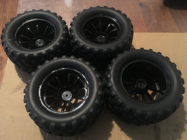

Received the new wheels for the extra Carnage.
A bit bigger, making the car a bit faster.
Those delivered foam inserts are prone to die fast.
Once water comes into the tire, the glue will dissolve and the foam ends up at one side of the wheel.
Proper inserts should not be glued like this!
Will now be used by my kiddo to put on his arms to turn him into a muscle man. :rofl:
Do you have to deglue the tyres from the rims and glue them on etc.?

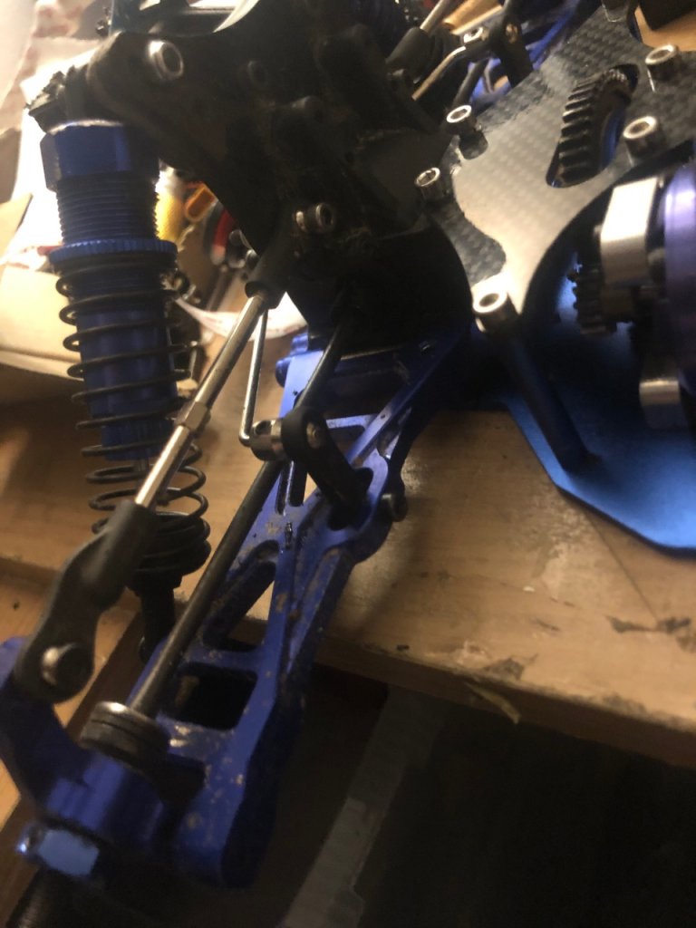

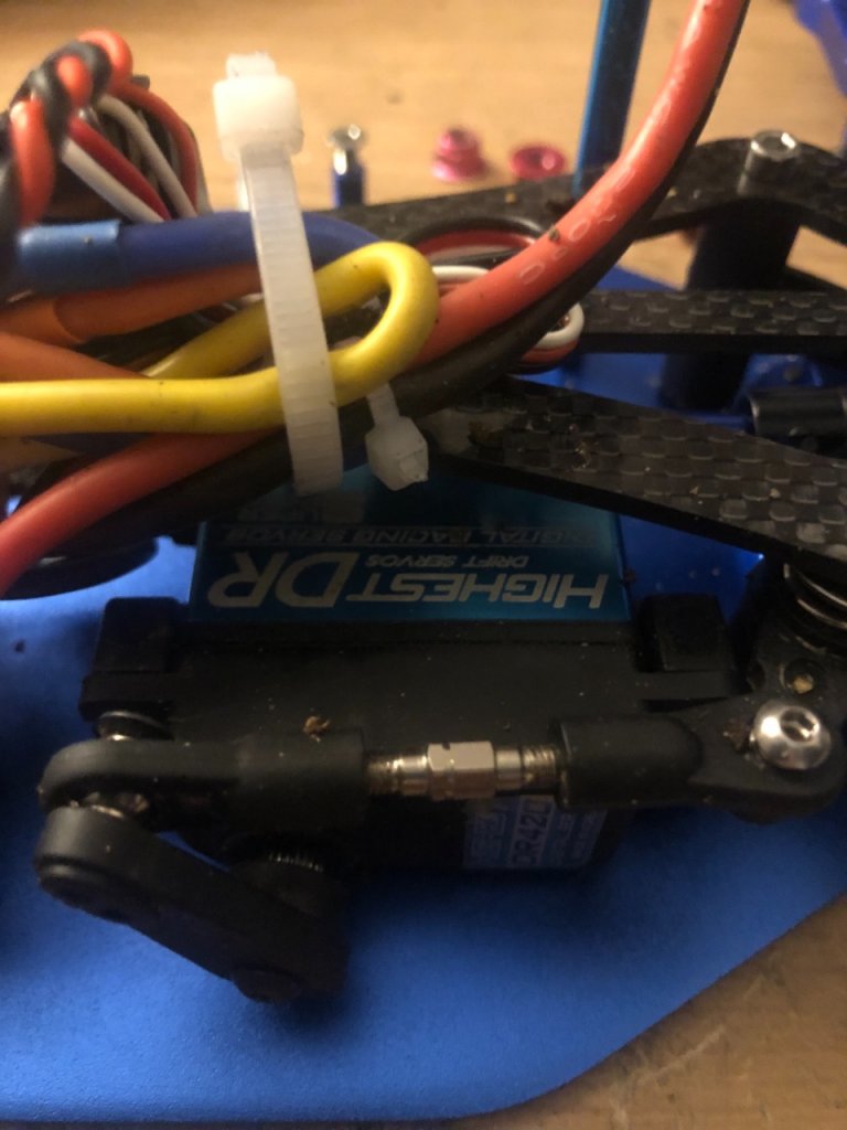

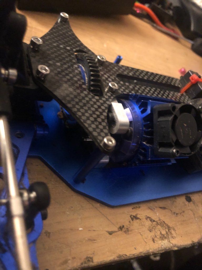

Is that a carnage 2 with aluminium chassis, struts can carbon fibre top piece?  Very nice in deed.

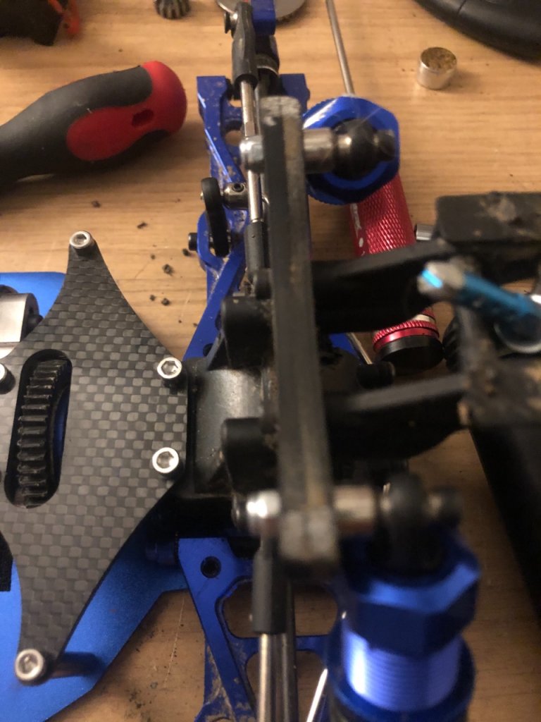

it was a vantage couldn’t get ahold of the carnage but brought all the ally upgrades because the plastic parts don’t last long.  Changed the dog bones at the back for the same cvd ones at front.  Doubled up the carbon rear towers a lot more stronger.  Ali on the front and changed the motor mount it can handle 20 foot jumps and falls

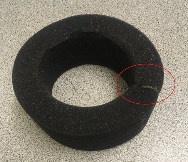

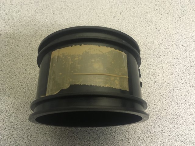

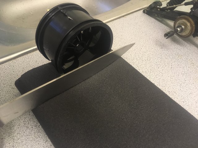

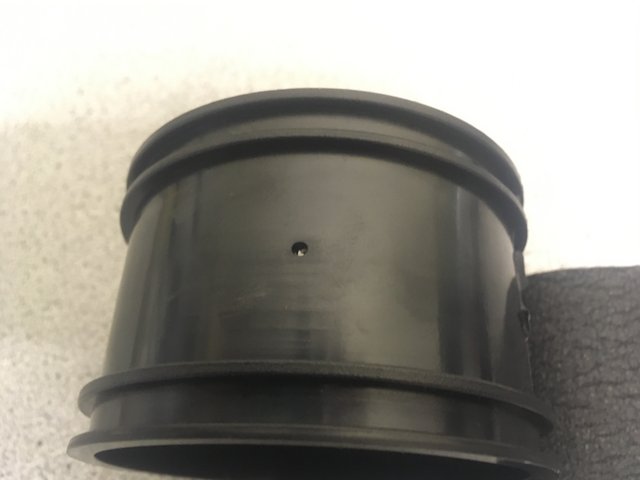

Tires came unglued. 👍
Just glued them yesterday:
Inserts cut from my pipe lagging:
Water hole:
Closed!
Glued.
Not nice looking, but waterproof. So I don't care.
Well fortified Carnage/former vantage!
Hope you don't mind me pointing out a weakness I saw in the pics.
It seems that pinion & spur are no more covered and the spur is still the plastic one.
(But maybe I see it wrong in the pictures)
Any stones coming in and the spur is nicely rounded.
You will find hardened steel pinion/spur at ebay sold by David (also a member here).
Using the front CVDs in the rear is a good idea...
Water hole:
Closed!
Glued.

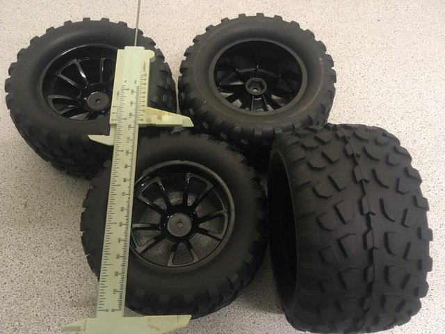

They look great. I think a few more days oh high speed running and I will need new tyres. Not tried the nail varnish trick but tried to take the present ones off the rims and thought they are likely to be damaged. Need to set aside time for programming, maybe messing around with the low voltage cutoff and seeing if I can get good speed data from my running watch to see if I can get a speed from the car.
Just a hint with a smirk. 😉
My tires are a bit bigger (5") giving you a bit higher speed.
Cost £32 for the complete set.
+pipe lagging, +tire glue
Tempting? :cheers:

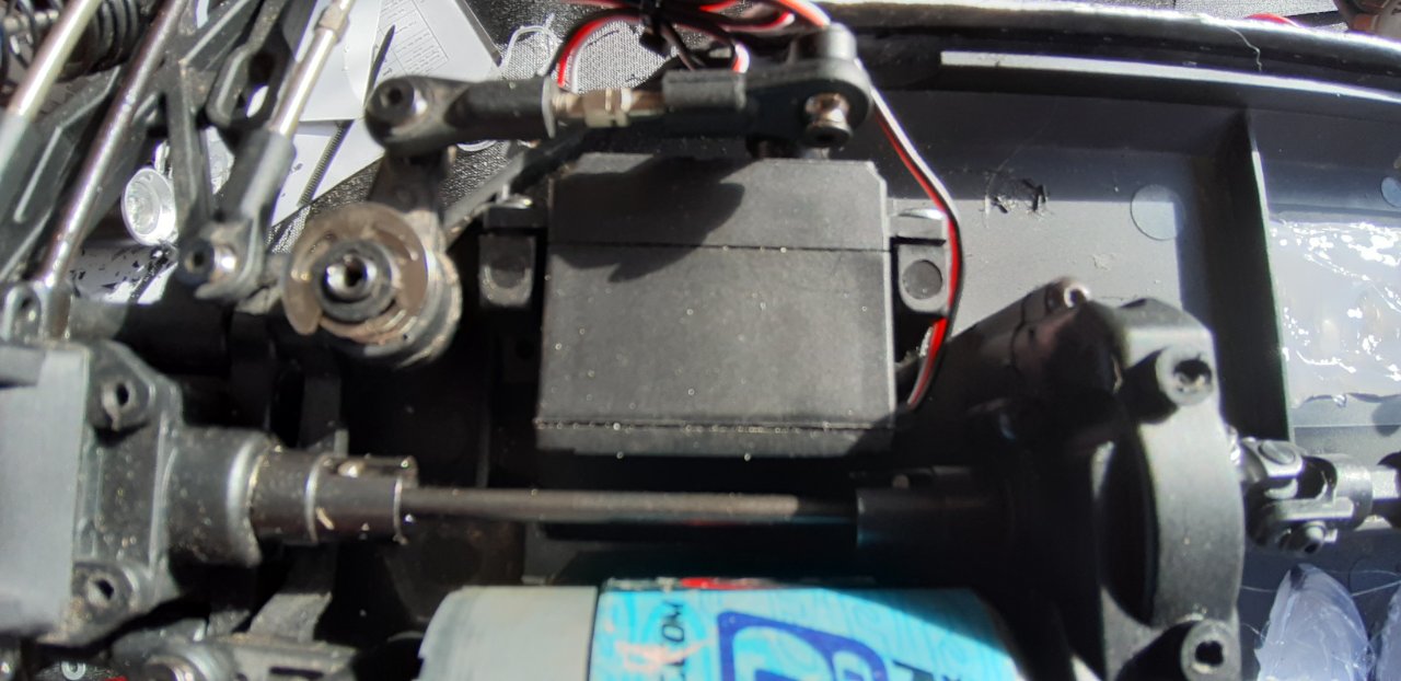

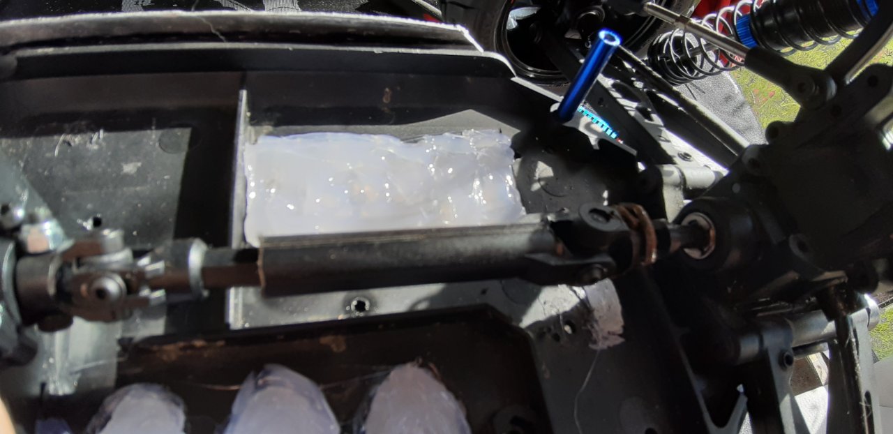

Hi all well the last cupl weeks iv been playing with a spare carnage chassis  just after my daughter snapped  my carnage chassis  and a big thanks to  jens for the replacement.  I won a rolling shell off Ebay so I thought ok one spare   till it arrived .
Full of holes. (Which are supposte to be there)  so I thought I can do somthing with this .
So i did  i have put an outlaw drive in the carnage chassis . And once i buy another complete transmission (about £20 complete)  i will be adding it to the rear  drive   so I'll have two motors running my carnage.
Here's the one motor set up .
