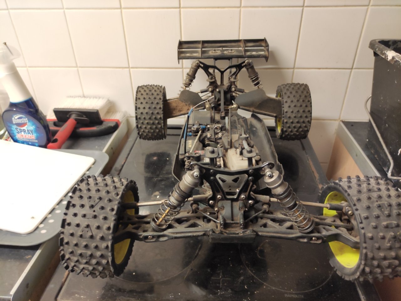

Hi all,
I have been off the rc sceen for years n years, and i am haveing problems with monting my ninja jx21 bo2 on my losi 2.0 truggy and also the cluch bell need replaceing i think and new engine bearing and a clitch bell that fits on turggys spur gear any help would be much aprecated and where the best place is to get the bearing puller and bearings , bit of a project getting it back working again hence while its been sitting for so long. thanks for taking the time to read my post.
