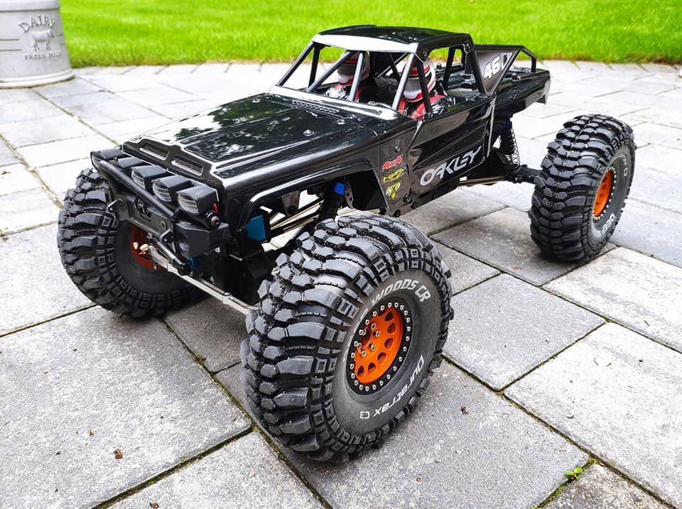

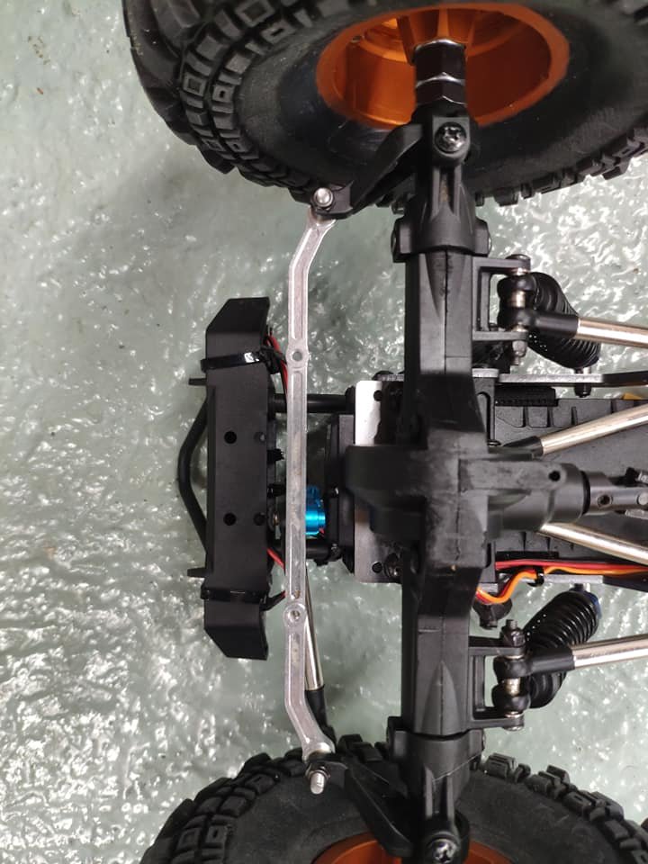

And here it is fitted to my Mauler.  I removed the bump stops, replaced the 2 front screws with countersunk ones and fitted this link.  Sorted out the steering good and proper.
