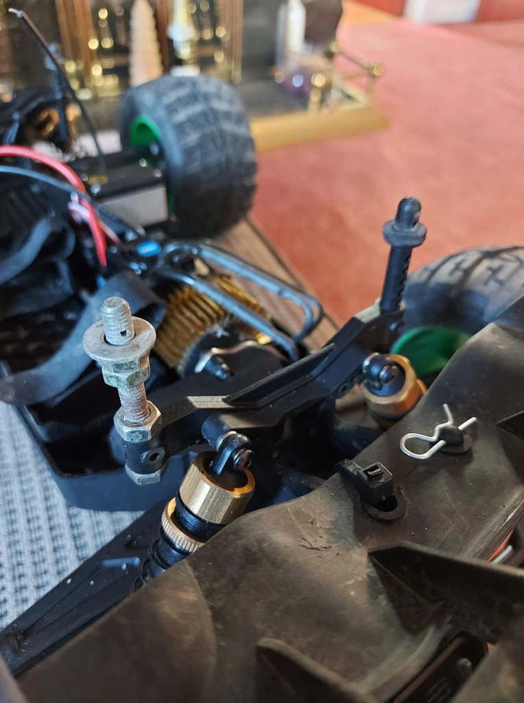

Seminole81 Posted April 5, 2021 Share Posted April 5, 2021 (edited) 18 minutes ago, mmrr said: Thanks guys. @James.S yeah speed is definitely not king with this car. @Seminole81 I have the same problem. Broken post but no stock anywhere. I attempted to buy some from eBay but that was a waste of time and money. Next step, Araldite🤷♂️. I swapped the posts around so the glued joint was within the post holder assuming it might have more strength but it still broke again quite quickly. I spent most of my time out today with the front corner of my lid flapping around, but did not detract from the fun. The search for metal posts continues😉 Let me know if you find anything. Luckily our broken posts are both on the back 😂 I tell you what I did see. Someone made some out of a few nuts, a washer, and a M6 x 50mm bolt. Might be an option. Edited April 5, 2021 by Seminole81 Quote Link to comment Share on other sites More sharing options...
mmrr Posted April 5, 2021 Author Share Posted April 5, 2021 I could probably do that for now. Although it might be a bit difficult drilling through the thread for the body clip without a drill press and clamp. If I can though I might just make four and use them permanently. My broken post was on the back originally, but as the front sits lower in the mount, I tried to swap them under the illusion that if the glued break/joint was hidden inside the mount just above the screw it might not break again as easily as if it were above the mount. Quote Link to comment Share on other sites More sharing options...

Seminole81 Posted April 5, 2021 Share Posted April 5, 2021 (edited) 15 minutes ago, mmrr said: I could probably do that for now. Although it might be a bit difficult drilling through the thread for the body clip without a drill press and clamp. If I can though I might just make four and use them permanently. My broken post was on the back originally, but as the front sits lower in the mount, I tried to swap them under the illusion that if the glued break/joint was hidden inside the mount just above the screw it might not break again as easily as if it were above the mount. Could just use another nut potentially instead of the little body clip (lost those in the field 😅) EDIT: Will move over to owner’s thread now. Edited April 5, 2021 by Seminole81 Didn’t see MOD post 1 Quote Link to comment Share on other sites More sharing options...
