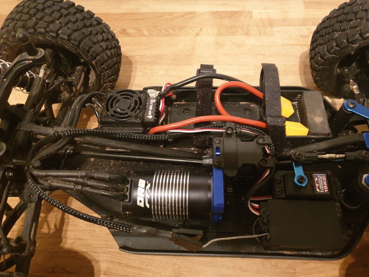

Started tidying up the cabling with some braid. Lighting done, esc next. No real reason other than it will look cool when finished.

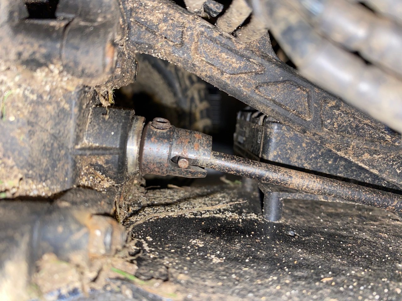

The stub doesn't fully go in and the grub screw is only ever going to get half the shaft, so maybe something isn't right.
Should the bearing on the rear diff fall out easy?    it's loose and even pushed in, that is stopping the cup going over more than about 5mm, so i wonder if the bearing needs to go in further?
You can see the bearing and the short stub in the pic above, does that look right?  does your cups fully insert onto the stub?  or same as mine?

The bearing should be in flush to the case then the cup up against it like in my Previous pic
Afternoon,
I took the bearing out, cleaned it and the hole it came from and refitted using a few taps of a hammer to get it flush, refitted and that's sorted it right out, loads more shaft to grab onto!
