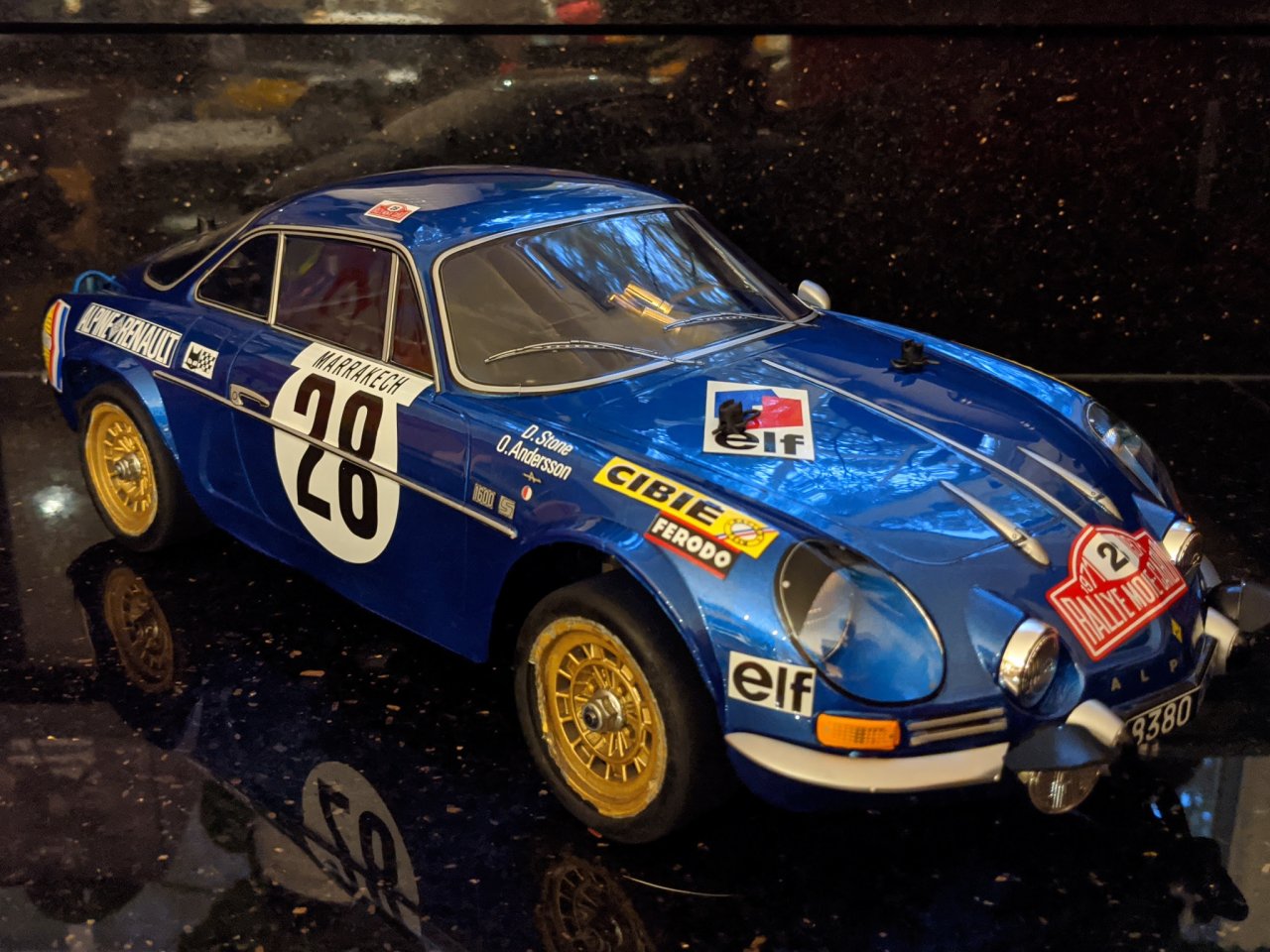

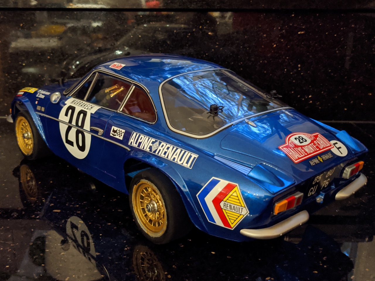

Here's a body I've just finished using this process.
I don't consider myself an expert by any means, I'm happy with what I've managed but there are a few little mistakes, small enough to live with.
