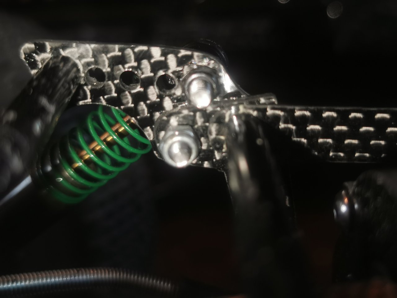

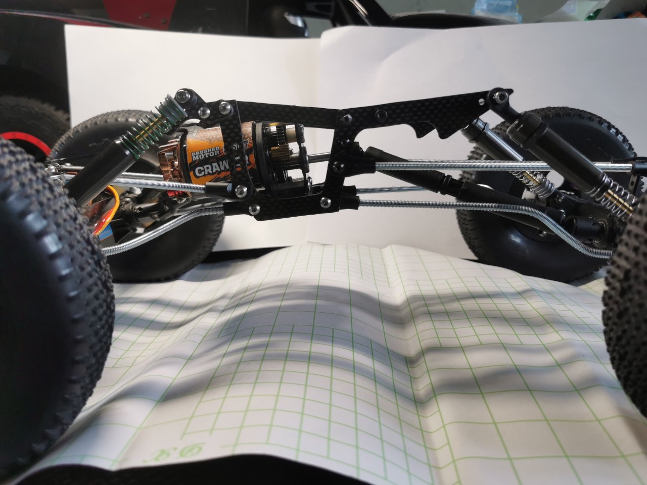

Hell horn. Posted April 11, 2021 Author Share Posted April 11, 2021 Been adjusting it again. More making a massive mess. Ha. Only part I'm still not keen on is the rear shock mounts. Still looks wrong. But I think half because I'm using shocks that are way to long. Might get some cheap 90mm ones to test fit before try and find some 2660 shocks. 1 Quote Link to comment Share on other sites More sharing options...

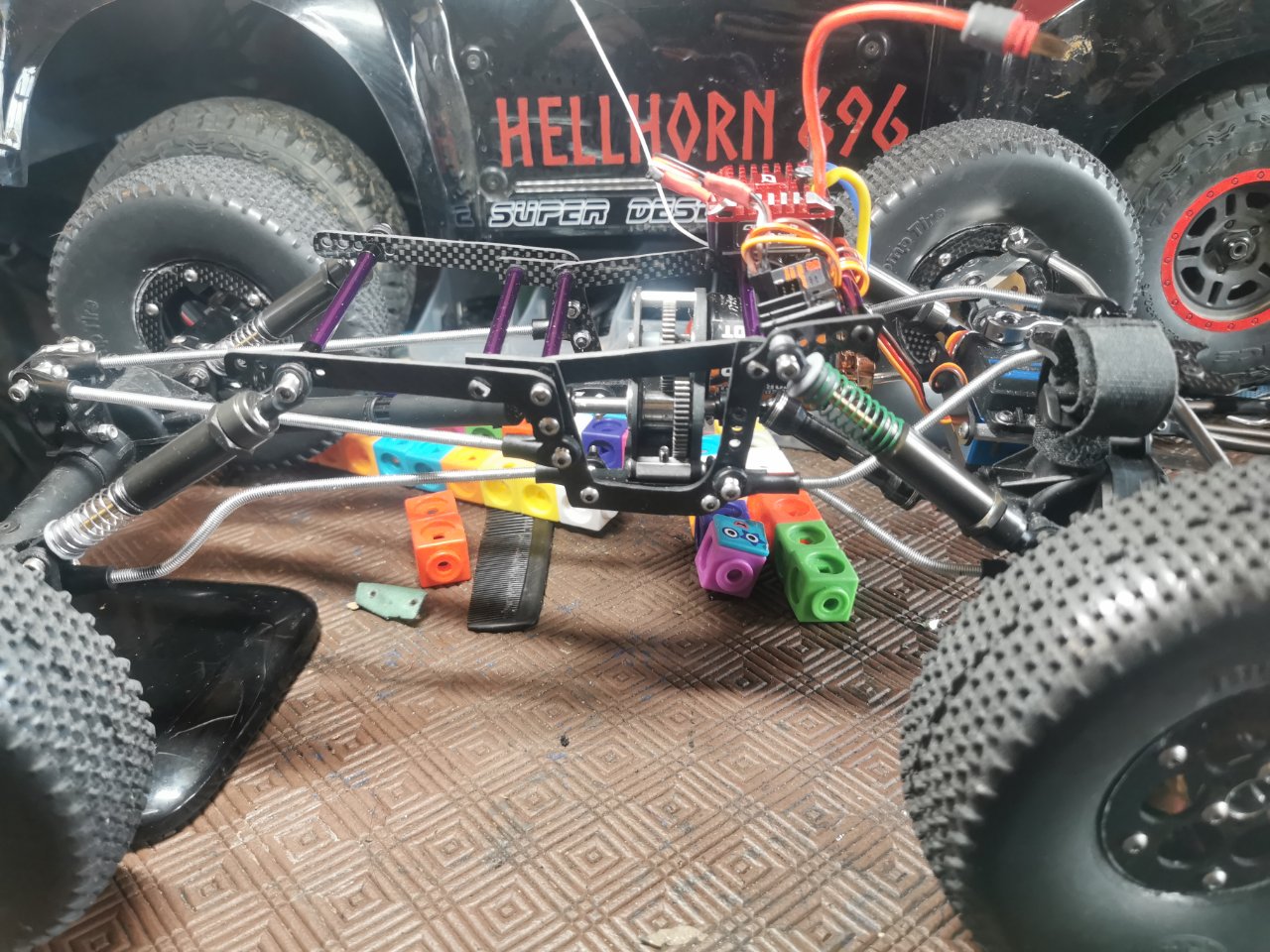

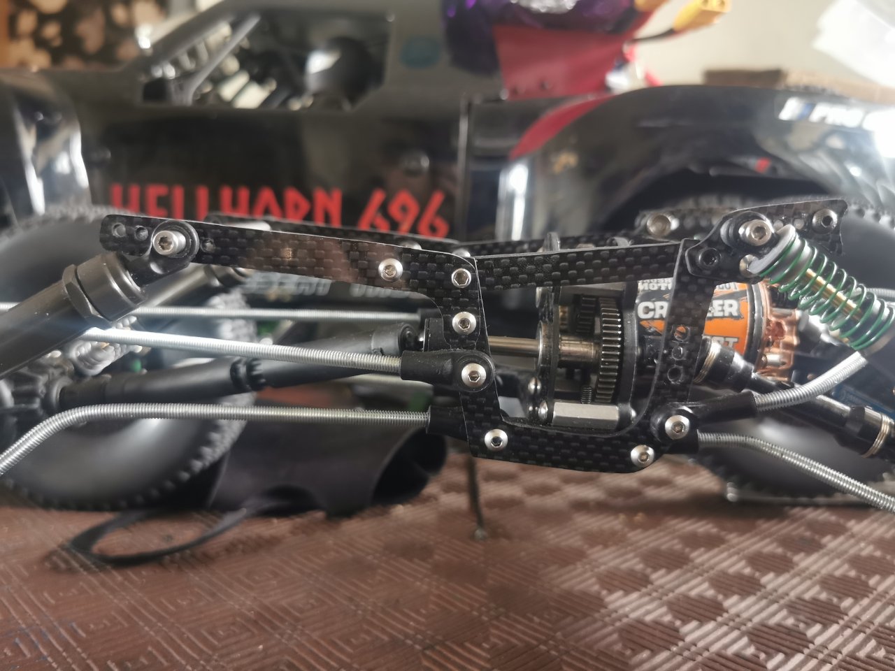

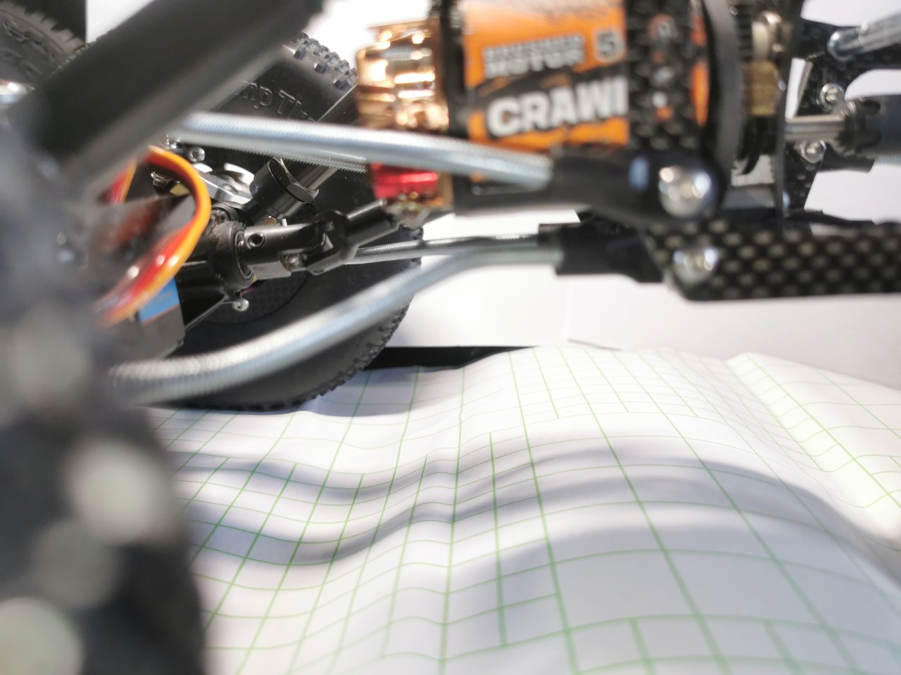

Hell horn. Posted April 12, 2021 Author Share Posted April 12, 2021 So even more messing around with it. Even closer to being spot on. Flipped rear axle over so the drive shaft clears the links at full drop. All works well now. Rear shock mounts are sorted. Looks nice now. Tempted to see if I can find a. Centre rear axle for it. See how that works on it. Might be better then the ar60s off set. Getting there with it now. Next version will have slightly different rear link mount points to work better. Quote Link to comment Share on other sites More sharing options...

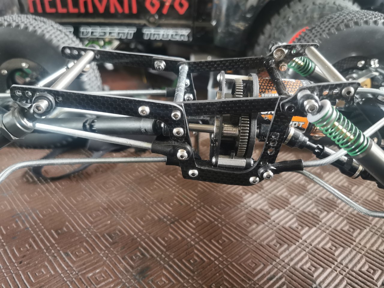

Hell horn. Posted April 17, 2021 Author Share Posted April 17, 2021 So then. Updated the chassis style. Forward motor mount now. Love the general look now. And the feel of it. But got to make a few changes to it still. Next version we will getting very close to being finished I think. Then I can get some nice shinny parts for it . Custom links needed for the rear end. Need to make a new sump for it. And finish of the shock mounts as I'm not 100% on how they are now. 1 Quote Link to comment Share on other sites More sharing options...

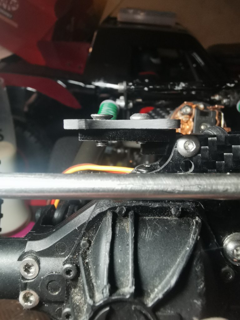

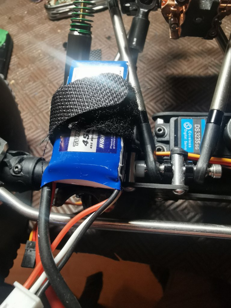

Hell horn. Posted April 17, 2021 Author Share Posted April 17, 2021 Made a battery mount for it tonight. Its a dig servo mount from a capra. Works spot on. Small bit of carbon bolted to it. Just need to counter sink the holes now. 2 Quote Link to comment Share on other sites More sharing options...

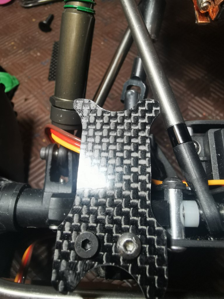

Hell horn. Posted April 21, 2021 Author Share Posted April 21, 2021 Right. More progress on my chassis project. Remade the front shock mounts. Much better this time. Getting very close to this being finished now. Almost time to test it out. Temp links made up. Work well. General look of the chassis sorted. Got to mess with front axle roll still to get it right. 1 Quote Link to comment Share on other sites More sharing options...

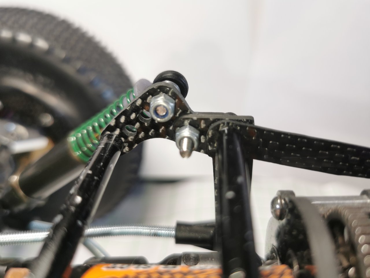

Hell horn. Posted April 23, 2021 Author Share Posted April 23, 2021 Closer closer closer. Almost so almost right. Need the few bits to arrive so I can test it. Redid the front shock mounts. Best ones yet. Slight tweeks needed on the chassis and sump. Need my parts being delivered now 1 1 Quote Link to comment Share on other sites More sharing options...

Hell horn. Posted April 28, 2021 Author Share Posted April 28, 2021 And more done. This time front shock mounts. Finished. Tomorrow it's time for rear ones to be redone. And then see about the Main chassis redone to. Used an old chassis to get shock mount holes lined up. Getting there Quote Link to comment Share on other sites More sharing options...

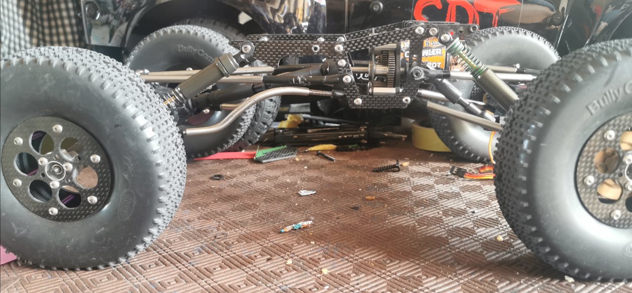

Popular Post Hell horn. Posted April 29, 2021 Author Popular Post Share Posted April 29, 2021 And Mark 5.5 is done. So very close now. This is now just waiting for parts so I can test it. 3rd set of drive shafts I have ordered and gone missing. Taking the **** now. Lol. Once I have them I can get it set up and see if it works 4 Quote Link to comment Share on other sites More sharing options...
