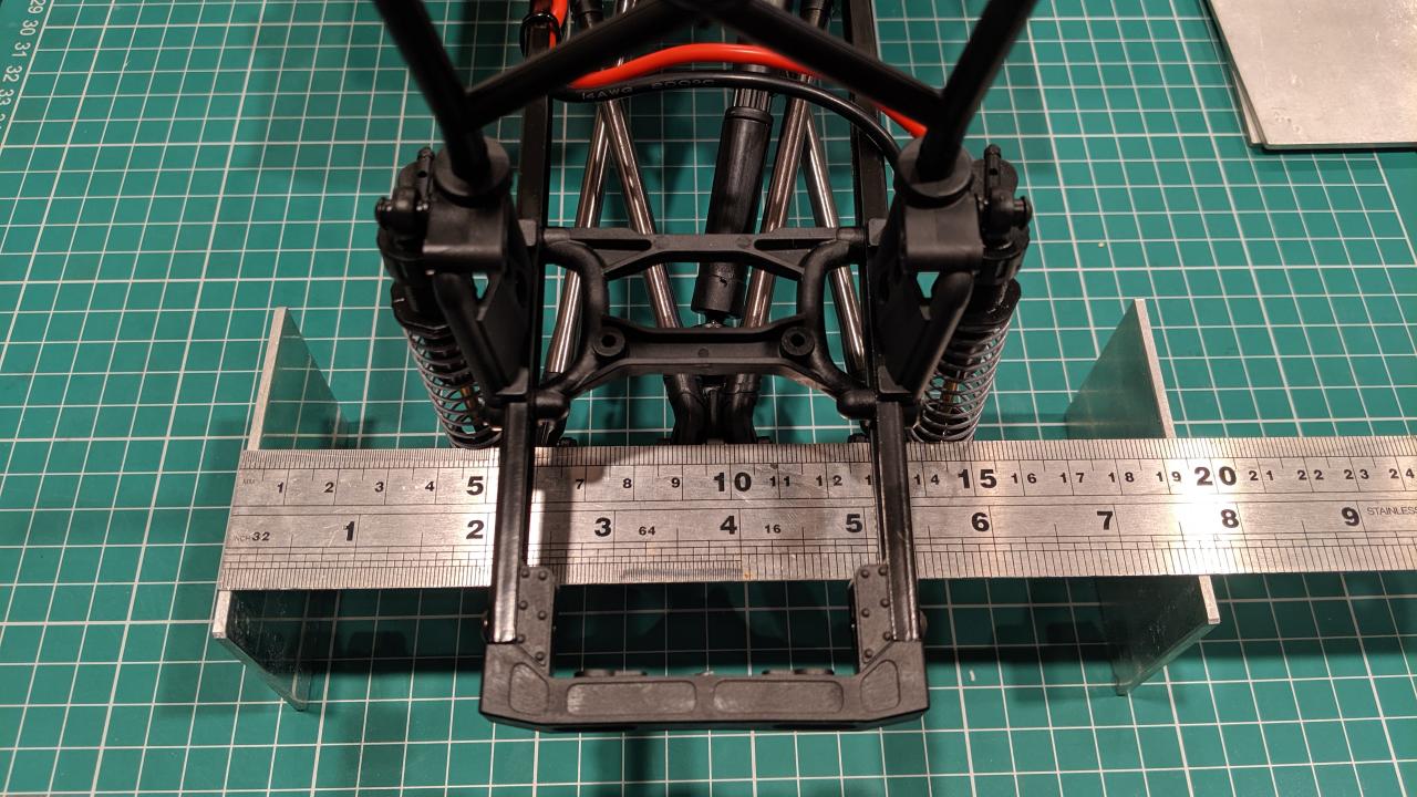

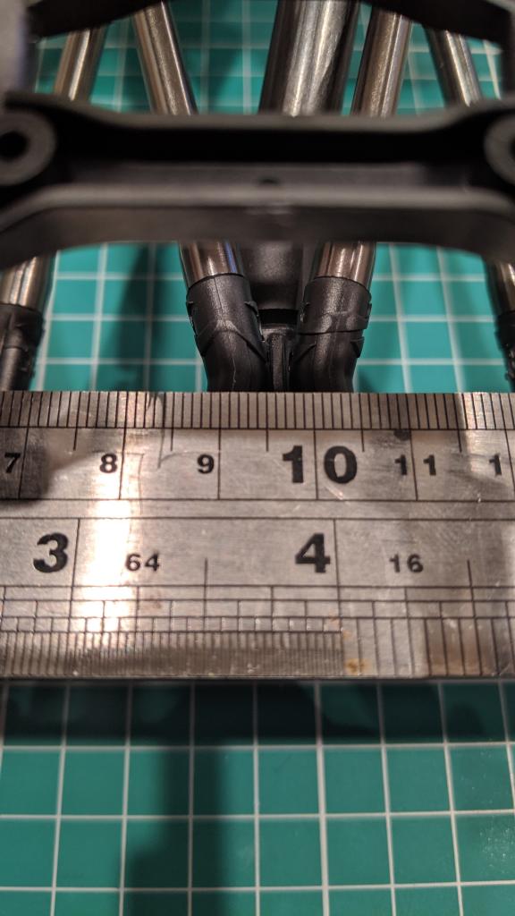

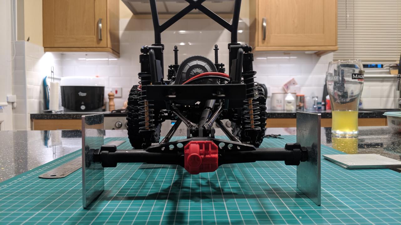

OK, so from the images above. Total width of the rear to the outside edges of the aluminium plates measures at 19.5cm. In this scenario the centre line will be 9.75cm. As you can see the centre of the axle above the diff comes in pretty much bang on 9.75cm. The chassis however doesnt. It would appear that the upper/chassis is "twisted" or out of line.
Things to note, the aluminium plates are at complete right angles as can be seen below.
Measurements from the outside edge of the chassis rails to the inside edge of the plates on the LHS is 56/57mm and on the RHS is 62/63mm
Edited by hardc0re_tid
Finally, i have managed to cure the problem, the upper left rear link end was on a tad too loose, tightened it up a full rotation and it pulled the rear end of the chassis over more, still not enough to satisfy me mind you. I then looked at the rear right upper link and decided to loosen the link end one full rotation, this has fixed the problem to where I am happy. Rather than put a washer in place between the link end and the link itself i turned to using a 94mm link on the rear right upper instead of the stated 93mm link.
