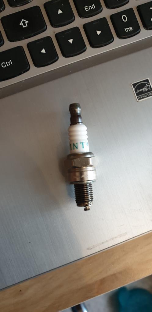

Hi everyone fitted two 3 channel switchblade v2 's this week one worked first time faultlessly.
The second really tried me as it would arm , car would fire then would kill the engine. In the end after changing the manual kill switch , swapping over the other set of kill switch from the other car ( this suffered the same issue on this engine). I emailed rc models , the engine was a Fuellie engine with a none branded plug they asked what plug was being used , I went up my workshop fitted an NGK and Eurica 2 nights of head scratching was forgotten.
See cheap plugs
It seems the cheap chinese plug was causing interference! Thanks RCMODELZ 😉
