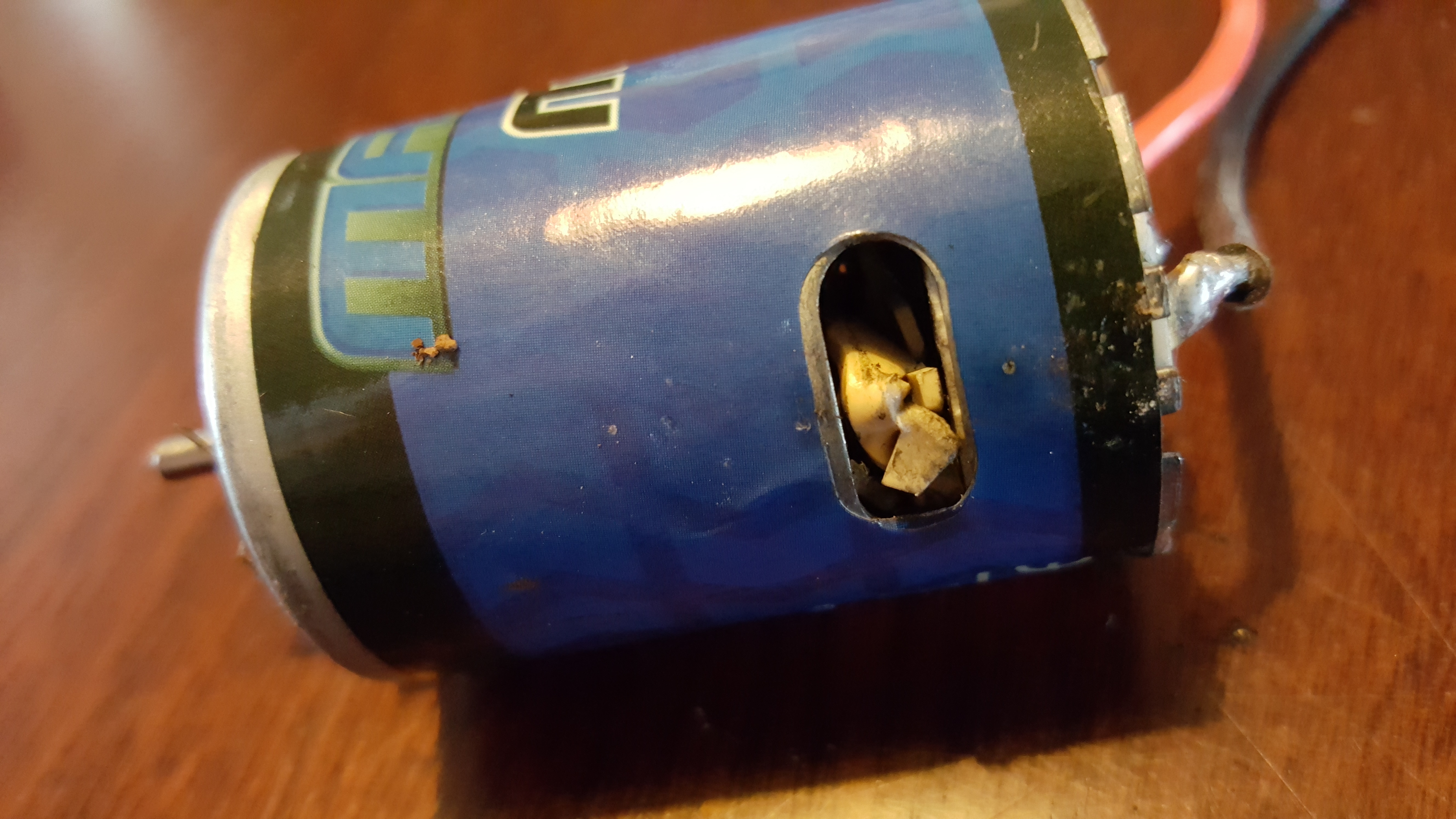

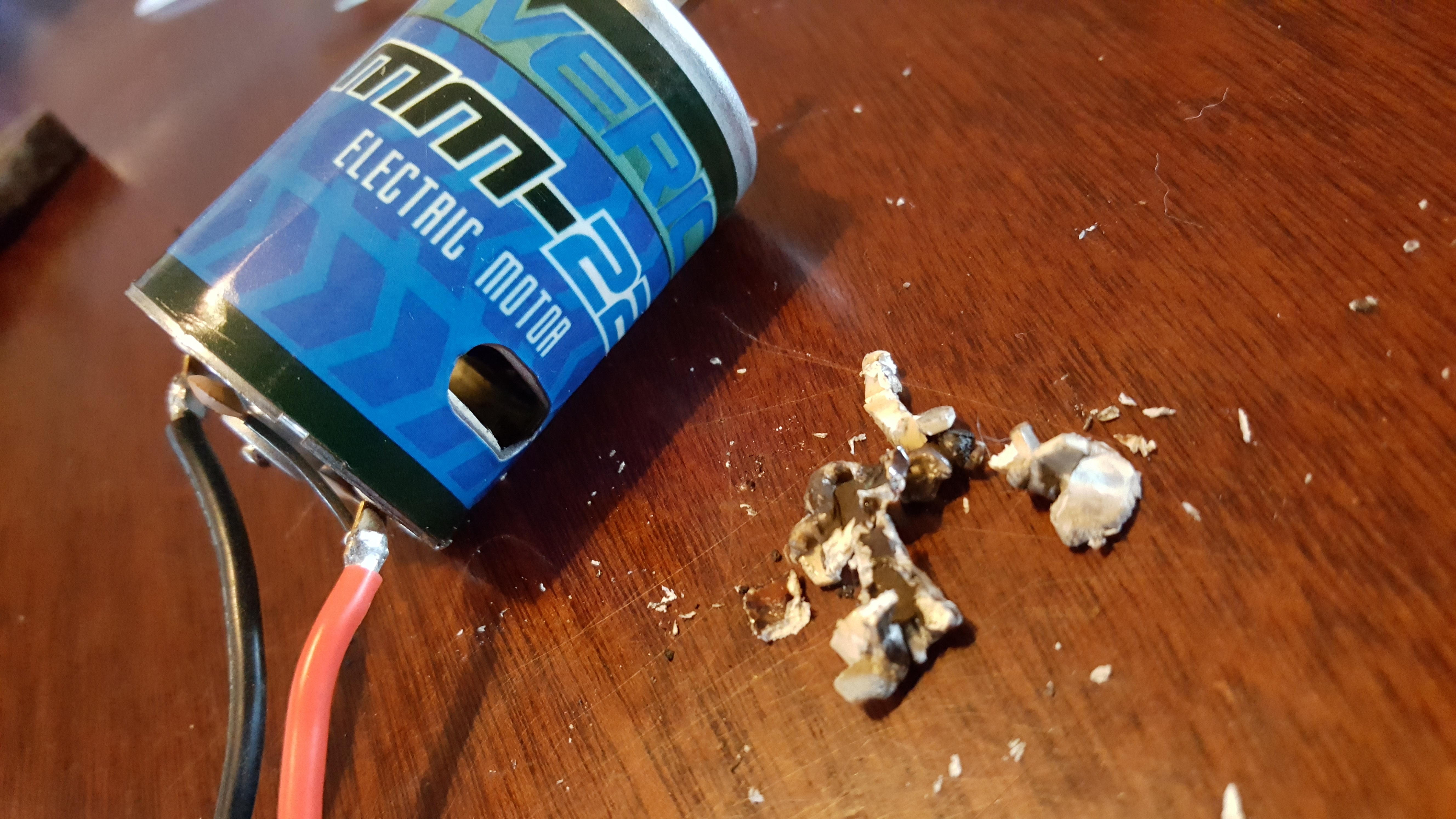

Took the motor out and found that the fan inside has melted, managed to get it out....  goodness knows where the rest of it is.  The wheels turn easier now with the new bearings that came with the upgraded parts we put on it.  I can't feel any resistance with it -

No problem, I'll dig through later and see what's left.  That fan def melted?  I ask as usually when mini me overheats a brushed motor the little resistor will unsolder itself long before anything else - I wonder if you had a piece of grit get inside?

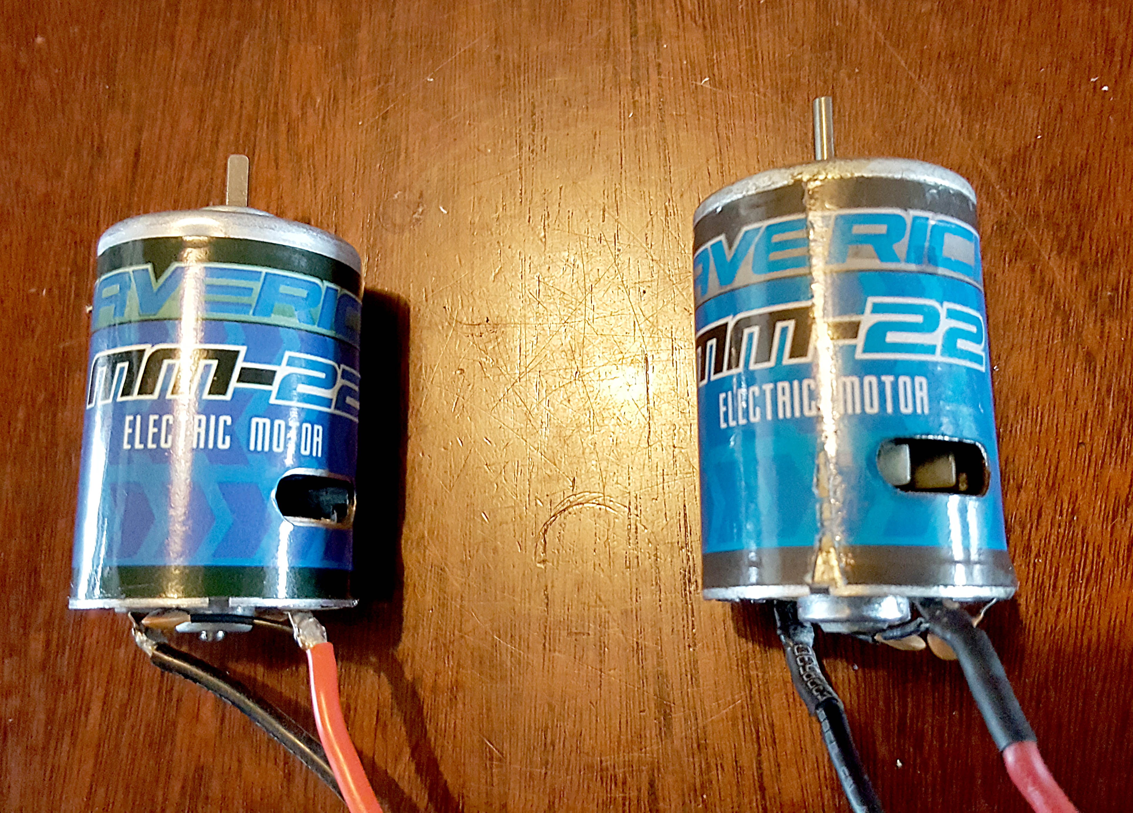

I would say so yeah, unless it didn't have one in the first place....  you can see in the photo the original motor which still has the fan, the newer one on the left hasn't.
