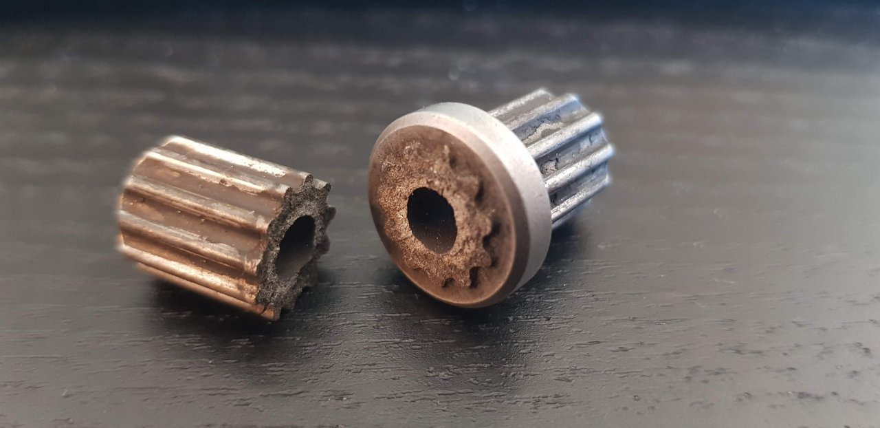

I have the same problem with overheating. Im running stock gearing. One of the first things you must upgrade in X Maxx is ESC. Ill be getting MAX6 next month. Cheers!
P.S. am i the only one who broke this?!
I dont even know where that part is haha
😄 one end goes to center driveshaft and the other to center diff (so when it breaks you end up with RWD X Maxx). It is very strange that it broke - front wheels do not get such an abuse as rear ones.... And what is even stranger that you cant buy it alone - it is sold as a part of center driveshaft.... I haven't seen any "upgrades" for it so i guess they do not break that often... I hope it was just a defect... Prior to breaking it i changed diff oil (30k front/50k back/ 20mil center) - i hope that's unrelated..
