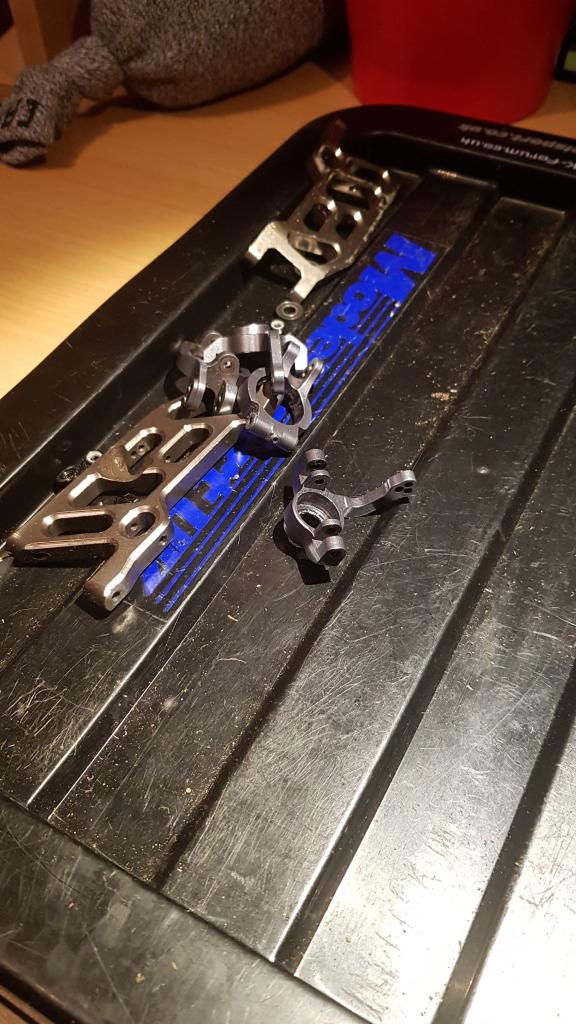

Just found out the hard way gpm parts and vanquish parts don't work together, specifically the vanquish front hubs and gpm arms, so back on went the plastic axial arms! Don't tell gpm but the plastic ones are better?
And the reason for the swap, excessive ware in the knuckles and hubs also found ware in the rear pivot fixing, too soft a material me thinks!!!

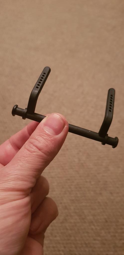

In the rtr yeti it's just an unused part and comes in the odd bits bag.
Thank you for the info, I am trying to mount the yeti cage on my slash. Would you happen to have the bit still? would like to buy it from you if so
I do if you pm your address I'll send it.
