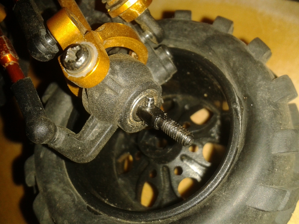

bosq Posted March 2, 2015 Share Posted March 2, 2015 (edited) Yes in stock - original axles. In this way I can use both original and upgrade wheels. Edited March 2, 2015 by bosq Quote Link to comment Share on other sites More sharing options...
-Rune Posted March 3, 2015 Share Posted March 3, 2015 Thanks Then it becomes rebuilding of car here pretty soon, just to book themselves sharing Is it 12mm hex you use? Quote Link to comment Share on other sites More sharing options...
bosq Posted March 3, 2015 Share Posted March 3, 2015 No, I think its kinda smaller : http://www.hobbyking.com/hobbyking/store/uh_viewItem.asp?idProduct=21681 If you want 12mm I saw this post: http://www.ultimaterc.com/forums/showthread.php?t=157554&page=31&p=1735784 Quote Link to comment Share on other sites More sharing options...
bosq Posted March 9, 2015 Share Posted March 9, 2015 (edited) The new problem appeared... this wheels are much more demending for the servo - 2.1kg servo is too weak - already broken 2 pcs (I use alu servo saver now - it keeps stronger forces before unclutching - this might also be a reason). Waiting for 3.5kg servo. ---------- my oh my - I've found beatiful servo: I have 6V BEC so it works great. http://hobbyking.com/hobbyking/store/uh_viewItem.asp?idProduct=47620 Perfect fit and amazingly good maneuvrability of the car - at last. Edited March 22, 2015 by bosq Quote Link to comment Share on other sites More sharing options...
