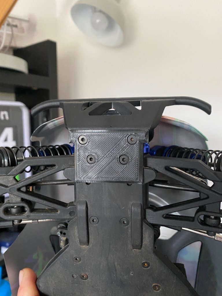

Worked a treat! Haven’t tested it yet, so not sure if it will last, but if I have an accident with another hidden tree stump at full throttle I doubt anything would stand up to it. For now, both cars are good to go again, thanks to a local 3D printer service.

Thingiverse and other 3D databases are a good resource for solutions of known problems.
What I dislike a bit is that the plate covers 2 screws which hold the Diff.
Removing the front diff will be now a bit more work.
But I think the design of the plate can be changed.
If not, a knife will do the job..

Actually, the diff housing screws aren’t covered, they are replaced with slightly longer screws that go through the repair plate and into the original holes. No extra work other than a couple of extra turns on the screwdriver.
ive fitted this to both cars, even though one was not damaged, as the extra reinforcement will only help, I think/hope.
You are right.
My statement was based on the pictures and I was wrong.
After checking the car only the 2 alignment pins are covered.
