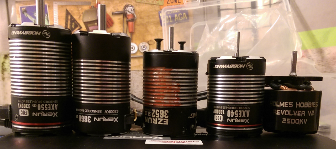

@DavidBH Hobbywing max10 or Castle sidewinder 4 combo with 3200 - 4000kv motor, higher kv more speed less torque. Castle have much better modulation and programming, hobbywing are bomb proof.  (I tend to go for lower kv as you can always pinion up and volt up)
This is why i cringe a little when i see anyone recommend a cheap brushless combo. They are good for a little while then die leaving you with a dead truck and no fun.
Here are some motor sizes the max 10 with 3652  sits nicely in the middle, anything longer would need the chassis cutting.
You really do get what you pay for with motors and esc's ive found and they are worth the investment. 🙂
I have the 3652. Fits perfectly.
