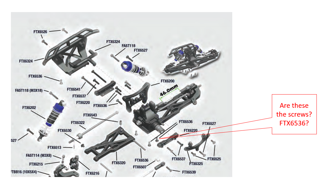

Hi Lenny(?)
I  would appear to have done the same thing on my first run (hit a low kerb).
This is my first car and I was always expecting to do some running repairs - but replacing the whole chassis does feel a bit scary, so I think I will try this first. (and I like the idea that it would be a replacebale part).
If I may ask a couple of basic questions.
I think from the pictures  below I would need to use the 4 screws as indicated. I also think that from the exploded picture these are FTX6536.  - Flat head screws 3*10. Now for the stupid question - I'm guessing I'd need to replace these screws with something a little longer - 3*12? And the next stupid question - is it important that these are FTX? I'm guessing a screw is a screw, but since I need to order these I'd prefer to know I'm getting the right thing, rather than trial and error.
Thanks in advance
Steve

Hi  I just fitted a wheelie bar to my carnage  and there was new screws in there to use as i   (like you ) thought need longer screws  but no the ones that can with the wheelie bar was the same ones in the carnage already.
So i would say  no the ones you have should be ok BUT DONT TAKE MY WORD FOR IT lol .

Hi Steve,
The honest answer is I don't know!
I fitted that bumper this way a couple of years ago and don't remember it causing me any hassle so I presume I fitted it with the original screws.
If you're going to fit it to the front of a plastic chassis then you're going to have to cut it down to go around those raised sections too but that should be easy enough.
A screw is a screw and mine has a collection of various M3 screws from various sources nowadays as it's been apart many, many times. I've found the FTX screws to be a bit rubbish and the hex easily rounds off so I'd rather replace them all with something else if I had the choice. (If you do manage to round one off then it's possible to tap a appropriately sized torx/spline into the hole to get the screw out.)

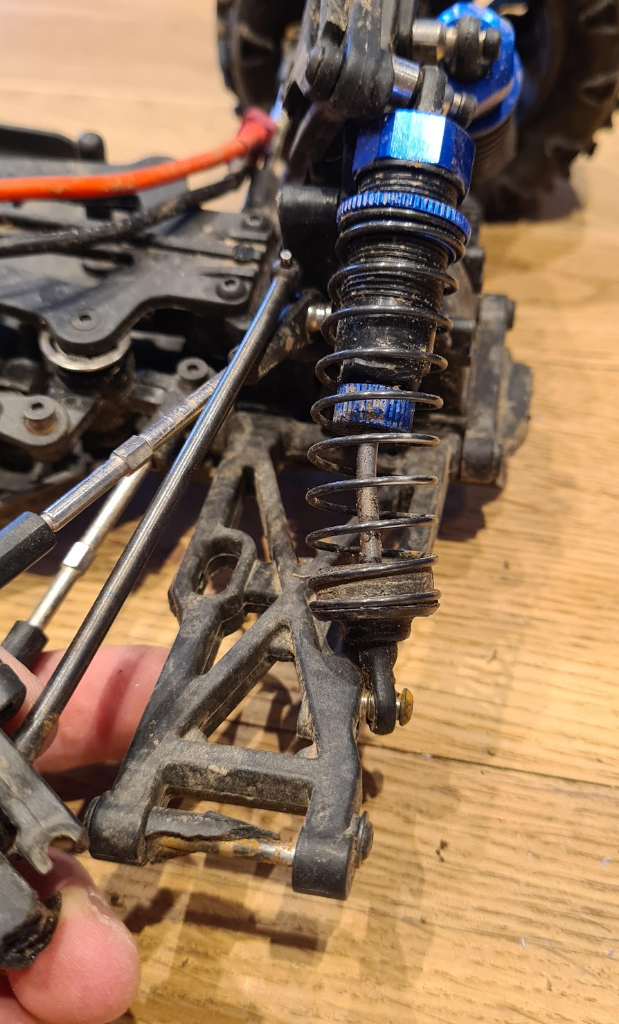

as my daughter crashed my carnage last week in to a curb  ripped the front wheel off . (Just had the email parts been shipped ) so  did you manage to repair it or is it off the road ..
Edited by Iain .R
I think it's all brilliant.
I never expected to enjoy fixing it more than driving it but at least that means I don't worry about smashing it nowadays.
I can't begin to imagine how many broken front suspension arms I've had (but thankfully none since I put the aluminium ones on).
I reckon I could change an arm in less than five minutes now after all the practise I've had!

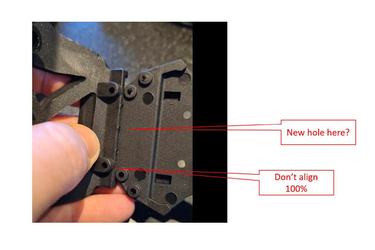

Hi Lenny
It looks like the fixing holes on the bumper dont align with the extention piece. How did you solve that? I'm thinking I might drill a new hole and use a nut/bolt (I dont think I can tap a hole)
Thanks in advance
