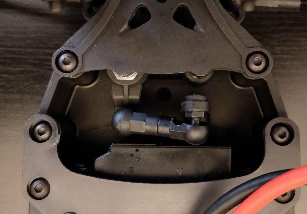

This photo doesn't show it very well but if you look at the quadrant which I think is also the servo saver, it's straight and therefore so is the steering. But (again it's not clear in the photo) the horn is off centre. It's leaning to the left of the picture.

Ok so the servo is in and working great. But it will probably be coming out again. I probably should have gone with my hunch but would be interested on the thoughts of everyone else....
I was told on the phone to centre the servo to line up the horn vertically. The problem is when the steering is centred on all three cars the horn is actually off centre itself. So my intent was to install one tooth from 12 o'clock. But I didn't. I was hoping there would be enough play in the servo adaptors to slide the servo sideways to compensate.
Now it's all in, to get the car to run straight I have to apply quite a bit of trim on the transmitter. And the transmitter will trim the wheels much more one way compared to the other.
I just wondered what everyone else does when replacing a servo on a Firestorm.
Cheers.
Your first instinct was correct, slightly off centre.
4 minutes ago, JamboV6 said:
You can pop off that turnbuckle (the connecting rod between the horn and servo saver arm) and lengthen it slightly that will compensate for the offset
Can I? I did wonder that as it looks like it's done up tight and wasn't sure whether it was there for adjustment.
Yeah, but I'd unscrew it fully first and just check the length of the thread as it's quite short. One full turn should give you the adjustment you need, if you need any more you might need to swap the screw inside to a longer one first.

If I'm going to pop the turnbuckle off I may as well just take the servo out again and move the horn one spline.
The screw supplied with the servo is different to the one fitted at the factory. It has a much coarser thread and a Philips head. I used it as the thread was already cut in the servo shaft and I didn't want to risk stripping it. The thread is probably more suited to nylon to be honest. So the servo has to come out to get on the head with as screwdriver.
25 minutes ago, JamboV6 said:
Sorry I was referring to the screw thread inside the turnbuckle, it is two ball cups, one either end with a grubscrew connecting them.
Yeah I knew what you meant. Was just making the point about the screw as not sure why they would be different. The shaft on the new servo is a different material as its grey and seems a little harder.
Adjusted the horn earlier. It's better but because I slid the servo itself over earlier on the side adapters to compensate it's gone a little the other way now. But it's good enough and I am able to trim sufficiently in both directions using the transmitter. Just more one way than the other.
