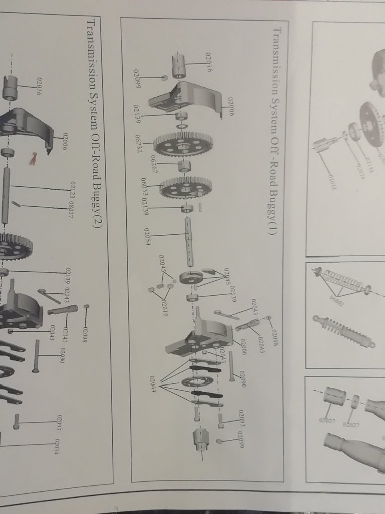

To what I can see I can't see a slipper clutch just a 2 speed drive clutch are they the same thing I'm not sure see picIMG_20231210_114705.thumb.jpg.8ef947d8c08ab7e242ac7d126252ef68.jpg
No, they are completely different things for different purposes. A 2 speed setup like that uses a one-way bearing setup to split drive between the 2 sputr gears based on how fast it's spinning.
It is a possible issue for you car, but we are really just guessing. This is not a model I have ever seen, and I can;t even find pictures of whats under the shell. Himoto don;t even seem to list it as a current model. Which is no help.
