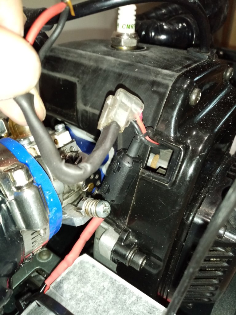

When you had you're bump did the engine stop and not get restarted? Check the engine compression you could've pooped the ring! I highly doubt there is any issue with the carb as its technically over fueling which could also cause the engine to flood. The kill swith on the engine just take it off completely. It works in the way the when the circuit is open the engine will fire, if the circuit complete or close then engine will not fire. I put a pic of my killswitch! I just have bare wires. As it is now it will start. If I connect the wires the engine won't start.

If you remove the switch on the engine completely the engine will still  run, By pressing the switch it completes the circuit to ground the coil and kill the spark. The switchblade is just another switch to do the job remotely with a few extras added into it ie LVC and signal loss circuits. To me it sounds like a faulty switch.  Try start engine with no switch connected. But be prepared to pull the plug cap off to stop the engine.
OK. I removed and electrically checked my kil swith... Permanently closed (in operation) so I bought an anti tamper style replacement (actually I had it lying around). Still no joy so I checked the open wires as shown in JD101s post. A short black and short red that went to the kill switch.
If I'm understanding it correctly the switch links these wires which ground the coil and kills the motor?
If that's correct then I'm in trouble as mine even spaced apart by 1cm are showing a connection with a multimeter. So where do these go and how do I get to them?
There just the wires off the motor kill button. My spring went in the button so I just cut it off. They go to the flywheel magneto thingy.
Yeah so if you're showing closed while open you must have a short on the kill button or the magneto or even possibly on the killswitch. Also check you're spark plug. I had a issue with power draining and it turned out to be a bad plug. Also if you've not got you're receiver and transmitter plugged in and on the switchblade if you got one it will keep the circuit closed!
