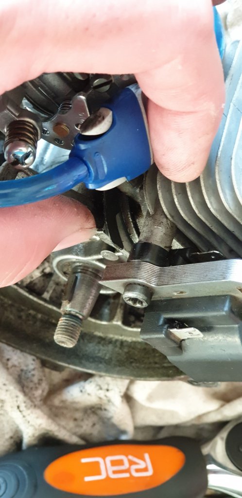

Mack1 Posted June 13, 2020 Share Posted June 13, 2020 Well the new carb didn't get much use today what so ever. Wasn't long before it started to play up with no apparent reason. Did notice a black gunge but nothing clicked. Got it home and started taking everything off. Soon found an answer though. Right by my thumb in the picture what looked like a gasket. Confirmed when I took the head off. I have now decided to strip off all the bits and change the crank gasket whilst I'm at it. Quote Link to comment Share on other sites More sharing options...

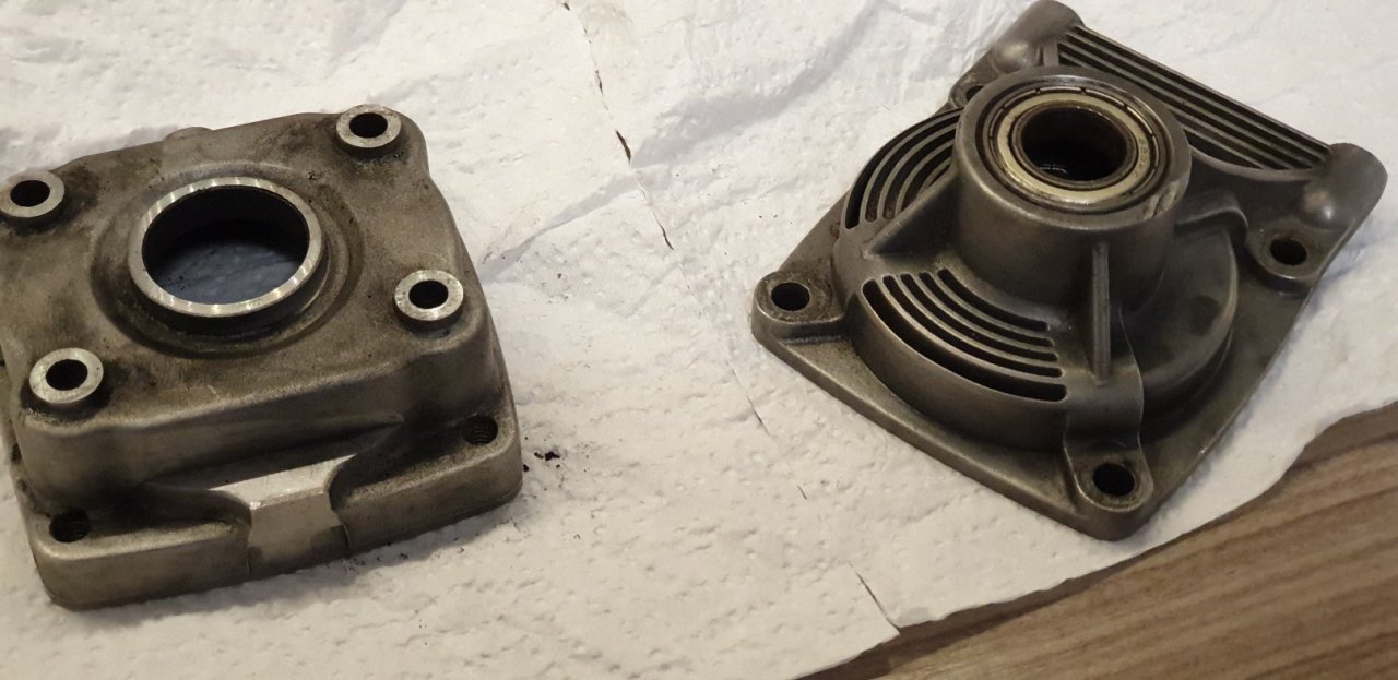

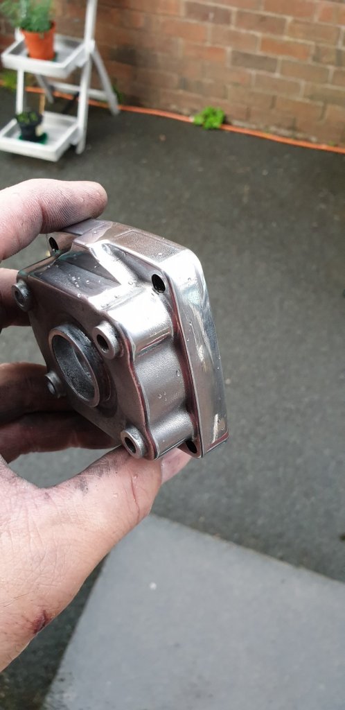

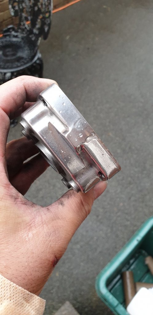

Mack1 Posted June 14, 2020 Author Share Posted June 14, 2020 Not done much today on the engine. Been to work so decided to do some polishing. Finished one part but still need to work on the other. Too many curves and after nearly breaking my hand when it stuck in the wheel I decided to leave it for a bit as the blood and pain stopped me from holding on to it for a while 🙄. Some before and after pics. 1 Quote Link to comment Share on other sites More sharing options...

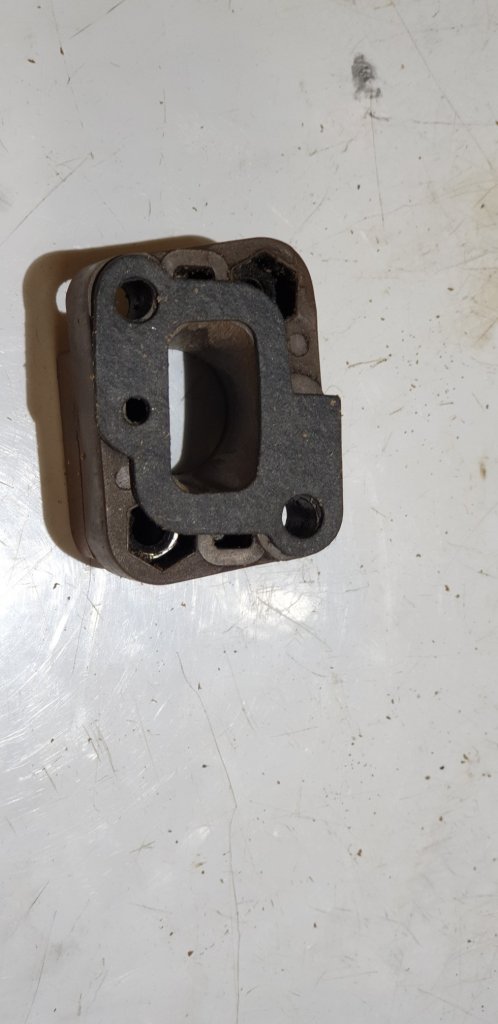

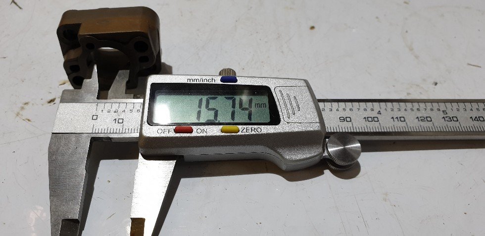

Mack1 Posted June 15, 2020 Author Share Posted June 15, 2020 Next on job list was to sort out the manifold insulator. The gasket was a perfect match to the bore of the barrel so the next obvious move was to make the insulator match the gasket. Then once that was done it was the same process for the new carb. Results were small but rewarding. 1 Quote Link to comment Share on other sites More sharing options...

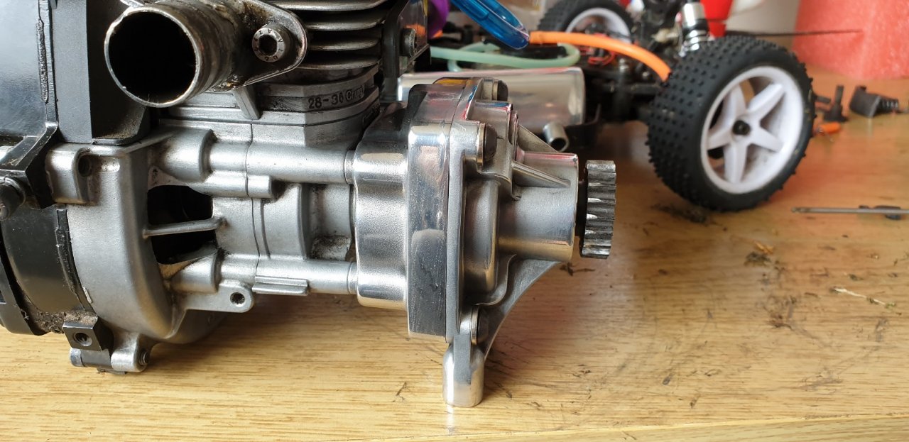

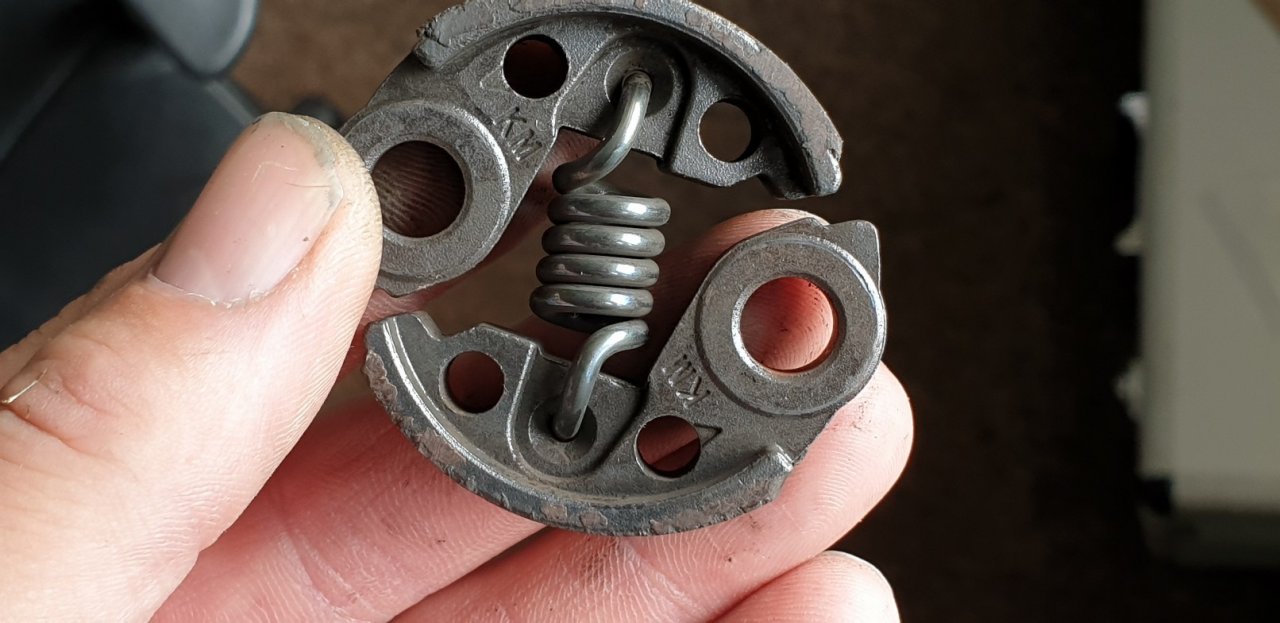

Mack1 Posted June 16, 2020 Author Share Posted June 16, 2020 Done some more polishing on the clutch carrier, tried with the polishing wheel on my dremel. Looks better up close but not perfect. Think I will leave it at that as I reckon within a week it will be caked in mud anyway. Whilst I was in the area I have ordered a new genuine losi clutch, not another KM clutch. As you can see in the second pic there is no lining left and the spring is so stretched it wont even hold the shoes together. 1 Quote Link to comment Share on other sites More sharing options...
.AJ. Posted June 16, 2020 Share Posted June 16, 2020 Port matching definitely makes a difference and the polished parts looks so much better than the rough casting 👍 1 Quote Link to comment Share on other sites More sharing options...

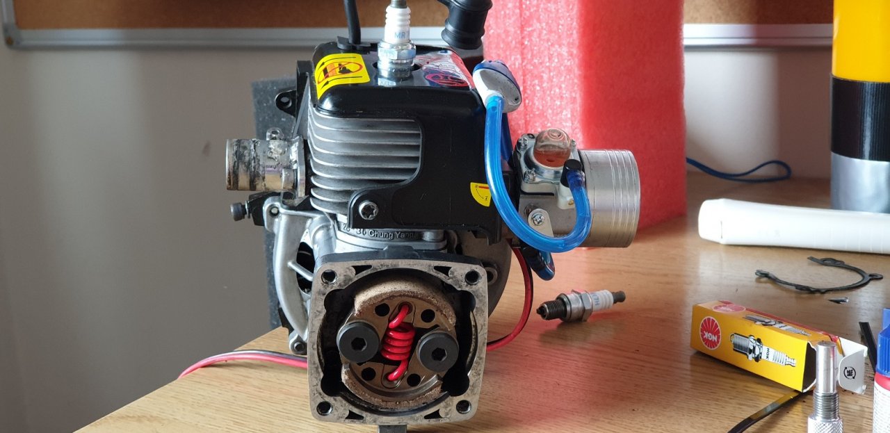

Mack1 Posted June 22, 2020 Author Share Posted June 22, 2020 New losi clutch arrived Saturday but working the weekend meant I couldn't fit it till today. Well now all is fitted and engine now back in the truck. Amazed at how quickly I got it to start, set the carb to OBR recommended setting then 4 to 5 primed pumps on the pull start then it started on first proper pull, only need to adjust the tickover. 1 Quote Link to comment Share on other sites More sharing options...
