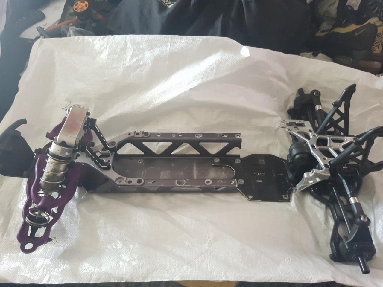

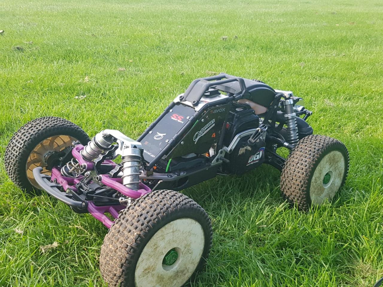

I've gone an decided to scratch build a shorty baja :ssh:
Owning KM T2000 an driven afew shortys an bajas found shorty to my liking. An seeing rovan Q shorty kit in action @bashfest eyeing up one of those ..^_^
Sourcing various parts from members here an wirhin few basher groups in an outlets Rc modelz,rcmax, irc etc...
Been 3 weeks so far rounding up bits an pieces when spring up an spare pennys allow...
Shocks where from one of my other cars but wasn't suited for it tbh gonna give an a rip on this build (in search for matching rear set)
Edited by R46

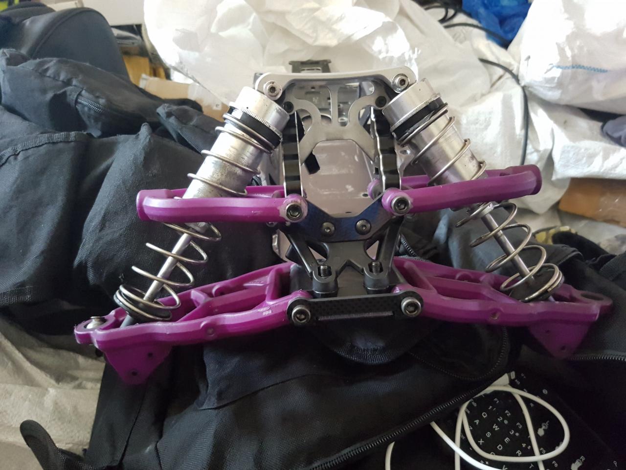

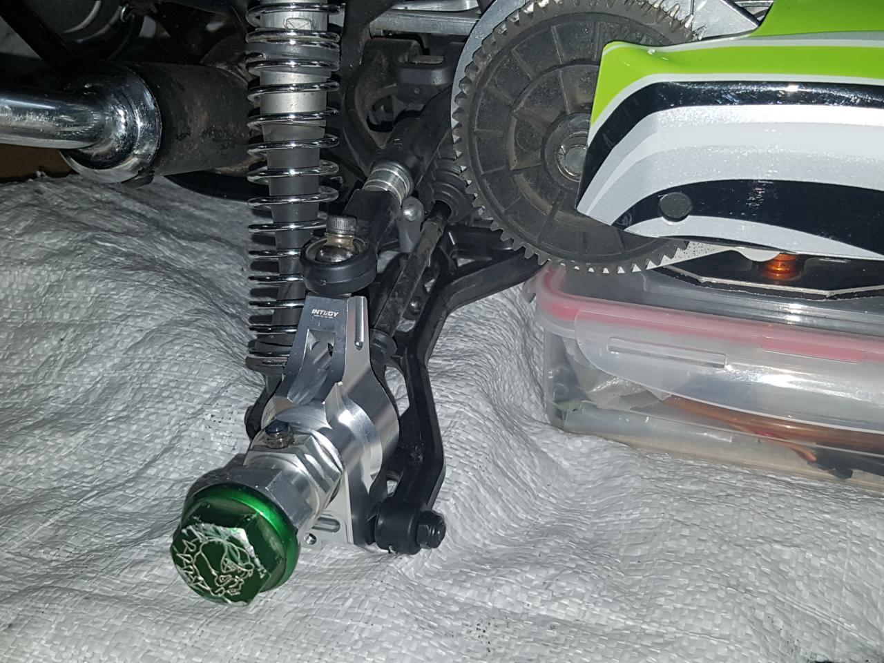

So be running fronzie rear cuffs on km new style arms on rear

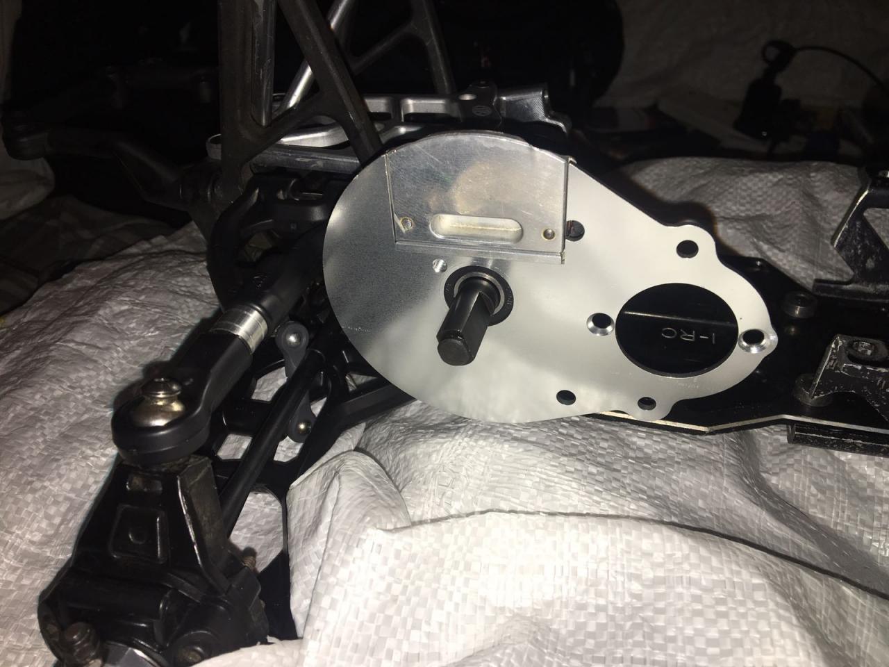

Irc chassis plate
Rpm front arms
Bolt n nut mod instead of e clips
Running Stock diff /housing
Alloy upright towers when arrives
Clipless wheel extenders( when bearings arrive)

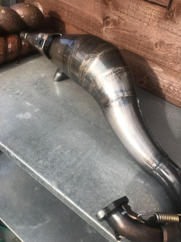

Pipe starting off with49b86ff4-01e6-47ec-abff-440dfa6de102.thumb.jpg.176032e1851565fb18fb96394ee25264.jpg

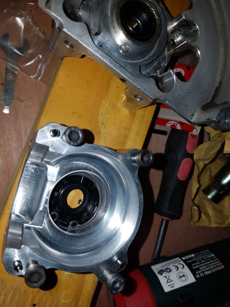

ddm g340 billet case for 36 top end.

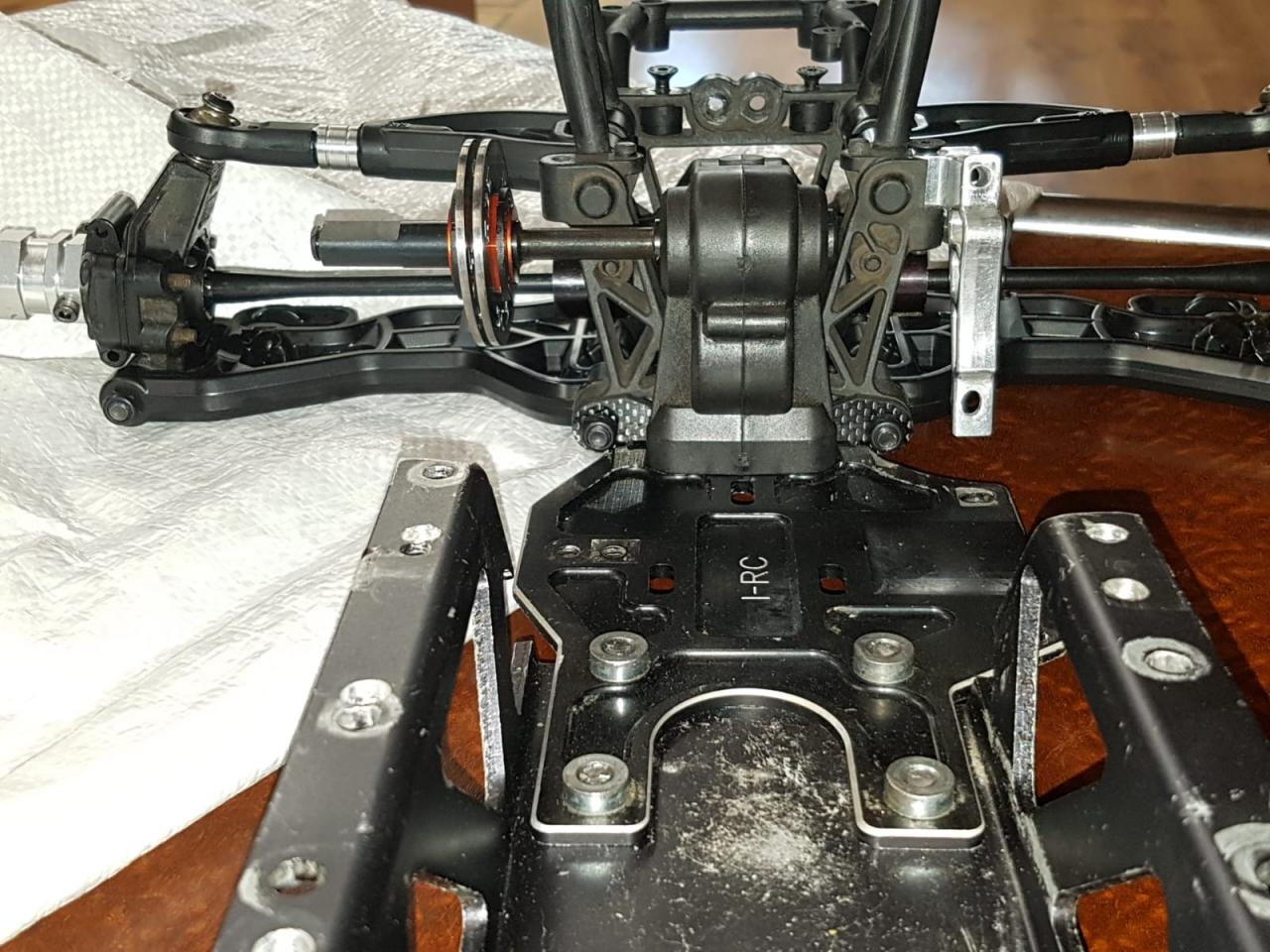

has come to light chassis not 100% on kick up @ front as steering is binding when top plate bolted down so looking like irc chassis be route but gonna get in contact with rcmz regards side pipe use on rovan stumpy if can work if yes then shall grab kit...

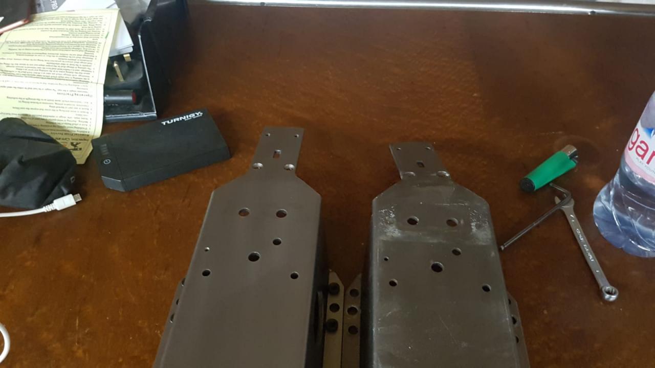

Cheers for offer but irc does a shorty chassis an life time warrenty not feeling chopping an drilling lol an like rovan stumpy too torn between the two but making a purchasing of one of them shortly..
The chassis maybe ok I need to get this part hpi 85414 or km b050 then know for sure as using t2000 insert..

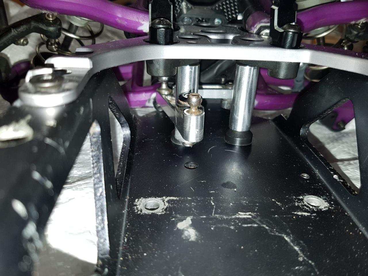

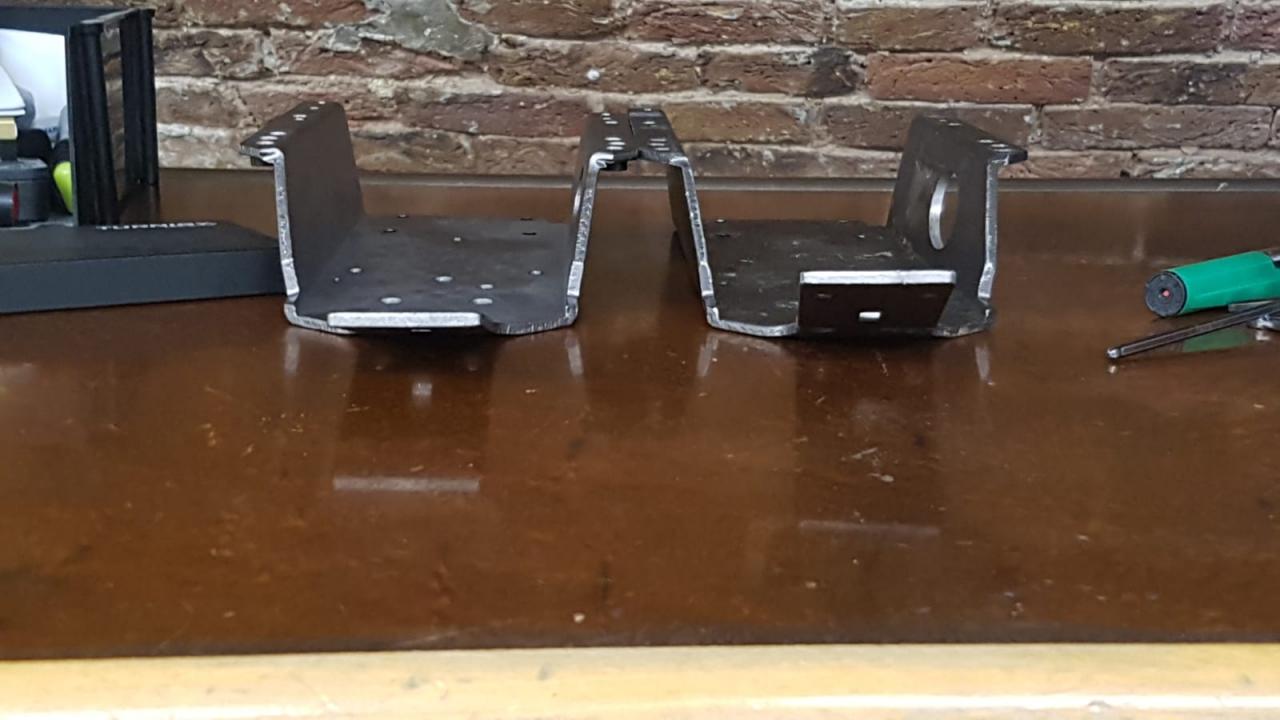

So stopped by basher buddy earlier for some steering inserts he had laying about an i could visually see that 5b a 1mm slimmer than the t2000.
Edited by R46

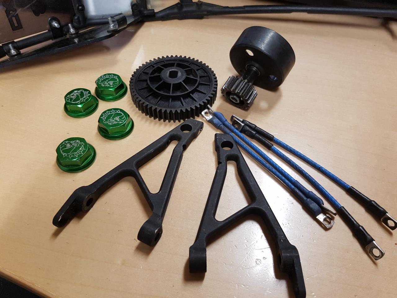

More bits arrived to aid build ^_^
Fitted anti roll bars dropped plate on, issue resolved with steering binding.
Edited by R46

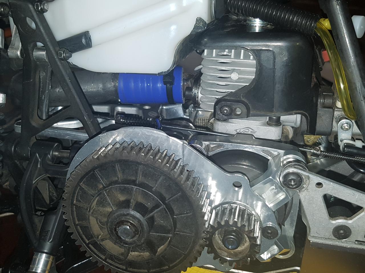

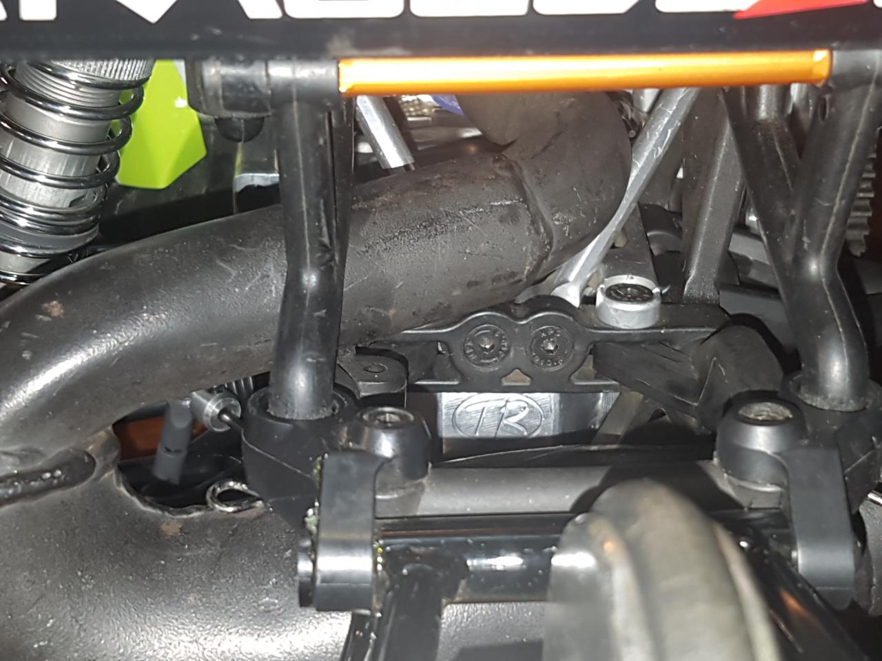

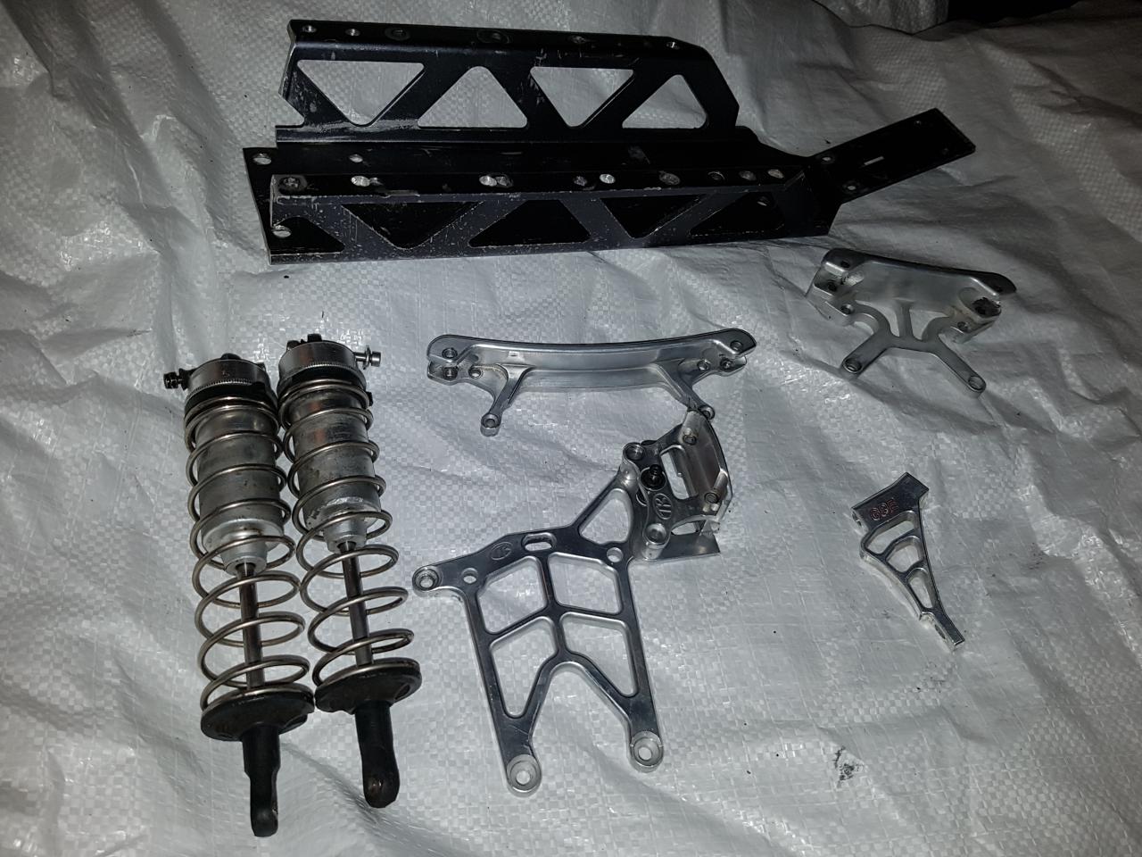

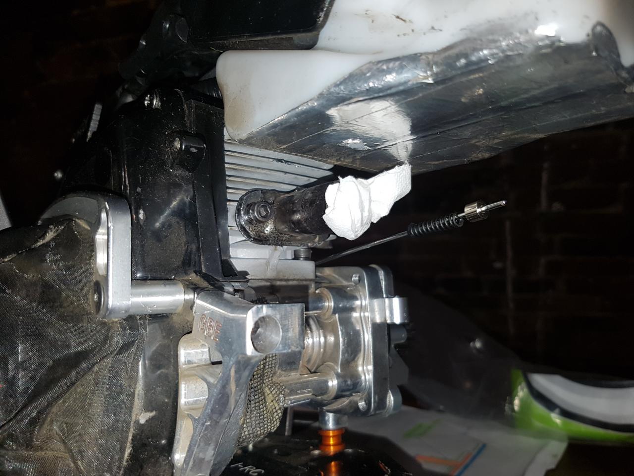

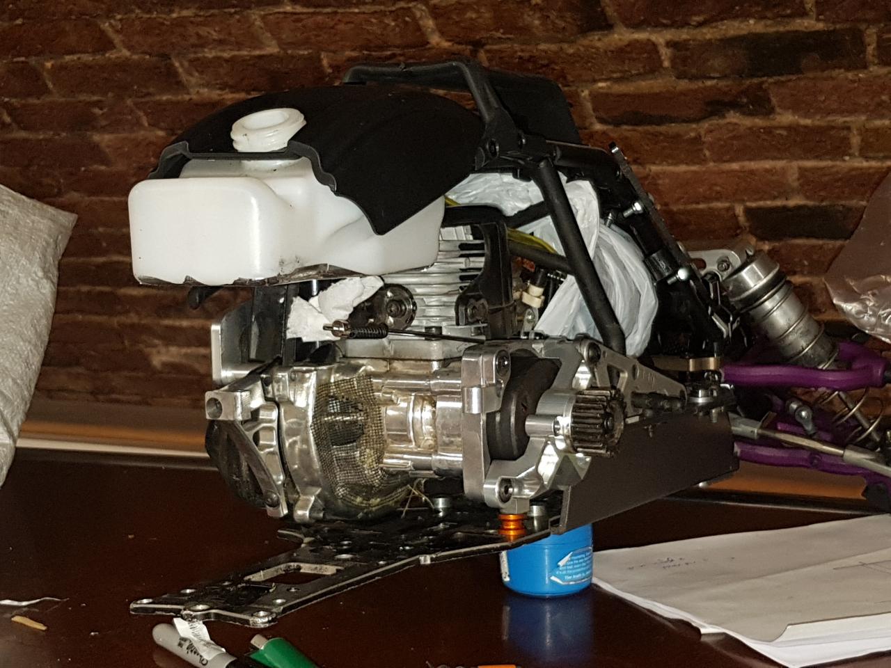

Got 3/4 complete into build gotto thottle servo mount an seemed to be a right mission with tank clearance an cage, so opted to build Q kit put aside
Baja Q
Was hoping to use bzm pipe but requires some chopping an welding to suit Q chassis not overly keen on that one..

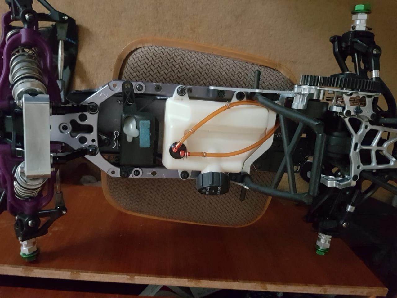

Visited mate for some random bits an got build together
Dropped topspeed 35cc had in t2000 with modded dom silenced pipe
foil taped underside of tank
forgot needed reamer to make new holes for rear wing mounts.
Shake down session did 4 tanks :thumbsup:
(new head fitted due to me using wrong length bolt on coil, snapped casting lug off head)
first tank was rich an little thottle then 2nd tank started to open up on same settings then started with tiny tweeks to needles
Now we're power lifting like my ol schumacer xtr3e :P
Few things have to do for next outting so far luv it!!
Few things to do after test session first off is rear diff relube an diff case swap.

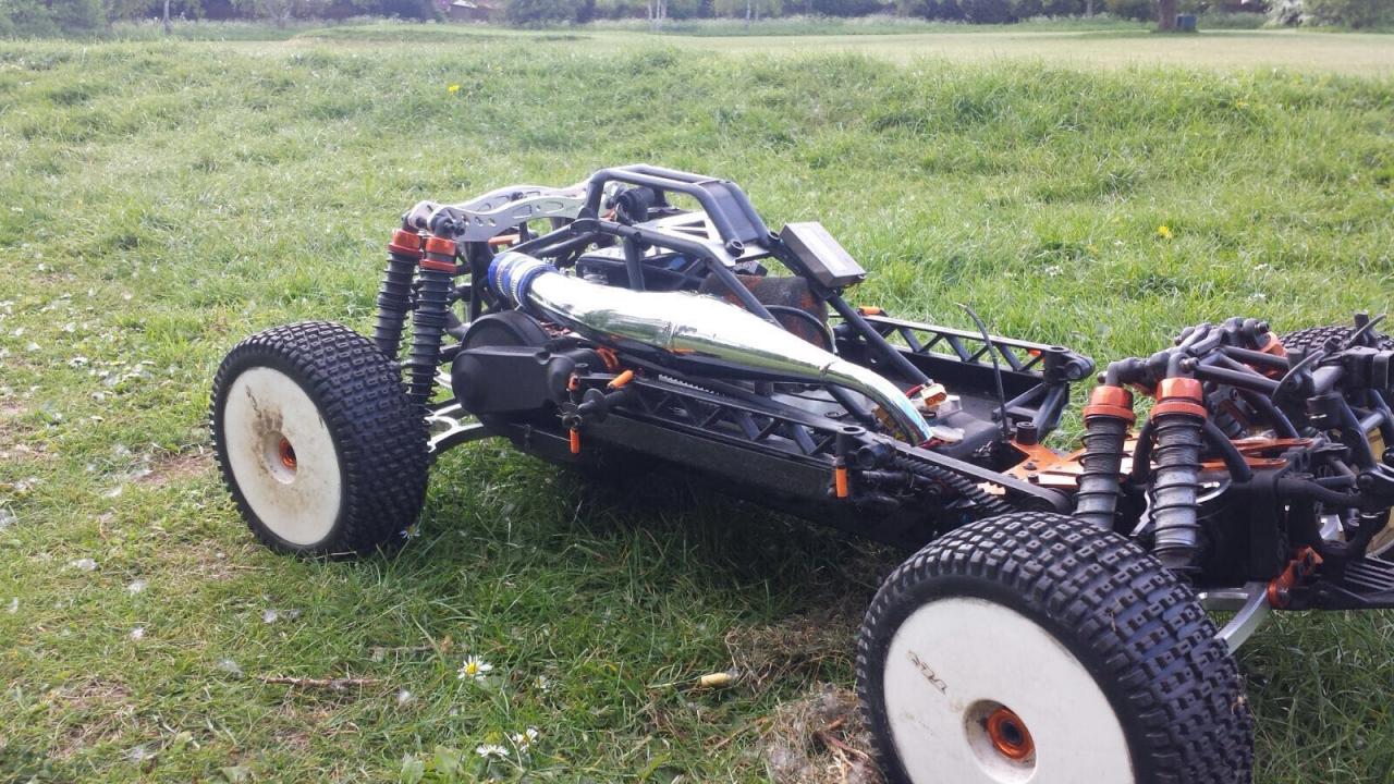

Ready for on road test
Got home an hubs arrived on they went
Edited by R46
  • 2 months later...
These short wheel base over powerd rcs are the future of fun factor lol.
Its a great build mate  i love the tank thats a first for me. Towards the end of owning my baja i wished it was a 5b. And a shorty. The baja full size of them put me off but i loved the FG size. Is the Shorty Q shorter or similar to an fg marder?

36cc top end let go so rebuild it to g320 mod
