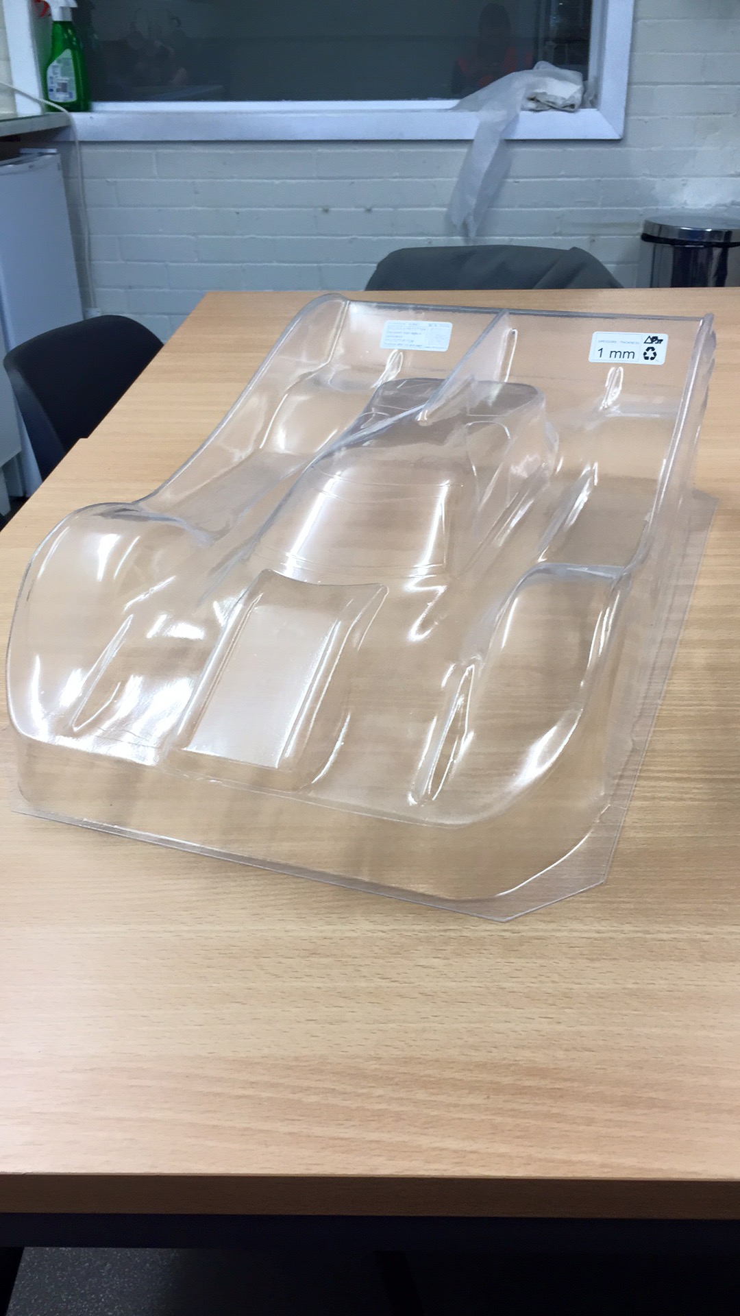

Wrighty8766 Posted January 3, 2016 Author Share Posted January 3, 2016 49 minutes ago, ajlovering said: You are going to need an on road body as well to meet the 8O8 class Cheers Already ordered just waiting for delivery from delta plastix. any idea what the usual delivery time is from Italy? Quote Link to comment Share on other sites More sharing options...
mayzie12 Posted January 3, 2016 Share Posted January 3, 2016 i was around a week or so. This time of year with random holidays all over the shop in varying countries, could be longer Quote Link to comment Share on other sites More sharing options...
Wrighty8766 Posted January 3, 2016 Author Share Posted January 3, 2016 I ordered it on Wednesday so hopefully I'll have it by the end of the week Quote Link to comment Share on other sites More sharing options...
