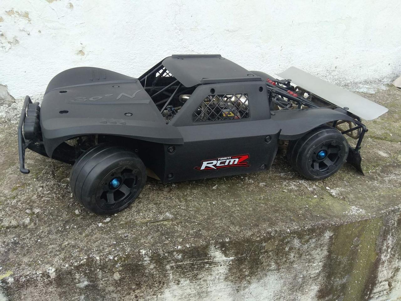

Popular Post cupra313 Posted February 7, 2018 Popular Post Share Posted February 7, 2018 (edited) Well,my beloved 30DNT arrived!Rcmodelz were amazing and the truck was here in only 8 days!Coming from a 5b and on road fg s,the size of this thing is breathtaking!!!I m gonna start the tear down tomorrow to rebuild the diffs.I'm going with 30/100/15.I ll post pics of the process in case someone needs them Edited February 7, 2018 by cupra313 9 1 Quote Link to comment Share on other sites More sharing options...

cupra313 Posted February 8, 2018 Author Share Posted February 8, 2018 1 Quote Link to comment Share on other sites More sharing options...
farmerhoggers Posted February 8, 2018 Share Posted February 8, 2018 2 hours ago, cupra313 said: Looks good what did you make them out of? Quote Link to comment Share on other sites More sharing options...
cupra313 Posted February 8, 2018 Author Share Posted February 8, 2018 thanx,they are 3d printed,material used is pla....this is a rough first prototype....I need to finalize the design and paint them the same color as the car Quote Link to comment Share on other sites More sharing options...
farmerhoggers Posted February 8, 2018 Share Posted February 8, 2018 Cool. I just got some 2mm Perspex to make some up , just got to find a bit of time to sit down and make them up. As a side note have you checked your shock boots? 2 of mine where ripped under the spring perch from new! Quote Link to comment Share on other sites More sharing options...
Scotty napalm Posted February 8, 2018 Share Posted February 8, 2018 I must say they looks the nutts Any chance of you making me some with a different design?Obviously I will cross your palm with silver ??Sent from my iPhone using Tapatalk Quote Link to comment Share on other sites More sharing options...
cupra313 Posted February 8, 2018 Author Share Posted February 8, 2018 37 minutes ago, farmerhoggers said: Cool. I just got some 2mm Perspex to make some up , just got to find a bit of time to sit down and make them up. As a side note have you checked your shock boots? 2 of mine where ripped under the spring perch from new! You can get the lettering or whatever design you want with laser cutting or hydro cutting in perspex Just checked the boots,they are fine on mine.... 30 minutes ago, Scotty napalm said: I must say they looks the nutts Any chance of you making me some with a different design? Obviously I will cross your palm with silver ?? Sent from my iPhone using Tapatalk Yeah sure,shoot me a pm...I dont get the "cross my palm" thingy though Quote Link to comment Share on other sites More sharing options...

cupra313 Posted February 13, 2018 Author Share Posted February 13, 2018 Need stainless for the spoiler and daytime lightning for better photos 3 Quote Link to comment Share on other sites More sharing options...
