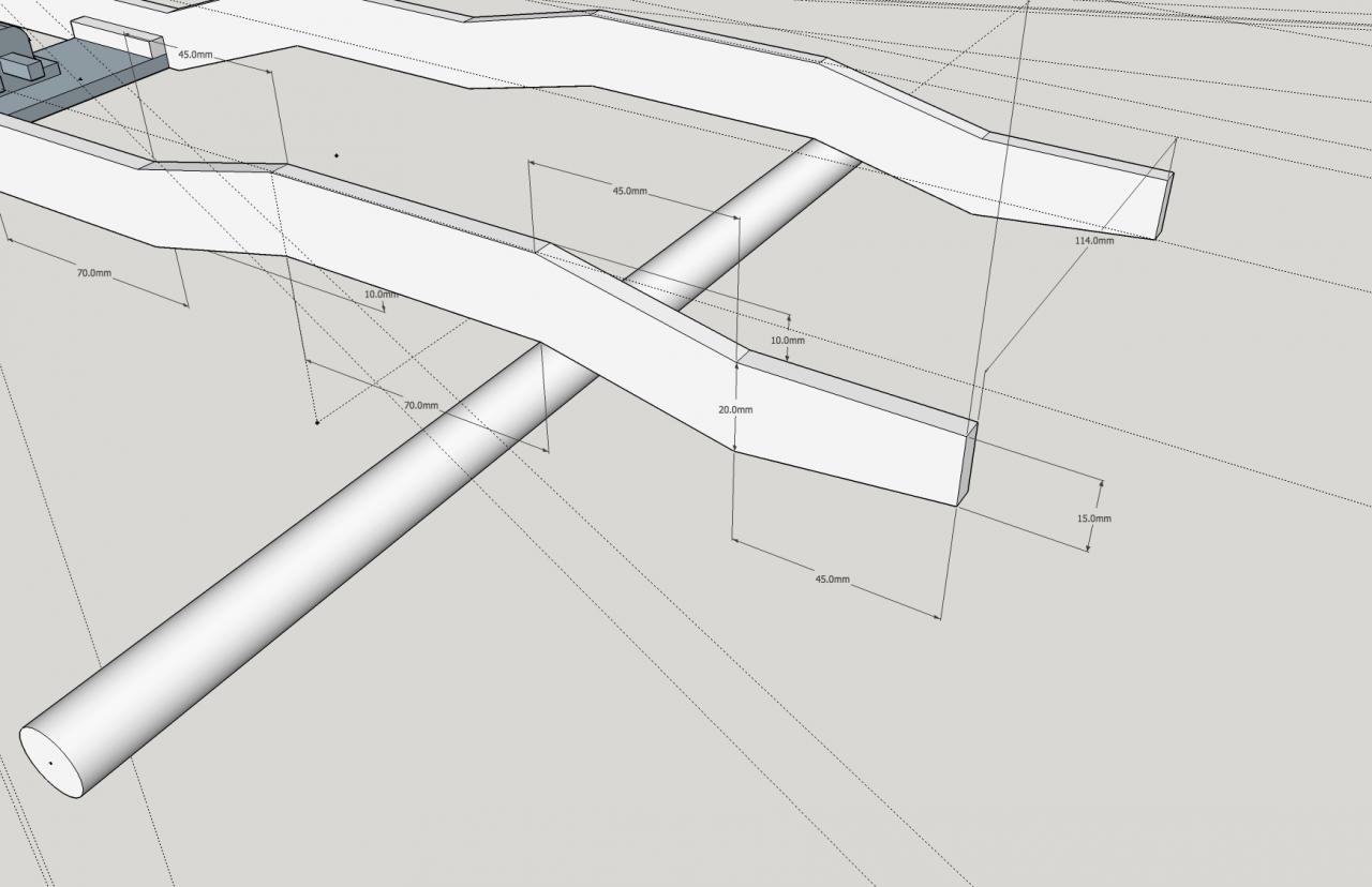

luckland Posted January 10, 2018 Share Posted January 10, 2018 Hey, it turned out the inside between the chassis rails is 114mm width, meaning 124mm outside. I chose this width for the size of the axles. You have to make sure where your axles have shocks and link mounts. I used this blueprint when I designed the chassis. It might be helpful for you too. 2 Quote Link to comment Share on other sites More sharing options...
Fly In My Soup Posted January 10, 2018 Author Share Posted January 10, 2018 Thanks dude, your a legend! Trust the Japanese to be so technical!!! My axles are wraith width so I should be sweet , now I know the chassis width! Quote Link to comment Share on other sites More sharing options...
