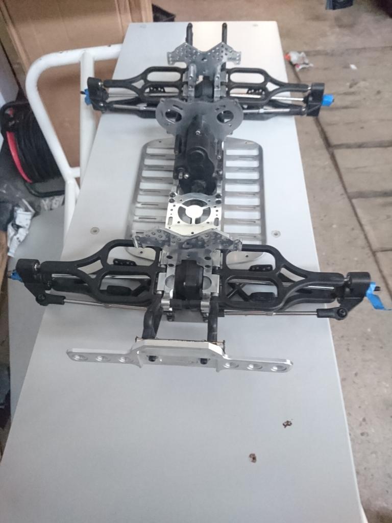

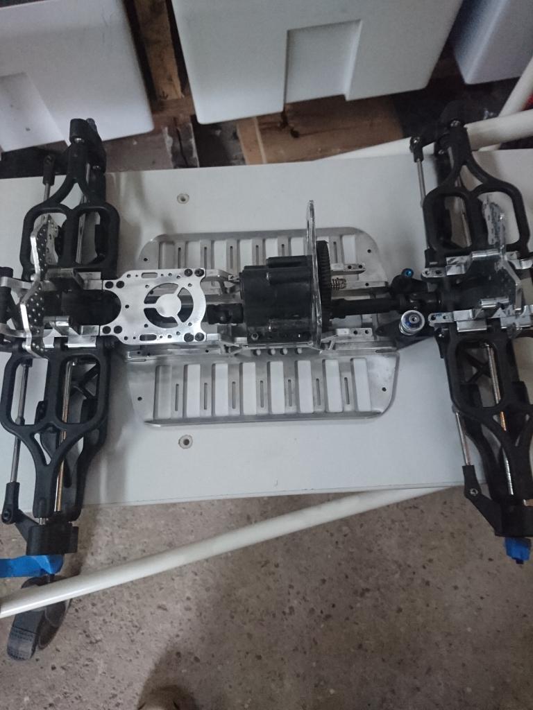

danny boy Posted December 22, 2017 Author Share Posted December 22, 2017 (edited) On 12/19/2017 at 18:36, evssv said: any more progress on this dude Yes a little, progress slowed as a part repair was needed. but all is now sorted! One of the four front suspension arm mounts had some damage. It's a solid machined part, and when I tightened it up the thread snapped clean off. Luckily it's a fairly beefy part, so I was able to lathe out and tap a new thread to insert a piece of threaded bar into the stub. Now it's tinted black again I think it will go unnoticed. Once that was sorted I started work on the back plates, only one back on the car for now until the rest is cleaned up Also rear arms ready to go back on Another thing I noticed when working on this car. This thing is looooooong. Definitely longer than my hyper 7, maybe a little narrower though. Edited December 22, 2017 by danny boy Quote Link to comment Share on other sites More sharing options...

danny boy Posted December 23, 2017 Author Share Posted December 23, 2017 Starting to feel a little more like a car again every day. 1 Quote Link to comment Share on other sites More sharing options...
