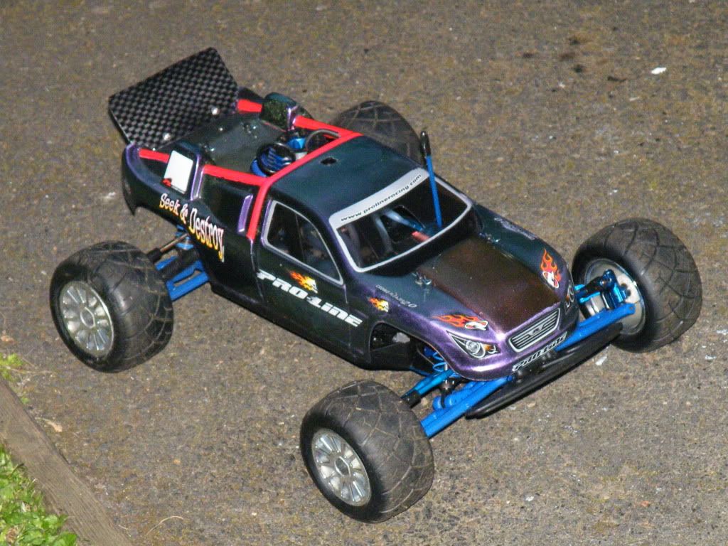

a-x-l-e Posted October 13, 2009 Share Posted October 13, 2009 Of the two I have had the most success with nitro fuel. I posted this in another similar thread, this is a shell I have painted and stripped a few times.... Overall and putting aside my lack of painting skills its not too bad. I stripped a stock CRT.5 body a few weeks back and the factory paint came away very easily. I soaked kitchen roll in nitro so it was fairly wet and pressed it onto the shell for a few mins, light rubbing took the paint off and left a nice almost crystal clear shell. Quote Link to comment Share on other sites More sharing options...
