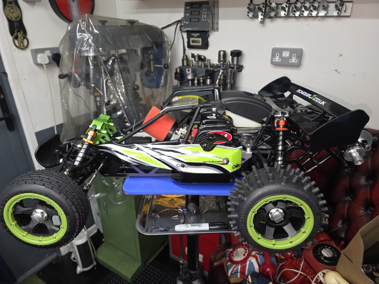

I have a couple of Rovans , a baja q shorty and a 5b converted to truck spec, however they are not standard.
I run single ring rovan 36 in both of them and they fly.
Support from Rcmodelz is great for them.

You can buy a high speed gearing set with a 19t pinion instead of 17t standard and main gear to suit.
Fit remote engine cut out .
Front chassis brace is a wise idea.
Then the sky is the limit.
I like the single ring 36 engine and better pipe in them , but then I modify all my cars as it is kind of my thing.

I would go with the 36cc single ring engine and high speed gearing over a 2 speed. not heard good reports about them other than the blackbone one sold by Taylor racing .
They will be overkill in a shorty I think, I would go for the 2 wheel wheely bar by the way , as mine used to end up upside down allot with the single wheel.
