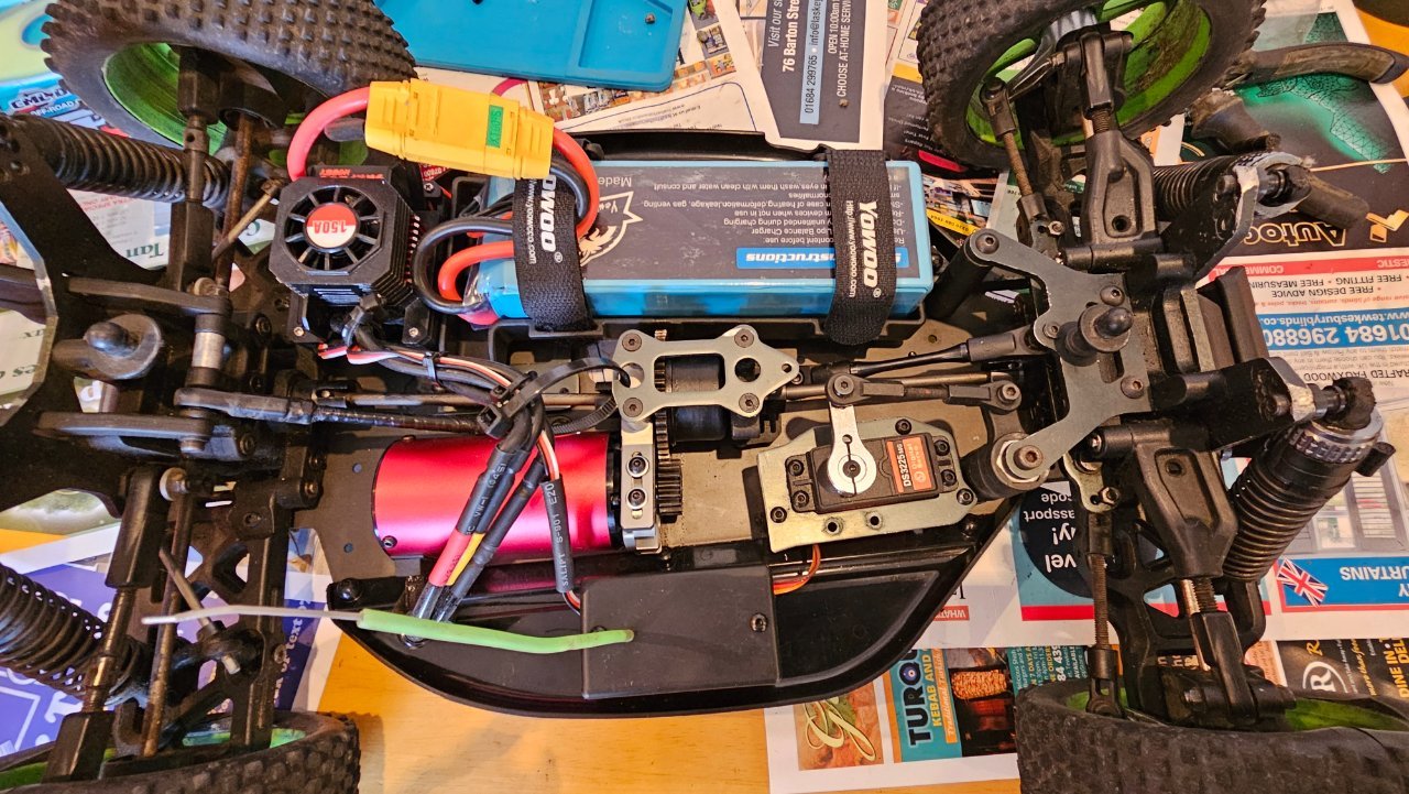

AlistairG Posted Tuesday at 21:33 Share Posted Tuesday at 21:33 (edited) Hi all. Be kind. I'm new I've dug my 15 year old Hyper 7 out of the loft and am converting it to electric from nitro. I've been learning a lot, but didn't notice the wiring was like this before buying the kit. The nut and bold strip is done and the rebuild is underway, I've bought the 150A surpass hobby ESC and motor. but I don't know why there's are 2x Deans T battery input connectors into the ESC. Is it to connect 2 batteries if required? What do I do if only connecting only 1x 4S pack. Do I need a loop connector? Edited Tuesday at 21:36 by AlistairG Miss spelling Quote Link to comment Share on other sites More sharing options...

AlistairG Posted Tuesday at 22:17 Author Share Posted Tuesday at 22:17 Thanks guys! So chop out the black loop cable that joins the red and black? And chop off both deans? And replace with a single XT90 that will give me a joint single battery connection from the source red and black? Quote Link to comment Share on other sites More sharing options...
Stormbringer Posted Tuesday at 22:22 Share Posted Tuesday at 22:22 I would replace both deans with XT90 connectors and get an xt90 loop cable like this https://www.modelsport.co.uk/product/etronix-female-xt90-bridging-adaptor-with-10g-wire-loop-lead-425612 as you may in the future want to run 2x2s batteries instead Quote Link to comment Share on other sites More sharing options...
