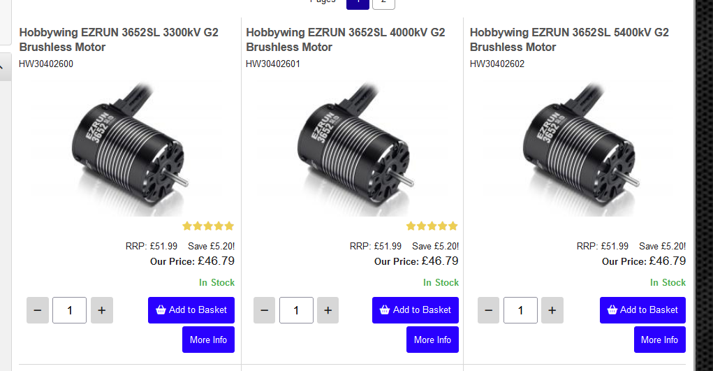

lorrylemming Posted September 12, 2022 Share Posted September 12, 2022 I haven't got a 4.5t sorry, I was speaking hypothetically. I would use one of these depending on exactly what car you're going to put it in. Etronix also offer some slightly cheaper motors that would also work. Quote Link to comment Share on other sites More sharing options...
